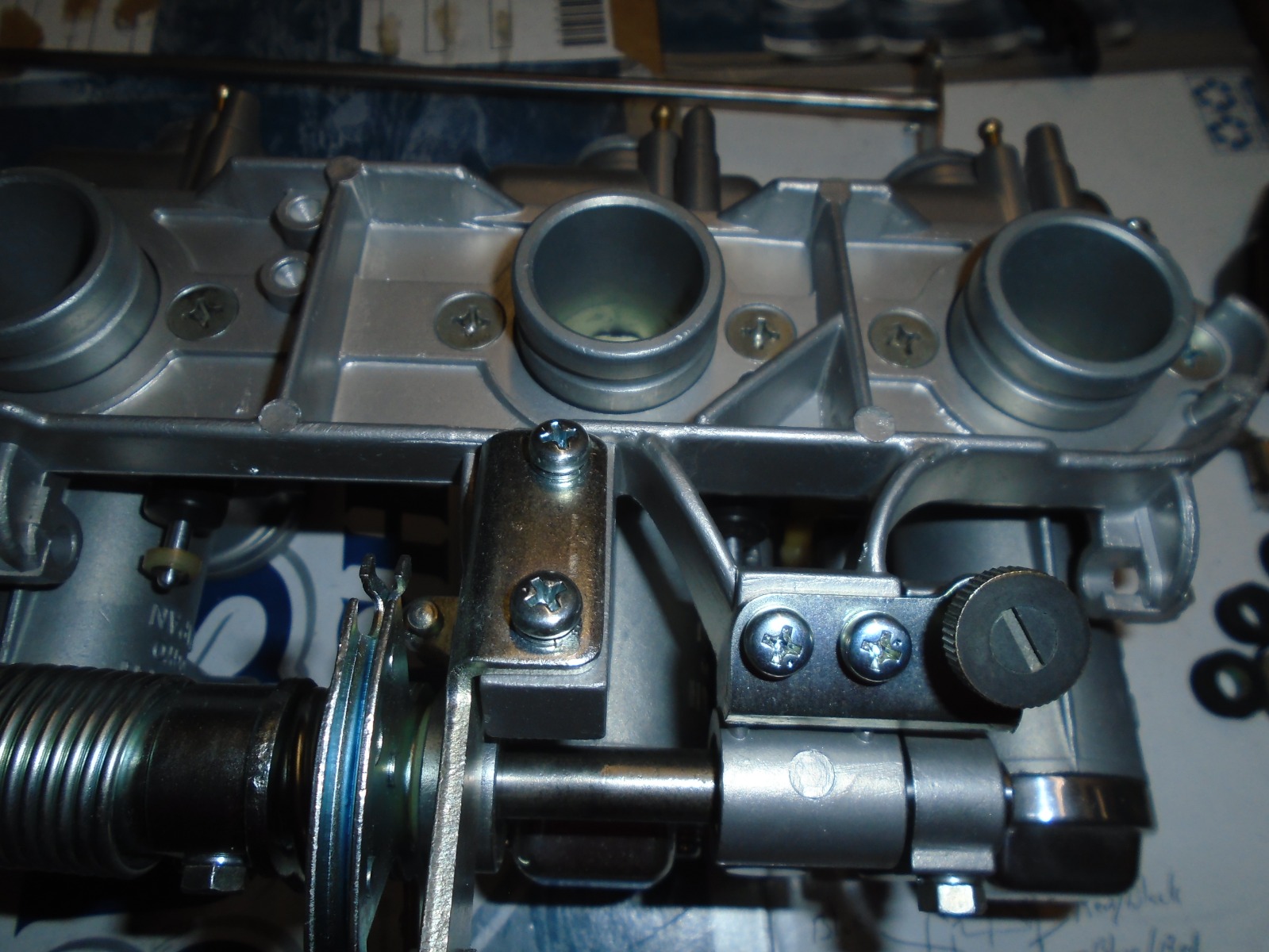

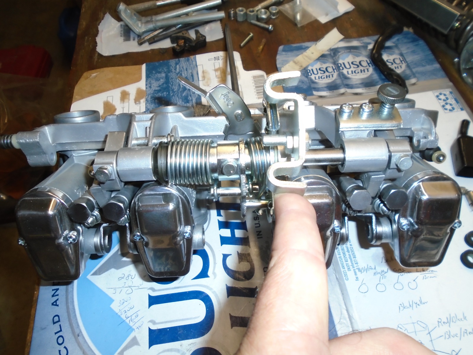

Does anyone have literature from a FSM on a Domestic Z2 750 1973? Looking for original stock pilot jet size for these Mikuni VM26SC's. They are at first glance appearance wise identical to the 28SC's used on the Z1 900 but venturi bore is smaller. These are the "Big 17mm Nut" bowl style. Thanks in advance, Clay

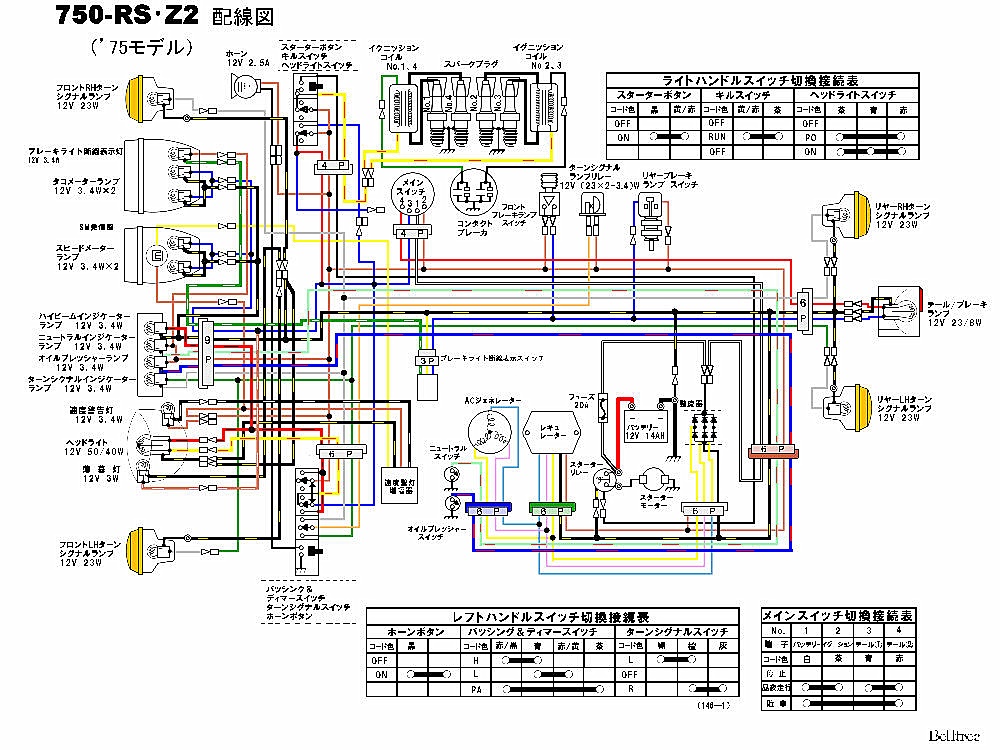

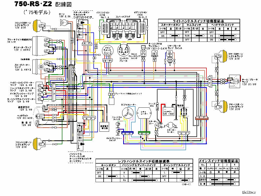

That's plum Awesome Zed!! Thank-you Very Much!! They came to me with 32.5's, original style/taller but have never seen ones that large in these style carbs. These are the 2021's. You wouldn't happen to have a source for a wiring schematic would You? Someone chopped-up the main wiring harness and deleted wiring to the Hazard/over speed light bracket on the handlebar mounts. Again..Thanks a Bunch!!

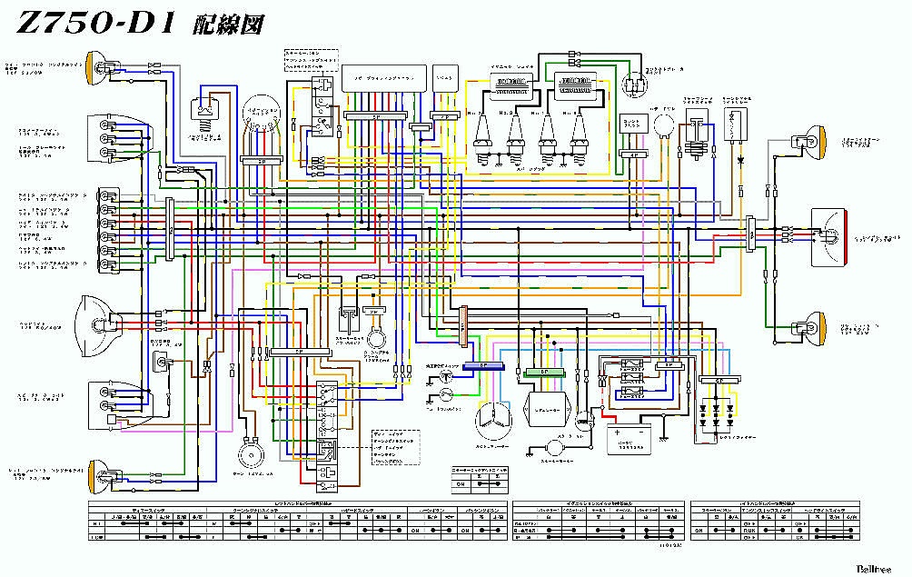

  • gd4now
  • gd4now's Avatar
  • Denco where did you go?
  • Posts: 1696
  • Thanks: 692
Re: Kawasaki 1973 Z2 750 RS Carb Pilot Jet Size
25 Jul 2024 07:13
#902533
Not sure just how much help these will be but here is what I have for wiring diagrams for the Z2
1977 KZ650 B1
Pods and Denco header
OLD KAW OWNERS SMILE ALOT
The following user(s) said Thank You: asphalt900, Scirocco

  • asphalt900
  • asphalt900's Avatar Topic Author
  • Posts: 1780
  • Thanks: 1218
08 Aug 2024 01:15
#902876
A BIG Thank-You to zed1015 for the supplied required, hard to find, at least for me, carb specifications! And BTW they have P-4 slide needle jets and 2.0ca slides for reference. Came out as expected, everything else pedestrian SC Mikuni.
