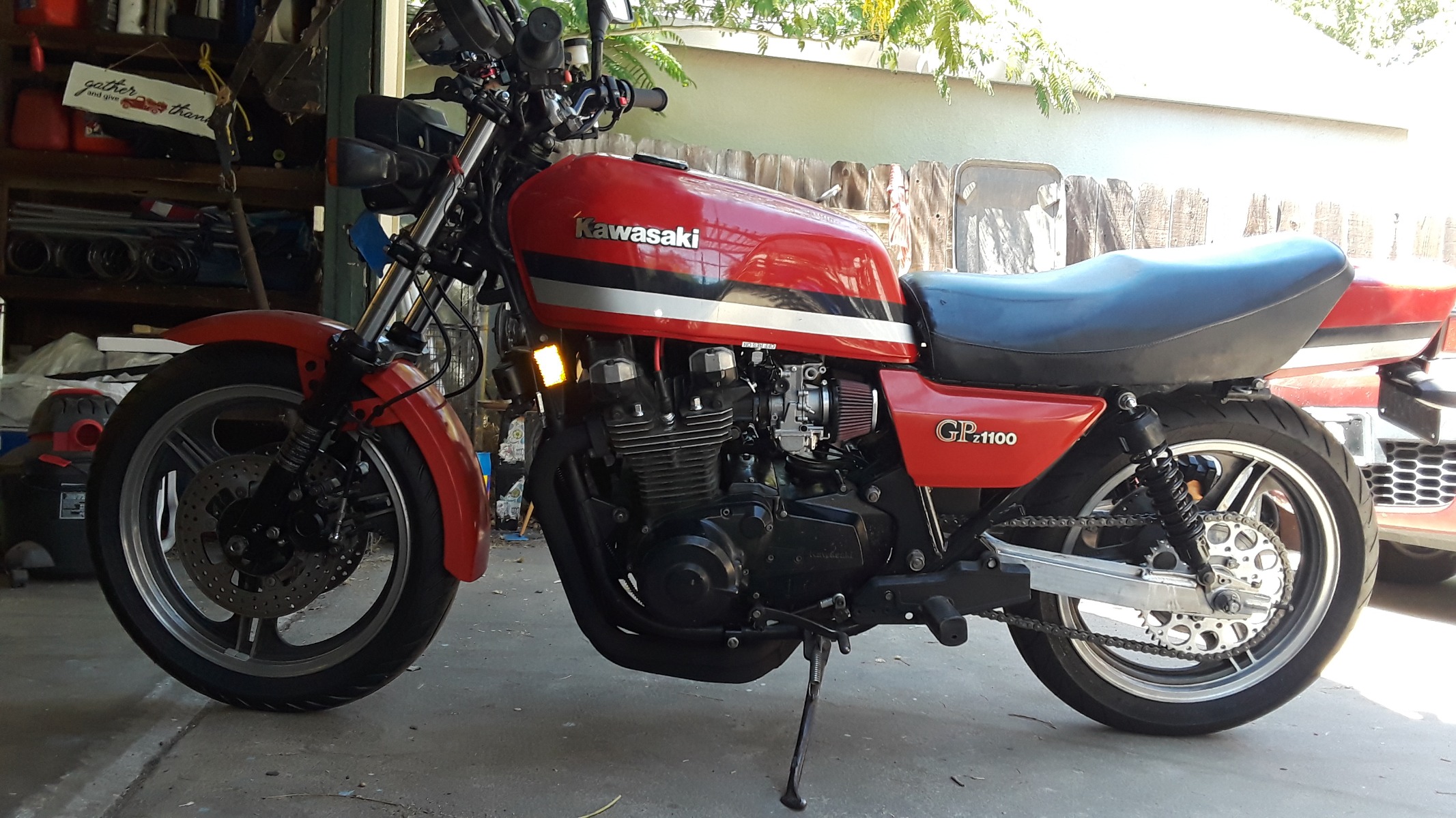

I too, am a fan of the Pingel petcocks. My bike has a dual feed and Mrs' slayer has a single feed on hers. The only drawback is they're not "intuitive". After many years of riding with a "standard" valve, you get accustomed to the hand movement going to the reserve position. The Pingel moves horizontally, not vertically. I put a small sticker on mine to remind me...
Look close... you can see it right above the valve
