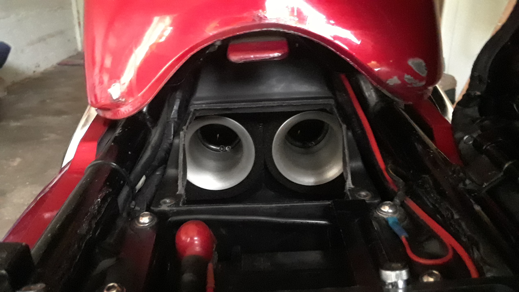

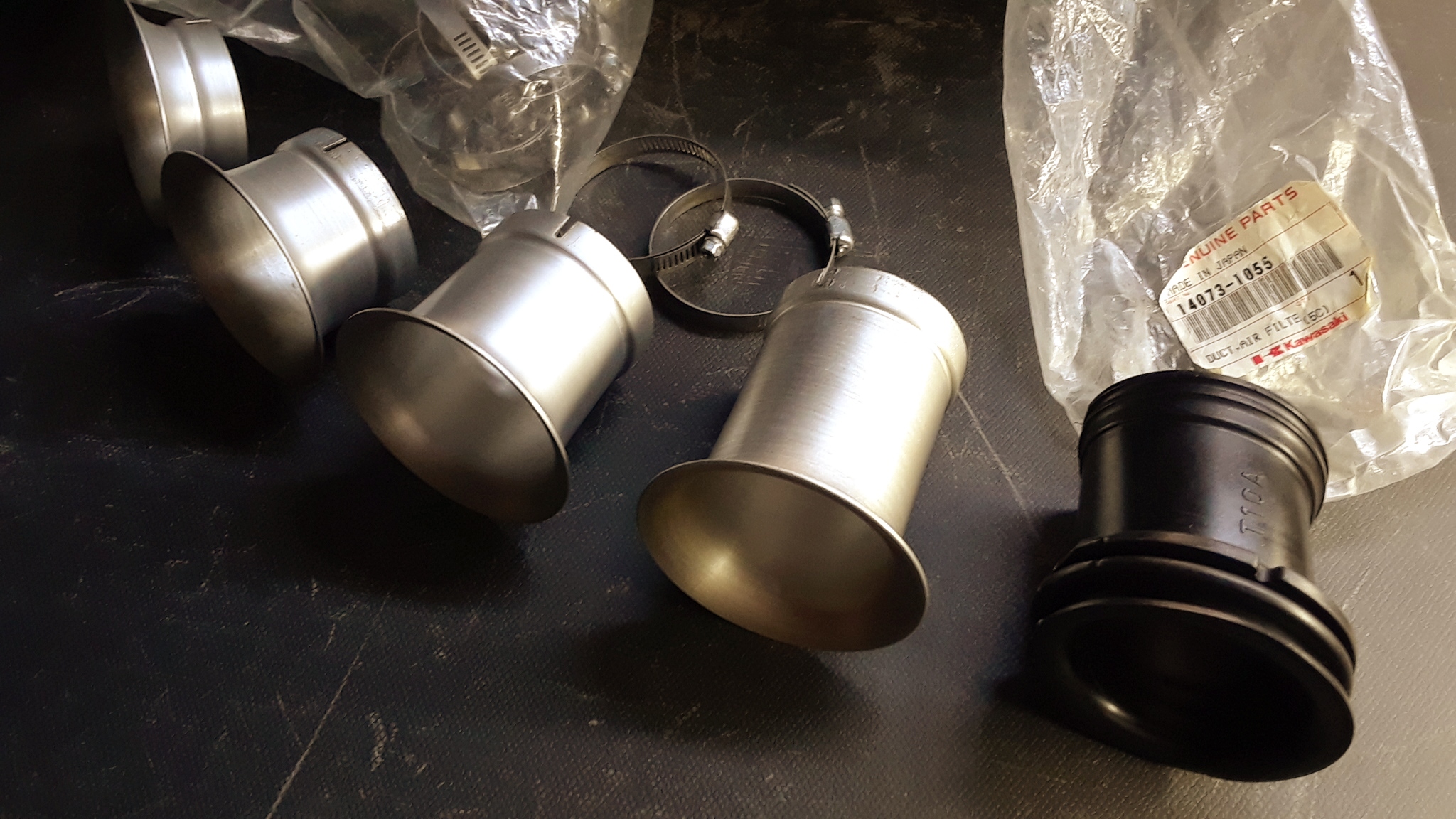

How long were your velocity stacks?
- daveo
- Posts: 3160
- Thanks: 894
Re: Pods/Air Box
12 Jul 2024 14:50
My favorite and longest is about 3-1/8" overall. It's length is approximately 3/8" more than the stock rubber air box boot used with BS34 carbs, which just happen to be 3/8" (10mm) longer than RS series carbs.

Re: Pods/Air Box
12 Jul 2024 20:03 - 12 Jul 2024 20:23
Well, that didn't last long...
Smokey-stinky fumes came out from the air box around the pods and inflow opening under the seat.The engine ran hot and noisy, though it did seem to be more powerful.
One short half-hour ride was all it took for me to put her back in stacks...
Whew!
Whew!
