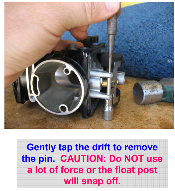

Thanks for that. My float "ear" snapped of as I was trying to push the pin out. It's a clean break, and it looks like JB Weld will fix it. But the varnish was so thick in there! And the smell almost made me hurl.

This rebuild tutorial has a method that will (help) prevent broken float posts...
gsarchive.bwringer.com/mtsac/~cliff/stor...Rebuild_Tutorial.pdf

Great read! And I especially like that you posted the exact same problem that I created at the end of your message. Nicely done.
