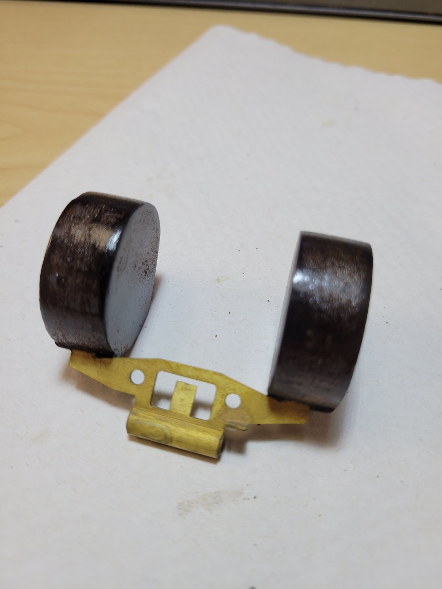

The floats in these carbs have a shinny coating on them. Thought it was varnish, but acetone and carb spray won't touch it. Scrapping with a fingernail can damage the coating, but it's not easy. Anyone see this before?

01 Jul 2024 12:51No! Never seen that on a stock float.Thread drift...
Definately on the right track with the varnish idea.
Looks like a PO's fix for porous floats.
Maybe something like a 2 part resin such as Araldite or similar .
- Posts: 8232
- Thanks: 3613
Re: VM26 Set Up Recommendations
01 Jul 2024 13:05
Thanks for the info. I'm thinking...replace the floats. I have spares.
