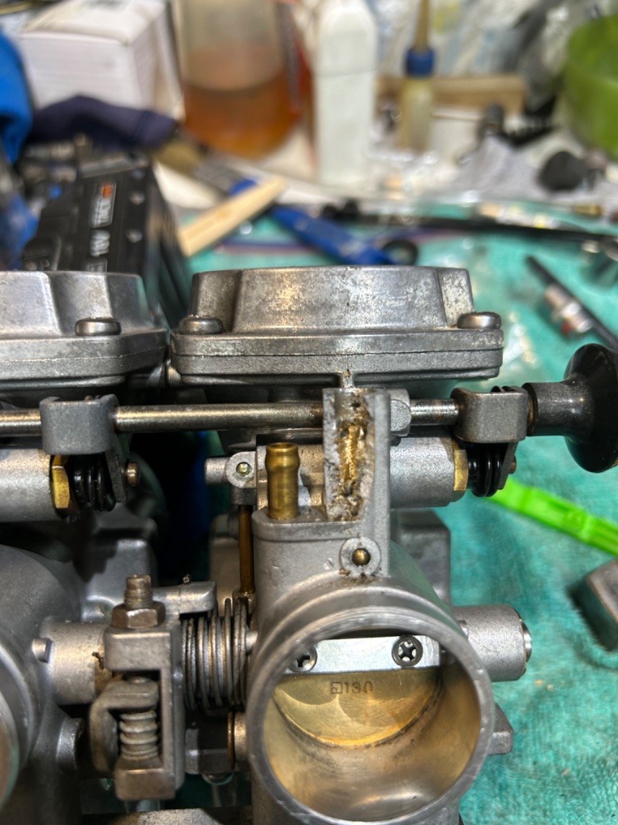

, where I am rebuilding a completely destroyed 1981 kz1000LTD. The latest misery, has been carbs. When everything was ready to go, I noticed one of the mixture needles was sheared. As I tried to take it off, I managed to destroy my carbs in the process.

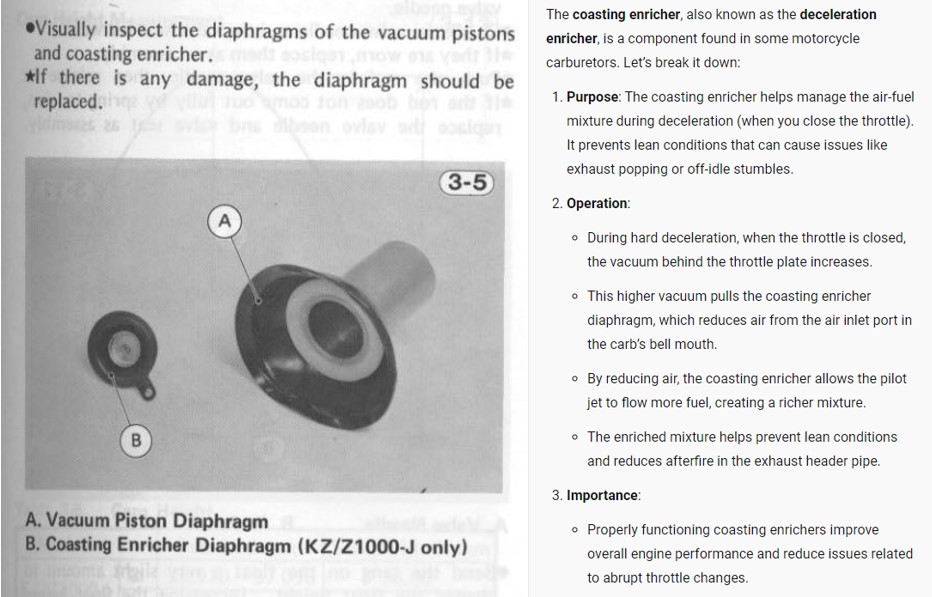

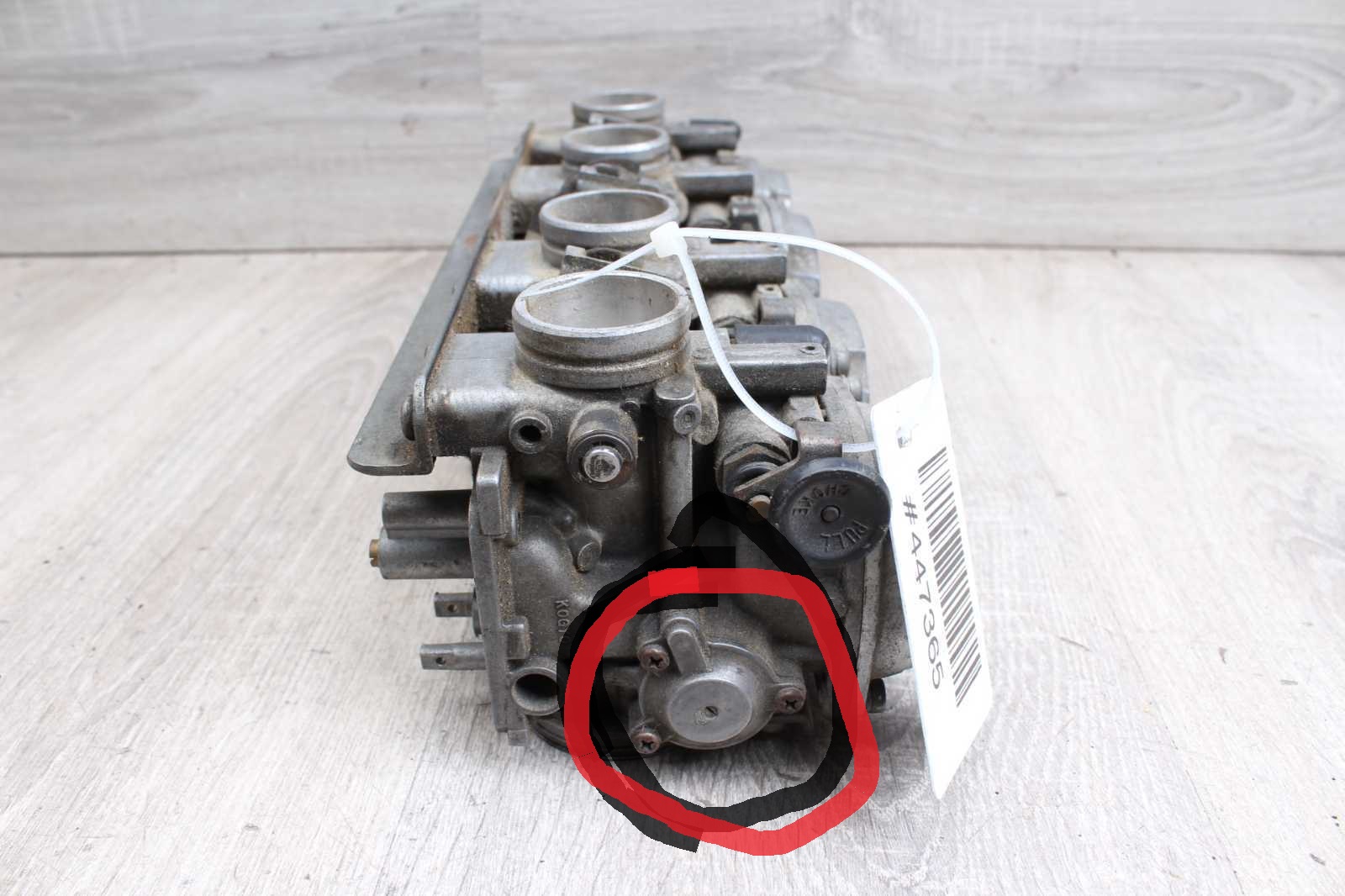

I am looking for a set of carbs. I need a sound carb structure, even incomplete, as I have my set of carbs to take parts from. I will post now in the "wanted" section, but if someone reads this, please contact me at cartal at gmail DOT com.I have located a set, please see pictures, but I notice a difference. My carbs don´t have this "triangle" part. Any ideas? Will it fit? Thank you in advance!

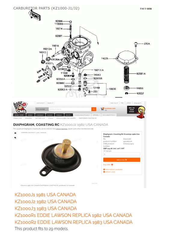

Hi Carlos, I believe these are "enrichment valves" (kind of like a basic accelerator pump) fitted to the "J" and "R1/R2 ELR" I don't see any reason these wouldn't work for you

Sorry to see that broken casting! But unfortunately a seemingly common issue with these BS34's. Persons pull off the plug and environmental conditions prevail leading to corrosion in casting threads. The ones you've been eye-balling will. like Wookie mentioned, work just fine. I like them, have used them on several rebuilds over the years. I like the "air-cut" feature on each carb casting unique to these, kinda stifles the afterfire. But..beware..because each carb has one of those diaphragms and they can be pin-holed. From memory they are about 80.00USD ea OEM. And like any used bank of carbs, those shown may have their fuel screws stuck too? Just never know and few vendors these days will waste the time to check for you before the sale. I see you are outside the US. I have a set of each style but shipping these days can be a hinderance.
