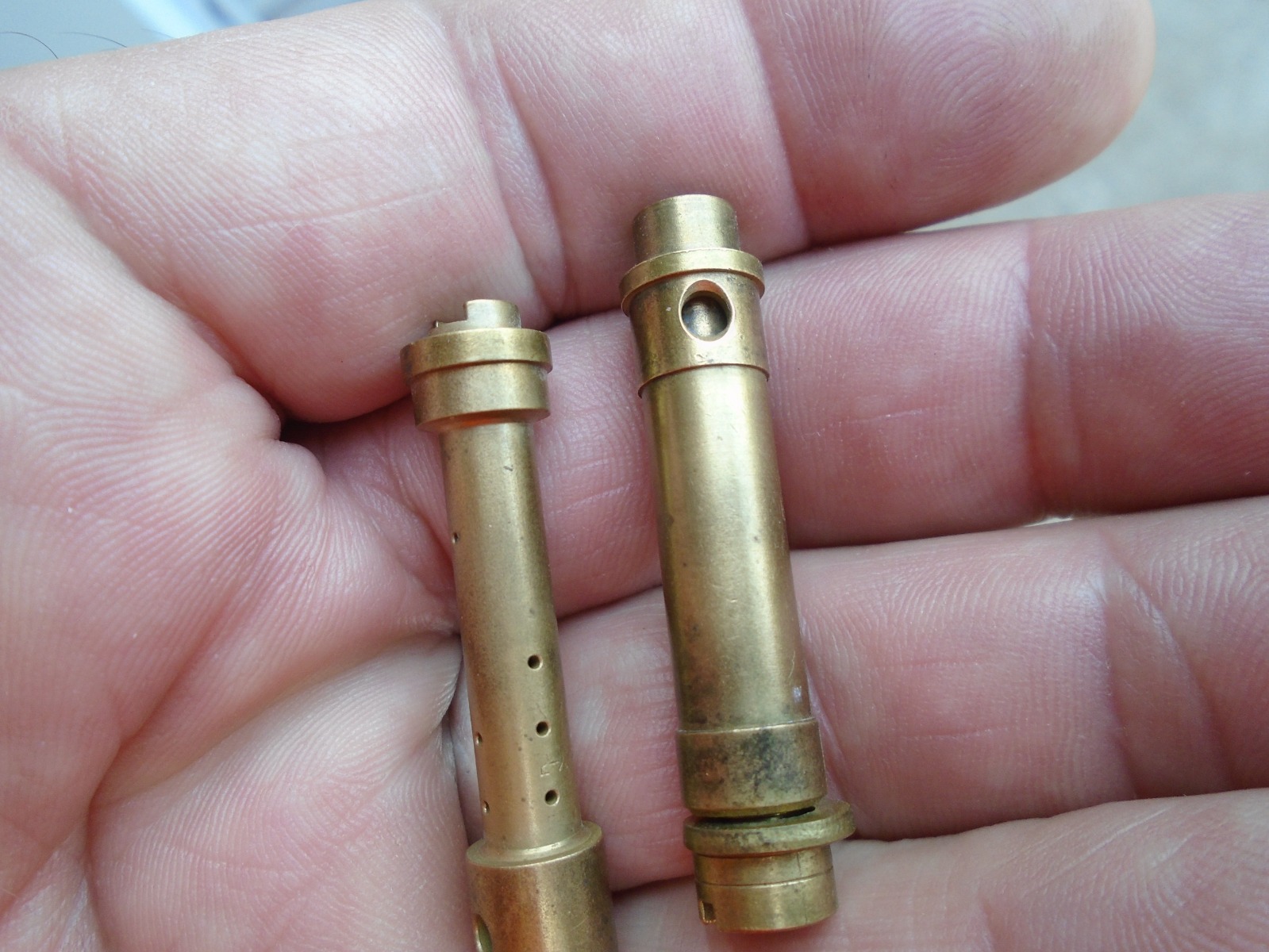

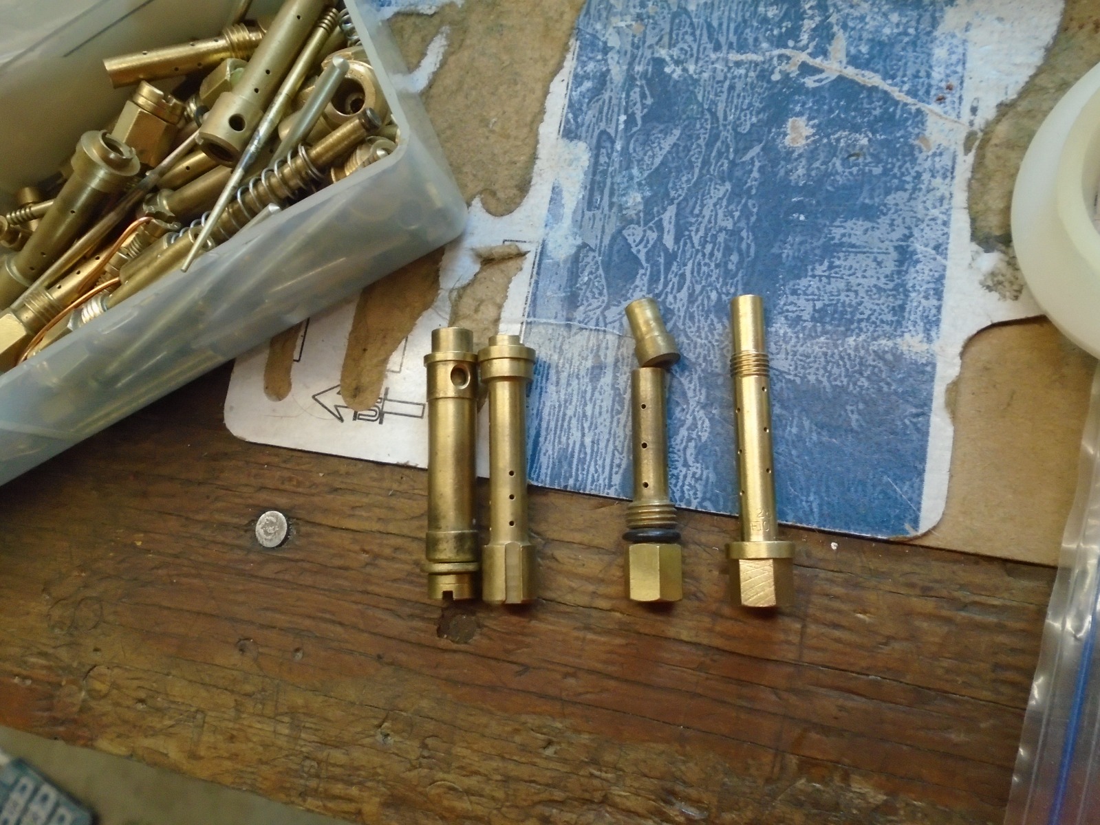

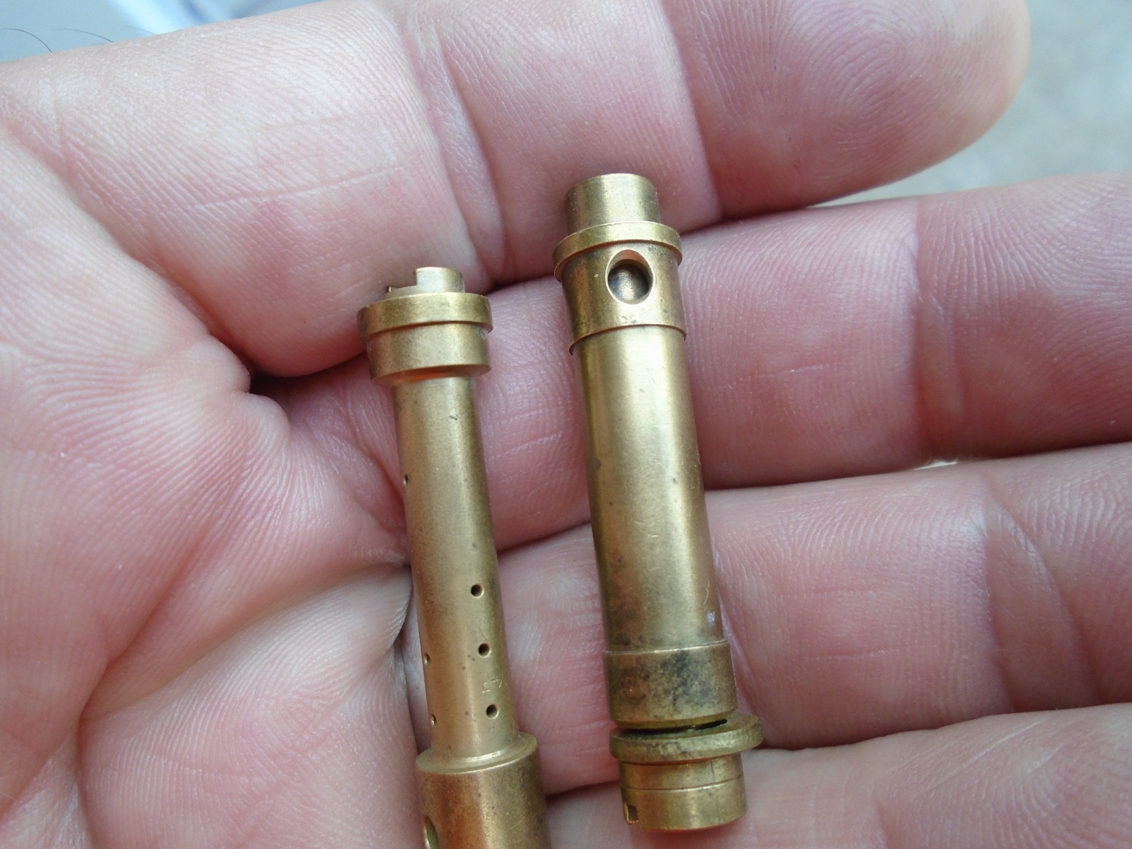

Some more crap to boggle the mind. Don't know how the 30's were set-up as received?? But not these were also used on two-strokes, completely different dynamics! Do You have a Primary or bleed type jet holder or a primary style?? You might have a 159 series or 176 series? Slide cut generally is out of box 2.5. Generally the "choke", not to be confused with the enrichment system starting plunger. Is that protrusion from the jet holder/emulsion tube in the venturi. If it sits proud looking down the throat then it's most likely a Primary style and suited for two-stroke application. Look at the photos, first two. Last pic is of various immediate grabbable crap i had laying around, there are many many more.
