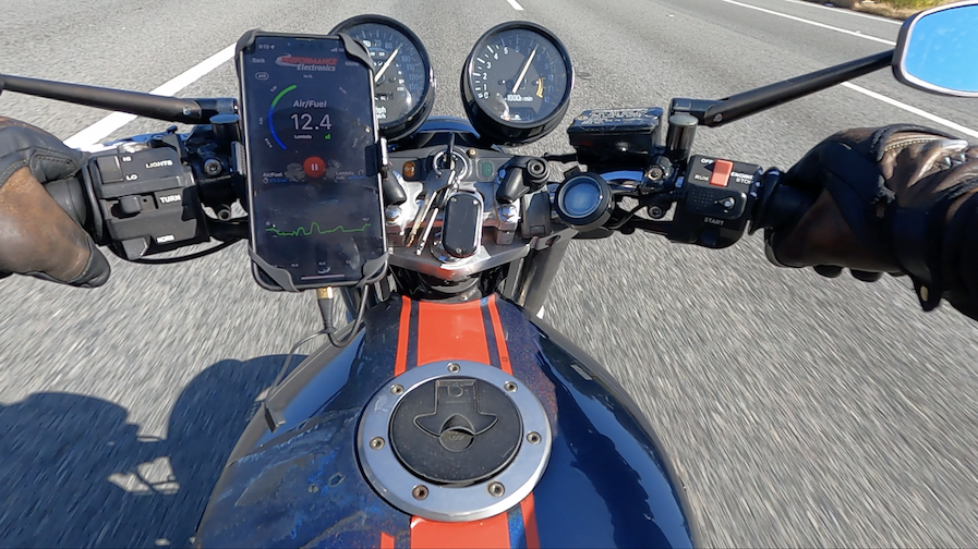

So I ended up buying a wideband O2 sensor kit. I went with
one that displays on my phone
(thanks for the suggestion ThatGPZGuy). I just took the bike out for a test ride. Absolutely love this setup and the O2 sensor is clearly going to be very helpful with tuning. I marked the different throttle positions with white paint and took a video of the ride so I could see both the O2 gauge and the throttle position in real time. It's a very easy/nice way to analyze. This is the setup:
This is my current jetting (other details about the bike in my signature):

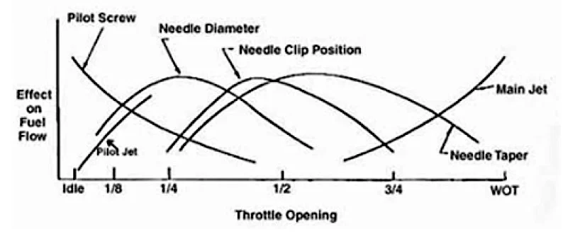

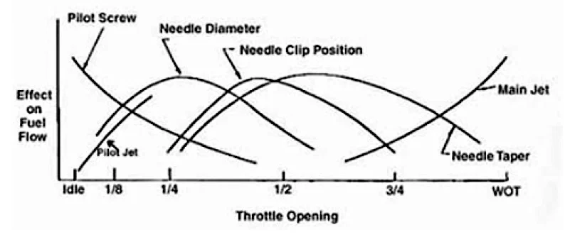

I'm basing these proposed changes on diagrams like this (though they all seem to vary a bit):
What do you all think? It's sooooooo nice having data to help decide which settings to try!!!

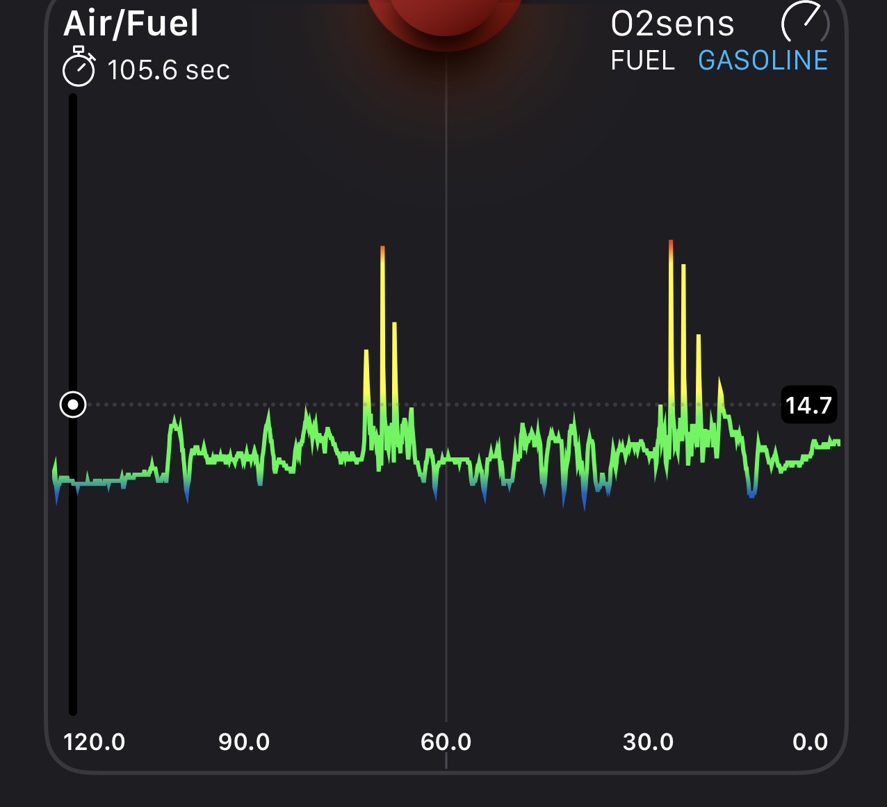

One thing I noticed is that I'm getting a pretty severe lean spike when I go full WOT from a stand-still. Here's a graph of the AFR during a couple such take-offs:
My float heights are set on the lean side (19mm, spec is 17mm +/- 2mm). I'm wondering if that might be the issue and if the carbs just aren't getting the fuel they need to support off-the-line blasts. Does that make sense? Seems the jets and needles are spot on judging by the static AFR numbers.

Just a thought, it could be that you get a fuel level drop in the carb bowl due to the centrifugal forces under hard acceleration.

That looks about as "spot on" as you can hope for with carbs, excellent work. IMHO what you are encountering is the limitation of carbs over EFI, when you snap open the throttle it takes a few milliseconds for the "intake air speed" to catch up and draw enough fuel (this is why some carbs have an "accelerator pump" to plug the gap as the air speed picks up) If it was me I would "stick a fork in it" and call it done
The following user(s) said Thank You: Zaddict

16 Jun 2024 20:05That looks about as "spot on" as you can hope for with carbs, excellent work. IMHO what you are encountering is the limitation of carbs over EFI, when you snap open the throttle it takes a few milliseconds for the "intake air speed" to catch up and draw enough fuel (this is why some carbs have an "accelerator pump" to plug the gap as the air speed picks up) If it was me I would "stick a fork in it" and call it done
oh wow, I'll bet you're right. I've heard of accelerator pumps but never knew what they were for. I haven't noticed any hesitation or stumbling so I think I'll just stick a fork in it as advised
