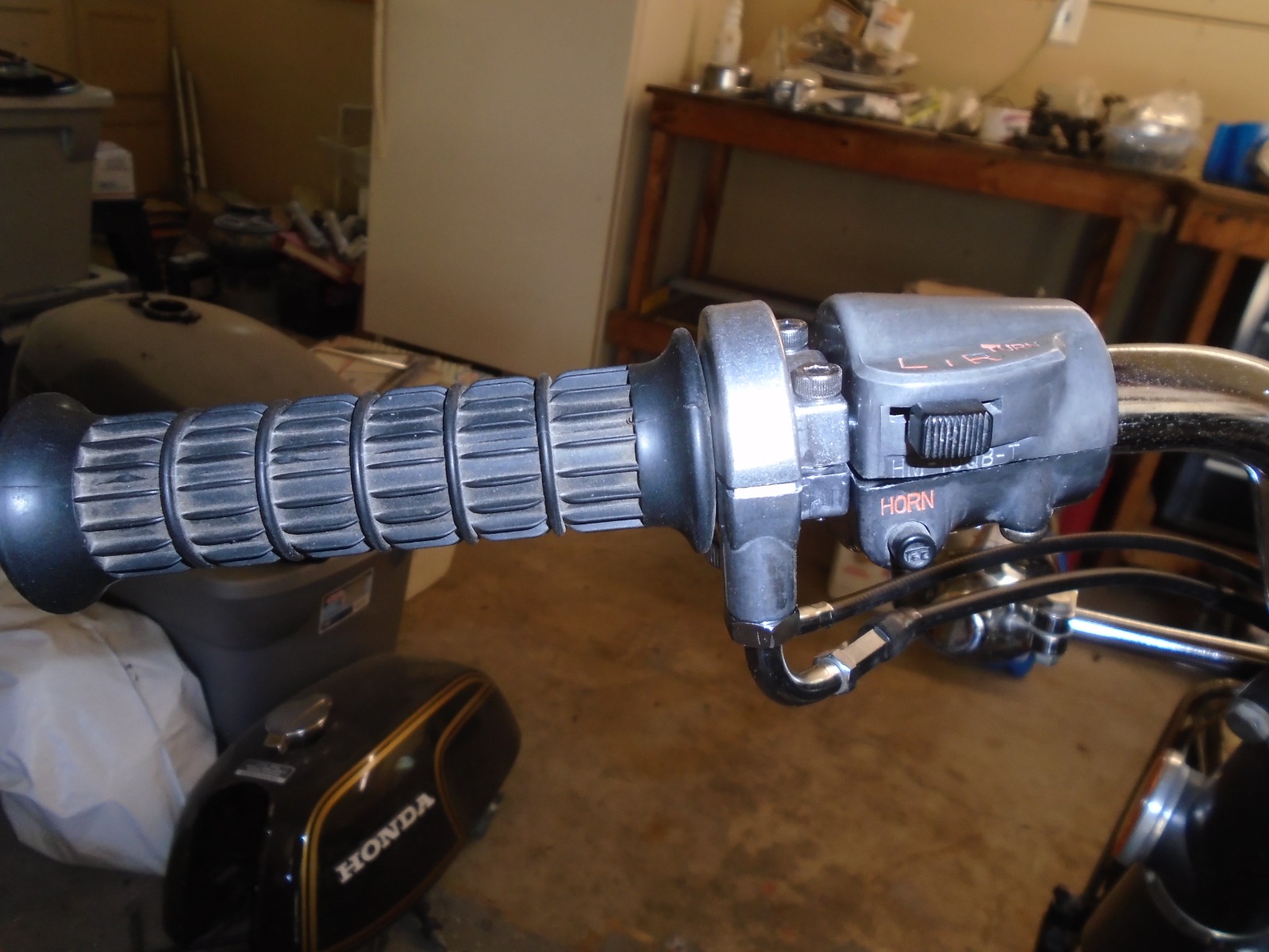

Has anyone ever converted the RH to LH throttle and control. Have a Friend with just a Left arm and wanting to change over controls. YES, i know it sound interesting. Trying a KZswitchblock switched to the LH side but...any ideas??

Thanks for the insight fellas!! Don't really want to complicate issues with "foot control" anything. He's been modifying bikes for years to serve his need to ride. Yes Vin, this switchblock does utilize the push/pull setup and they are omnidirectional so i can easily reverse the cable pull. He's familiar with a twist-up to increase speed and has been modifying his collection for years this way. I can mill thru the 180deg out of what we are used to and facilitate the turn signal function again, also the start. He'd brought me a "china" Magura look-alike but these carbs have a pretty stiff return spring, that's why i wanted to add that extra buffer of security uncase something goofy happened. Also the reason for using a quick-kill on that knob top. His singular forearm is about the size of my thigh, ha. And he's a true farmer, changes midsized tractor tires by HIMSELF!!

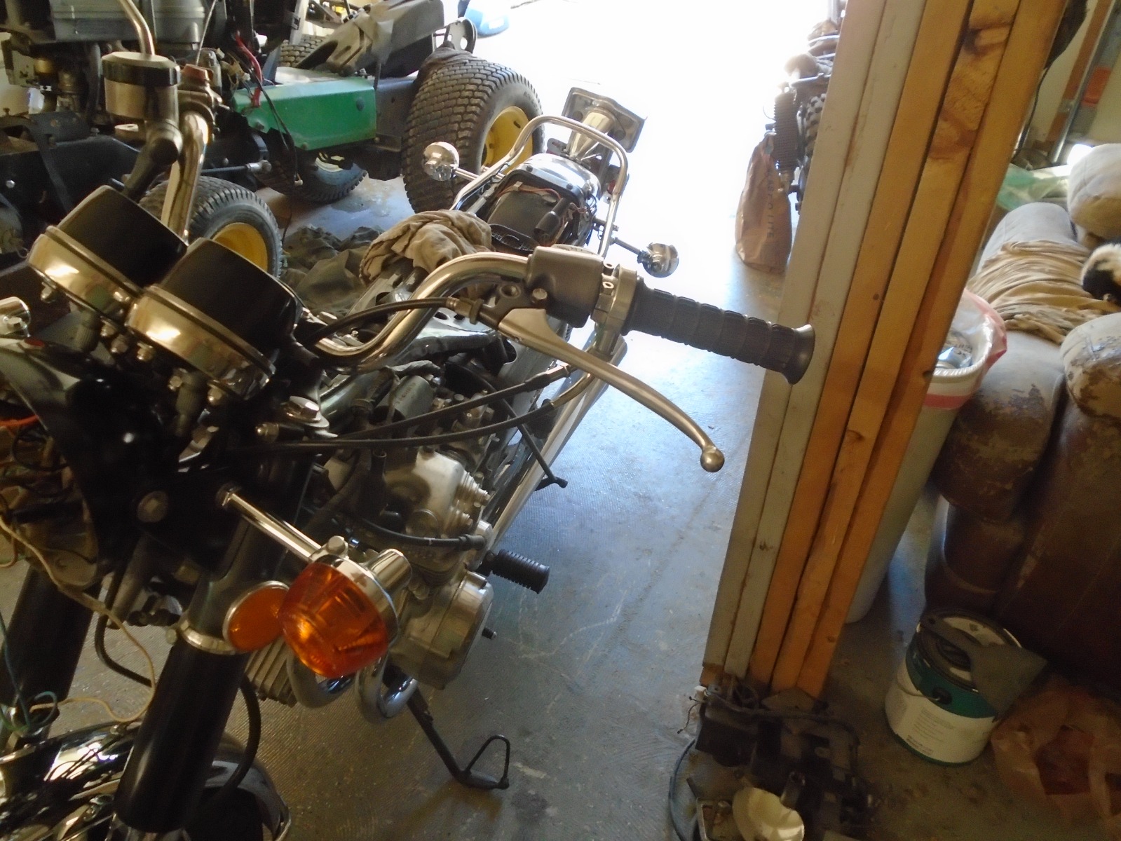

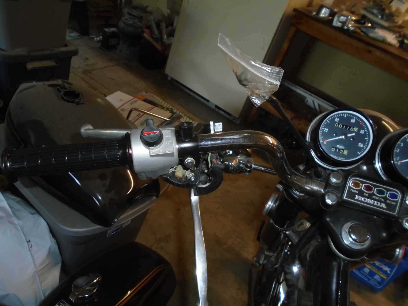

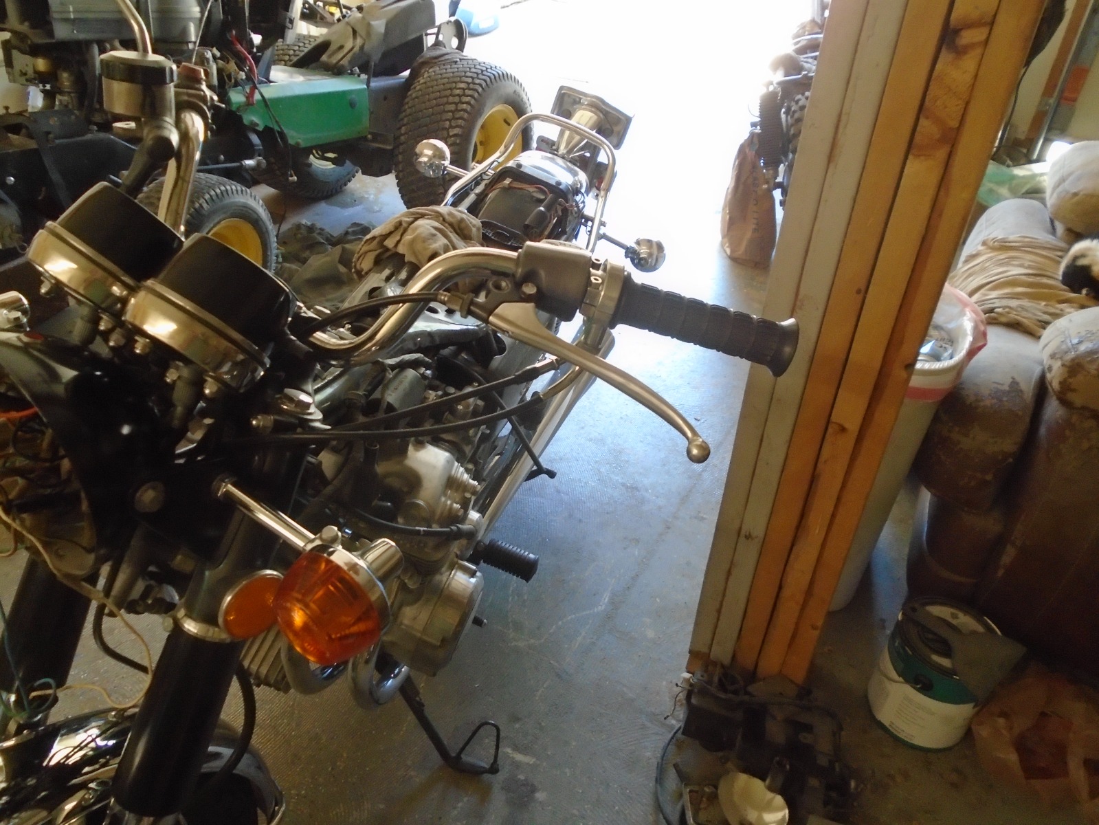

Perhaps Goofy but i believe I've come to a solution. Verified by my buddy for function. Utilizes the original push/pull cables for safety. Horn button is now the electric start button. Clutch lever has a smidge shorter available total length because of the extra housing but not a big deal. This dude has massive hands, ha.
