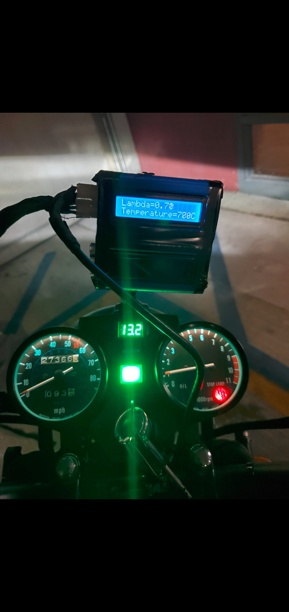

Yeah, I just use mine when testing. I had the Innovate LM-2, but mine had a habit of shutting down then restarting. It was a pain.
I went to www.14point7.com and got his SLC FREE 2. I ended up getting 2 of those units.
I wouldn't run mine all of the time as the O2 sensors stick out to the side asking to get broken off.
For $120 each with sensor, it's a pretty good deal. Note: he's located in Canada.
All of SLC FREE 2 build is open sourced. You can build one if you wish.
I stacked mine and put a tripod bushing in the back to be able to mount it to a gopro arm.
www.bhphotovideo.com/c/product/101501-RE...er_Screw_3_8_16.html
There is only one sensor plugged in.
