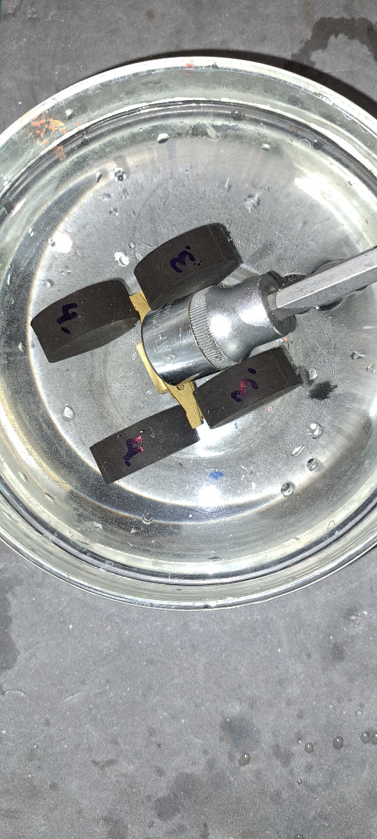

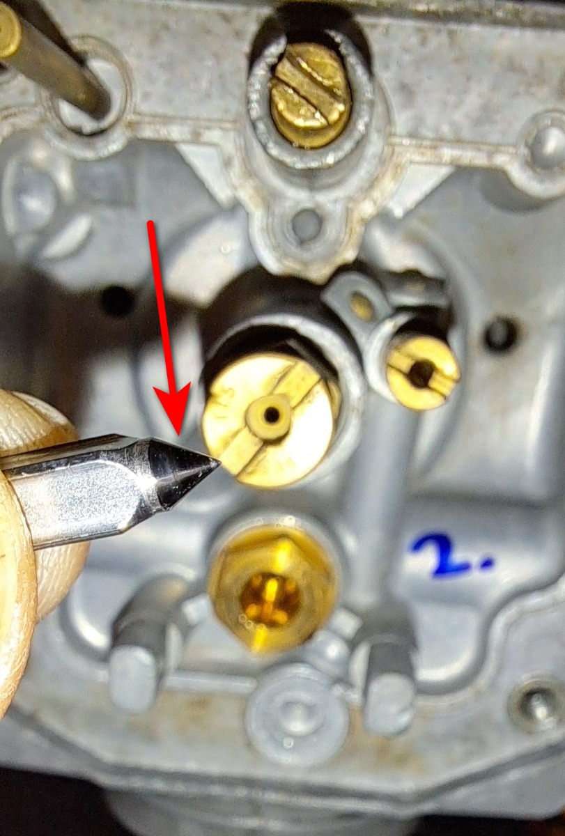

They should not leak at all even if you forget turn off fuel petcock. Check the float needle tip .If it has any sign of wear like a dimple ring replace them. Then check the float seats . If the float themselfes is not airtight they get filled with fuel and dont shut off the fuel as they suposed to.
Put them i a jar with water and look for airbubbles.After the watertest you can weigh them on a microscale and check if one is heavier.

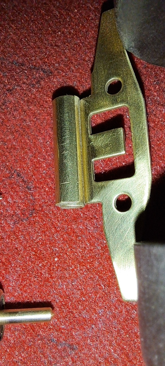

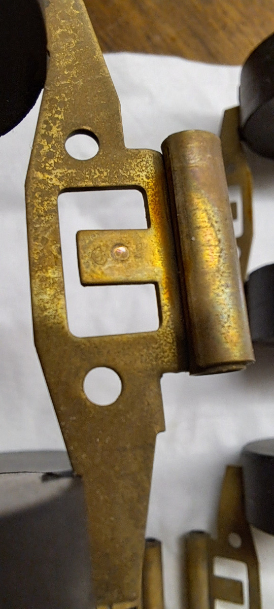

One more thing that can make the carb leak is worn thang.If it has a deep dipmle from the floatneedle it can make the float stick.You can file that down .se pick below

02 May 2024 09:04After some lapping of the needle into the seat, It has stopped leaking. I'll look for that dimple next time I have the carb apart.One more thing that can make the carb leak is worn thang.If it has a deep dipmle from the floatneedle it can make the float stick.You can file that down .se pick below
