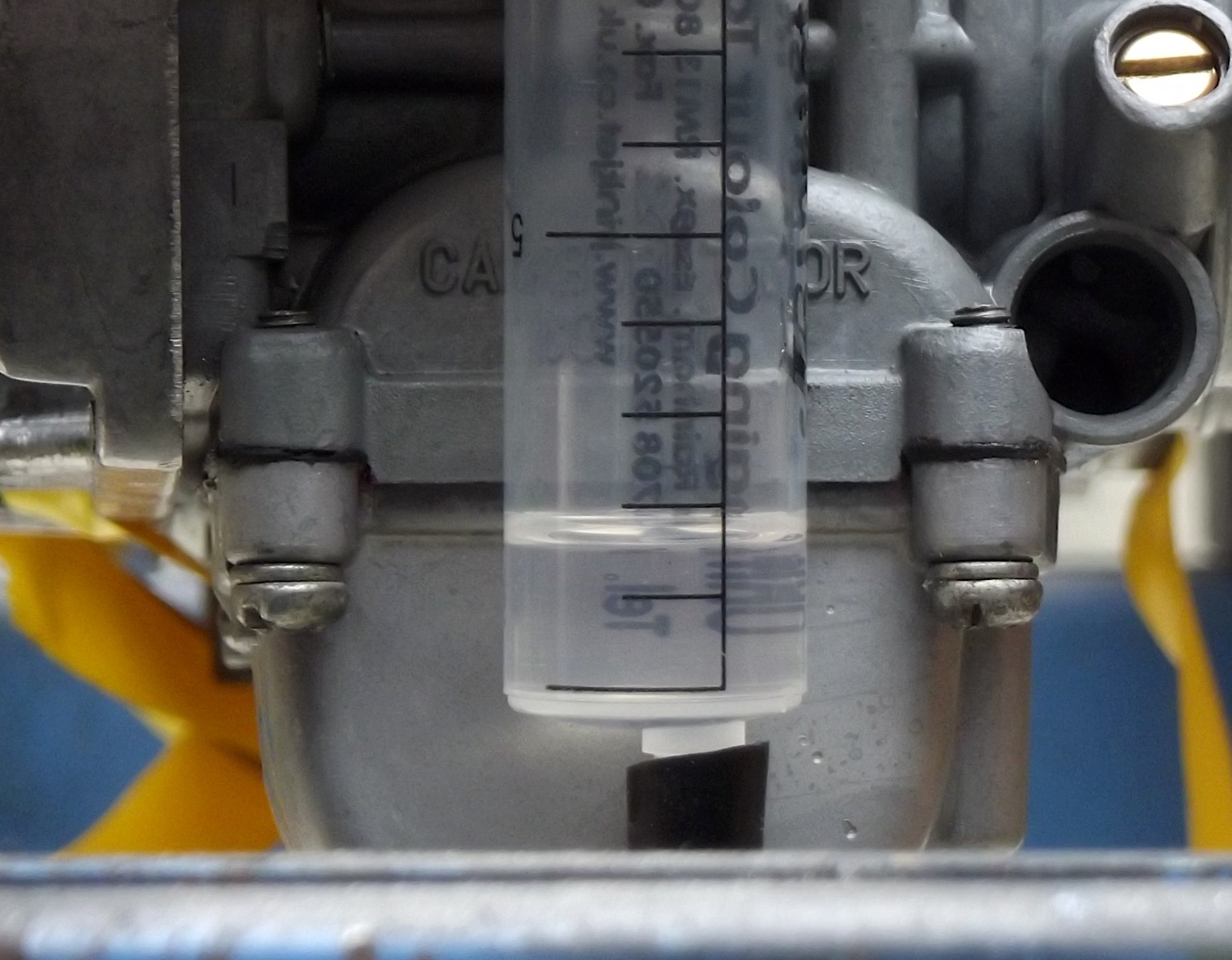

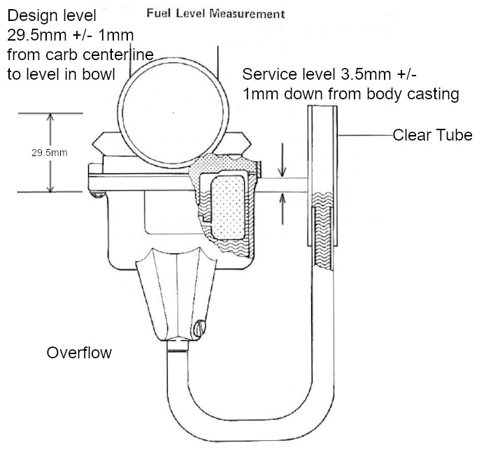

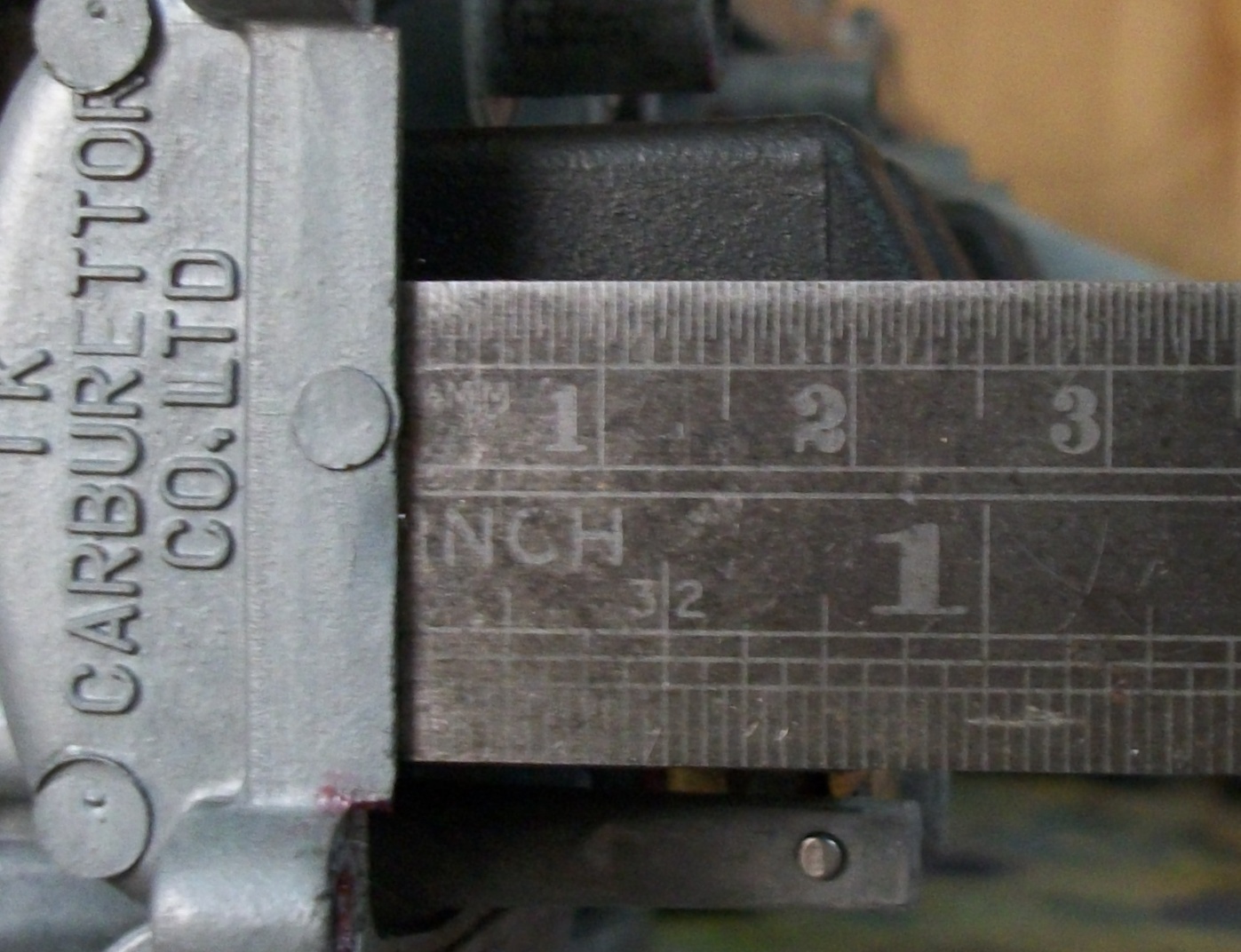

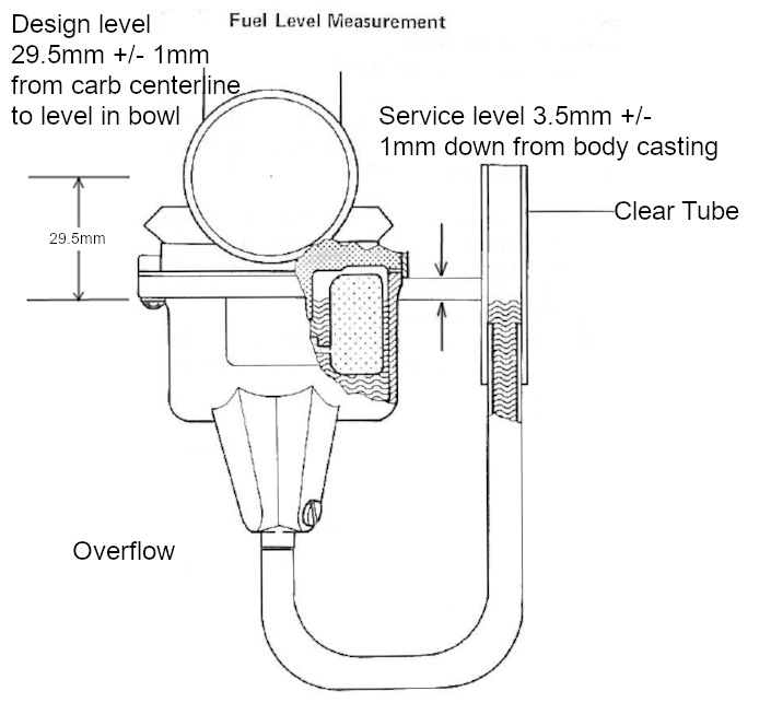

Ey up lad, the 400J carbs are slightly smaller version of my Z500 TK22, looks like you narrowed it down to no fuel. you set the fuel height via the float height so with the bowls off and carbs upside down start at around 18mm from gasket serface to top od the stepped bit of float. measure the other 3 for reference, if 4 is withing 1 or 2 mm of the 1,2,3 then you may have an air passage blocked not a fuel passage.
float height and fuel level explained
my float height at 19mm note where i take the 19mm from
this gives me a fuel level in spec when i put my clear tube on the over flow out pipe
if not fuel take out the pilot jet , idle mixture screw and spring on no4 and spray carb cleaner down the air passage on back of carb and see if it comes out of the pilot jet hole and then down mixture screw hole also clear out the main air passage hole at the back.
tell us how you get on. plenty red rubber grease on the inlet rubbers to get them on easier

Great pictures and explanations, this is just what i need. I tried the clear plastic tube from the overflow fitting yesterday and found that No4 was just below the bowl gasket line,then compared it to No1 which was bang on the gasket line, so tried bending the metal tang on the float down a bit. I'm going to start it today (I'm a bit limited by noise as my wife works above the garage) and see if there's any improvement. Lovely clean engine and carbs on your 550

Good to know, It's something worth looking into but for now its running on N04. I took the carbs off the bike and took the bottom half apart and sprayed carb cleaner through everything as advised above and i'm as certain as I can be that nothing is blocked. I did the same to the other three and they look in good nick. I didn't dismantle the slides and needles as they all looked well syncronised and I raised the needles and gave them a good spraying and they look clean enough. The floats on 1-3 were almost identical in height with 4 being the only one I tampered with to let more fuel in.
Started it up today and No4 still wasn't firing. I haven't put the airbox side rubbers back on yet so I sprayed some carb cleaner in there and it coughed and ran on it. I put my hand over the back on No4 carb and it started running, so in effect I was chocking the one carb leading me to think its running lean. I had all the mixture screws out yesterday and tried to remember how many turns out they were from full in. I've screwed No4 in a bit and its running. I'm going to let it cool down and start it again to see if it was a fluke and then I'm going to watch some Youpube clips on airscrews and mixture setting
