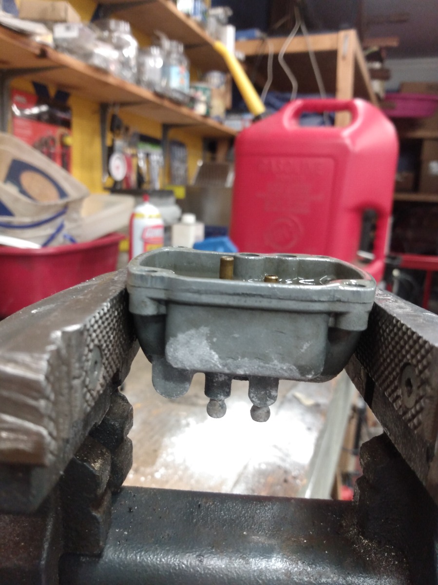

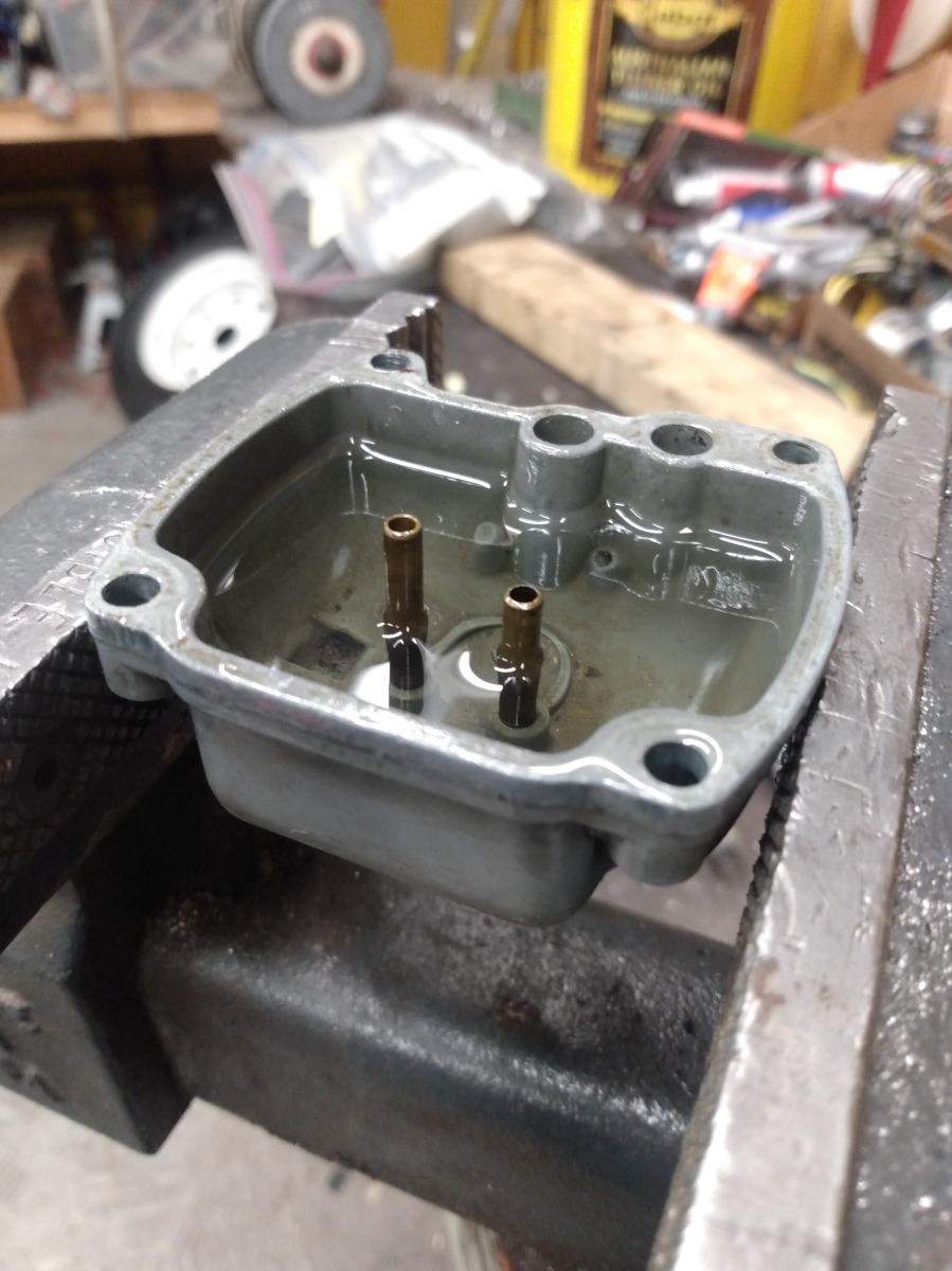

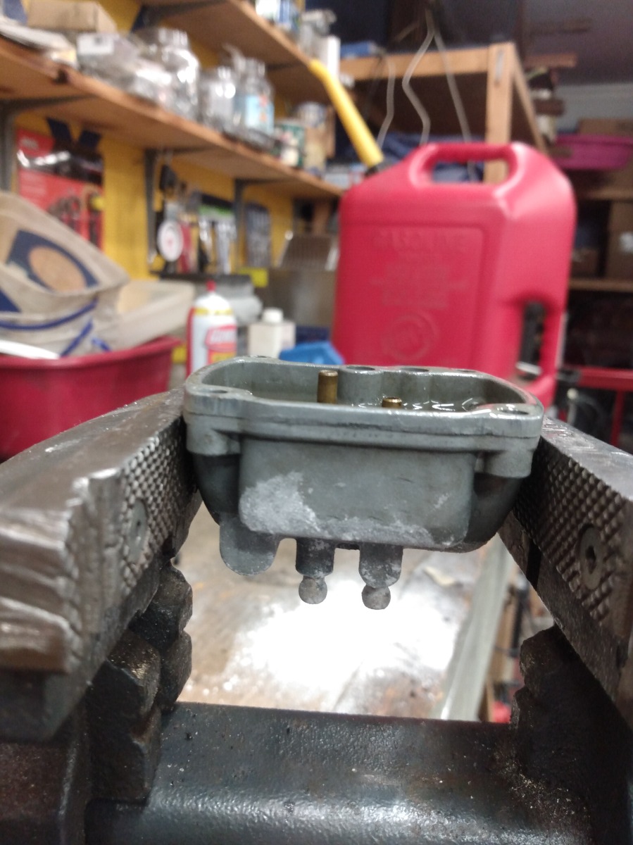

This is the carburetor bowl off my KE100. I filled it with gas to near the top of the shorter overflow tube. The pic was taken about 30 minutes after filling. The fuel level is lower than origionaly filled. It is not leaking around or through the over flow tubes, but seams to be seeping through the pot metal, as if it were sweating. Also, if I dry the top lip of the bowl, it is wet again in a few miniutes. Capillary action?

Are you sure it's not evaporating and condensing onto the top surface. If it's warm fuel doesn't take long to evaporate. Bit of clingfilm once filled will stop evaporation.
Try dusting the outside of the bowl with talcum powder. You'll soon see if the bowl is porous or leaking and where from.

I tried the talcom powder trick. It appears fuel vapor is condensing on the top of the bowl and working its way down the sides. It seems odd, fuel and carb both spent the night on my work bench in the garage.
