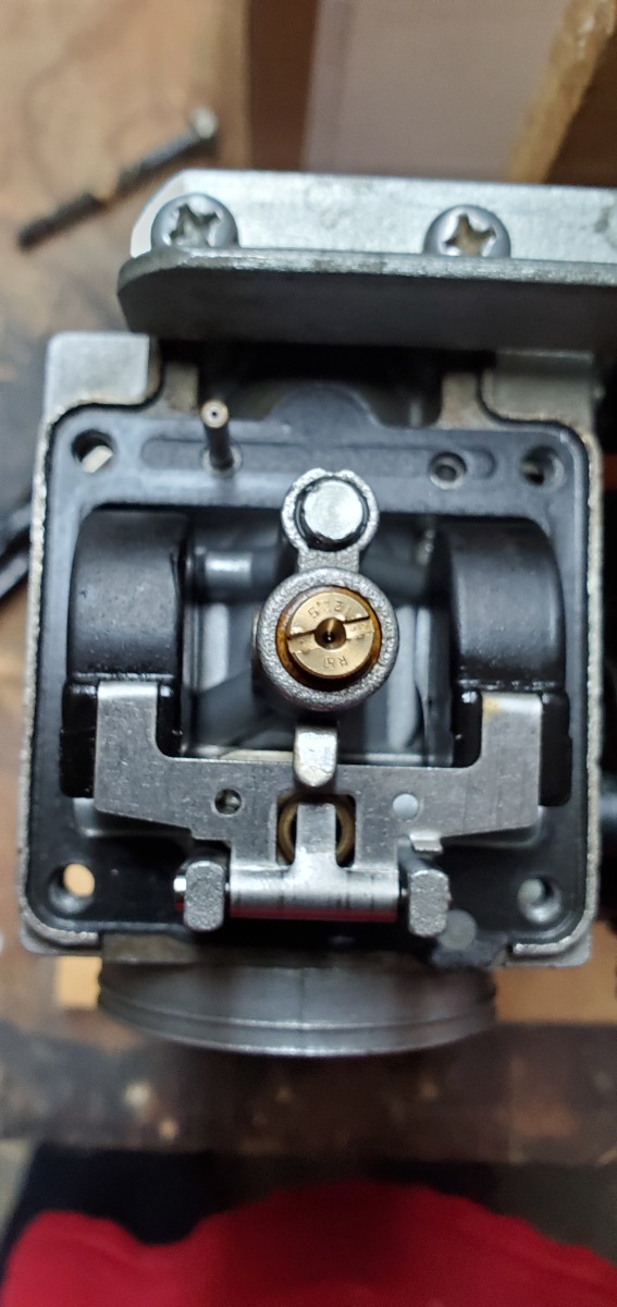

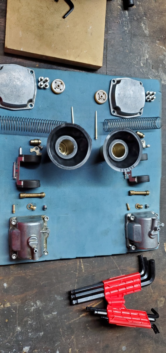

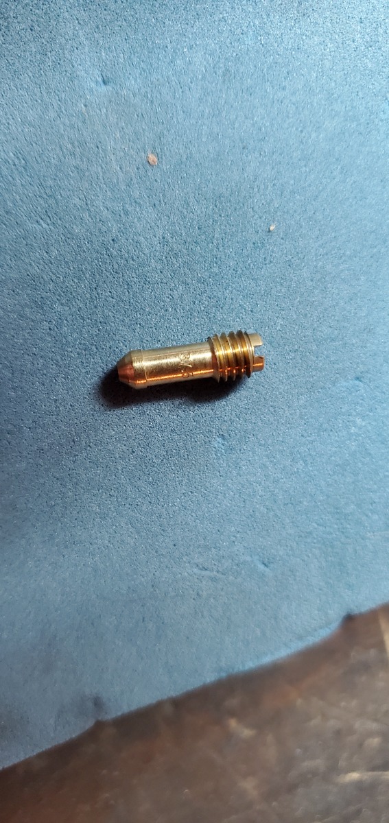

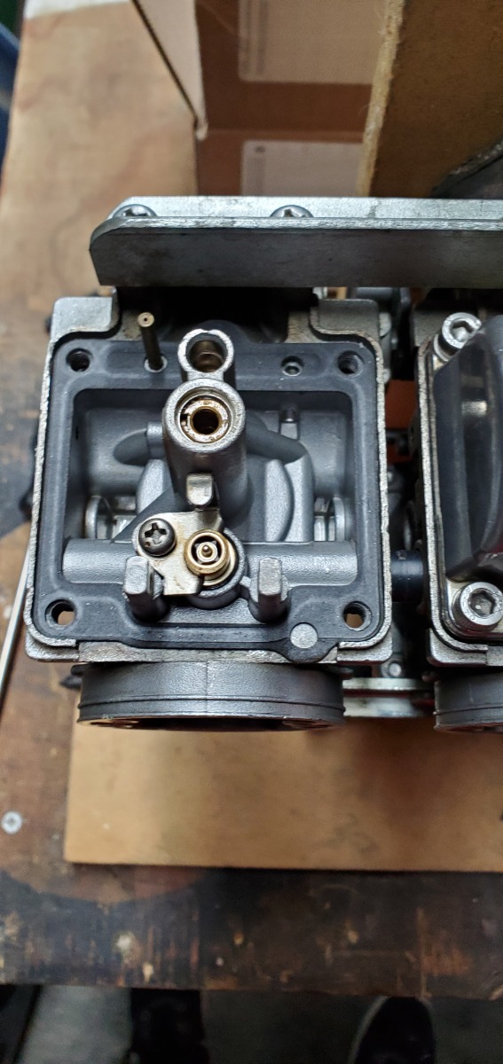

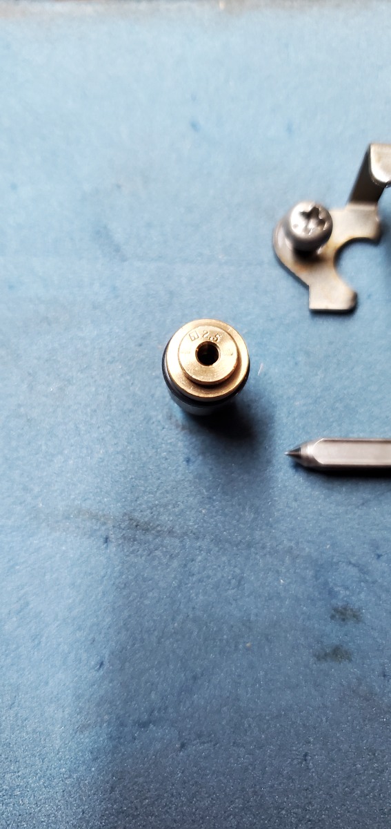

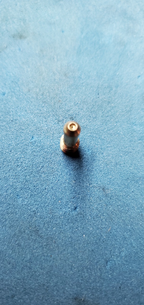

I took the offending carb (#4) apart and didn't find anything that was not consistent with the others. I checked the jets and openings in the emultion tube with no findings.
I decided since i couldn't swap the entire carb, I'd swap all the parts between the bad carb body and a good one (#1). The only thing I noticed during disassembly/reassembly was the emulsion tube didn't slide out of #4, it required a bit of pressure to remove/install, other than that everything was identical.
I'll put them back on the bike and color tune it see if the issue moves to the #1 cylinder.

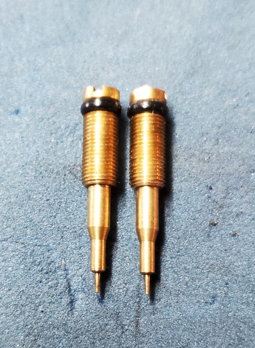

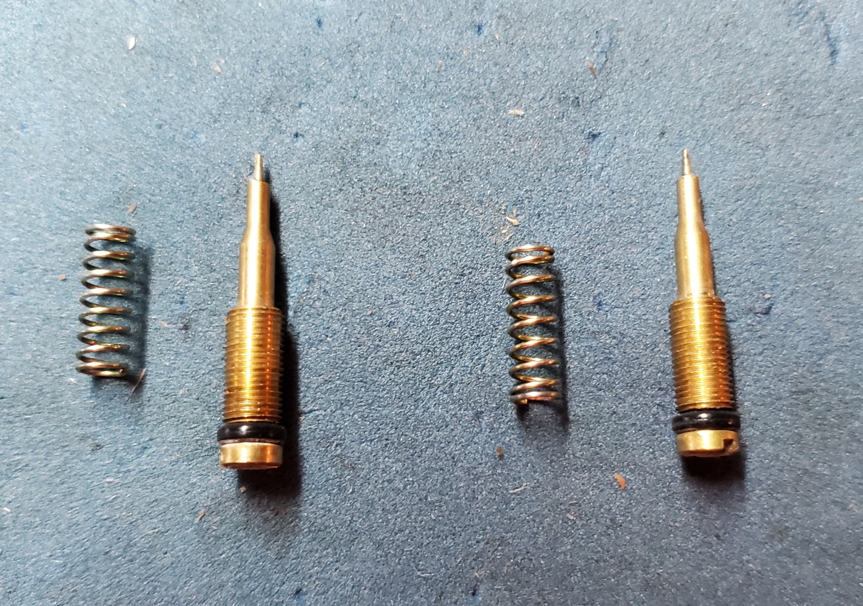

I do not see the pilot mixture screws or related parts in the pictures. There is a spring, mixture screw, oring and cap.
These parts are in the upper left of the parts diagram, starting with part number 92066.
www.partzilla.com/catalog/kawasaki/motor...-k2/carburetor-parts
The cap is aluminum, so you may be overlooking it. To remove the caps, CAREFULLY drill a small hole in the cap so you do not drill into the top of the screw. Twist in an appropriately sized self tapping screw until it is lightly snug, then grab the screw head with some pliers and pull the plug out. You can then remove the rest of the parts and clean them and the tiny passageways.

You are on top of it when you can look at a pile of parts on a workbench and see what's missing!

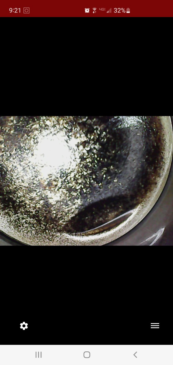

You are correct, I didn't swap those last night, but pulled them this morning and did so. I set them to the factory 1 1/4 and will break out the colortune later for fine tuning the idle circuit.

May be my eyes not right, but have you checked that the tip on the left mixture-screw is not broken off ?

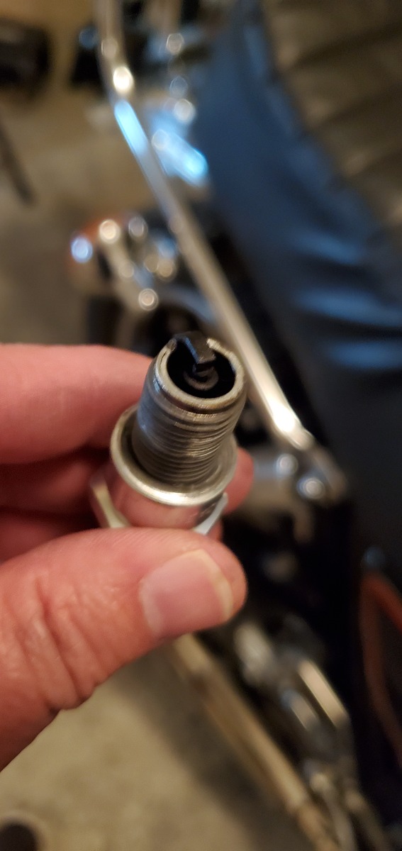

Update,

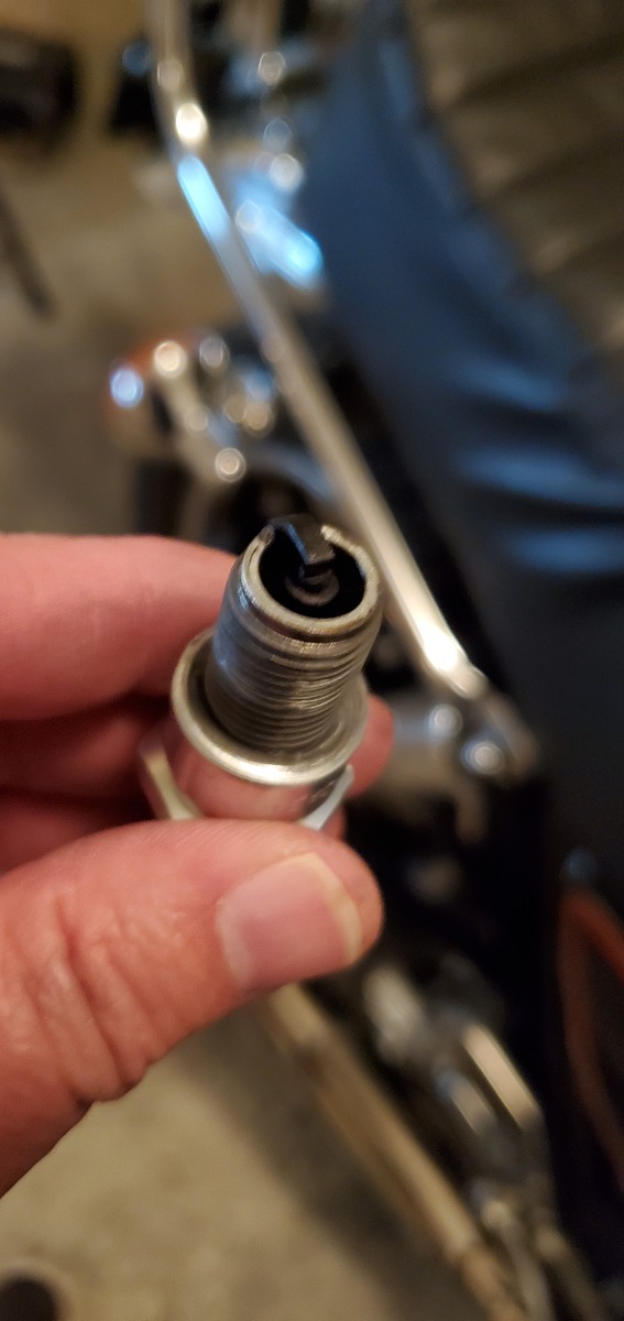

I completed switching all the internals of the offending carb (#4) over to #1. Switched to a clean plug in #4 and put a few miles on it (<50).
The fuel soaked plug did NOT move with the carb internals, but reappeared on the #4 cylinder.
I'm going to swap plug wires next.
Any other trouble shooting ideas are, as always, appreciated.
Cheers
Scott
