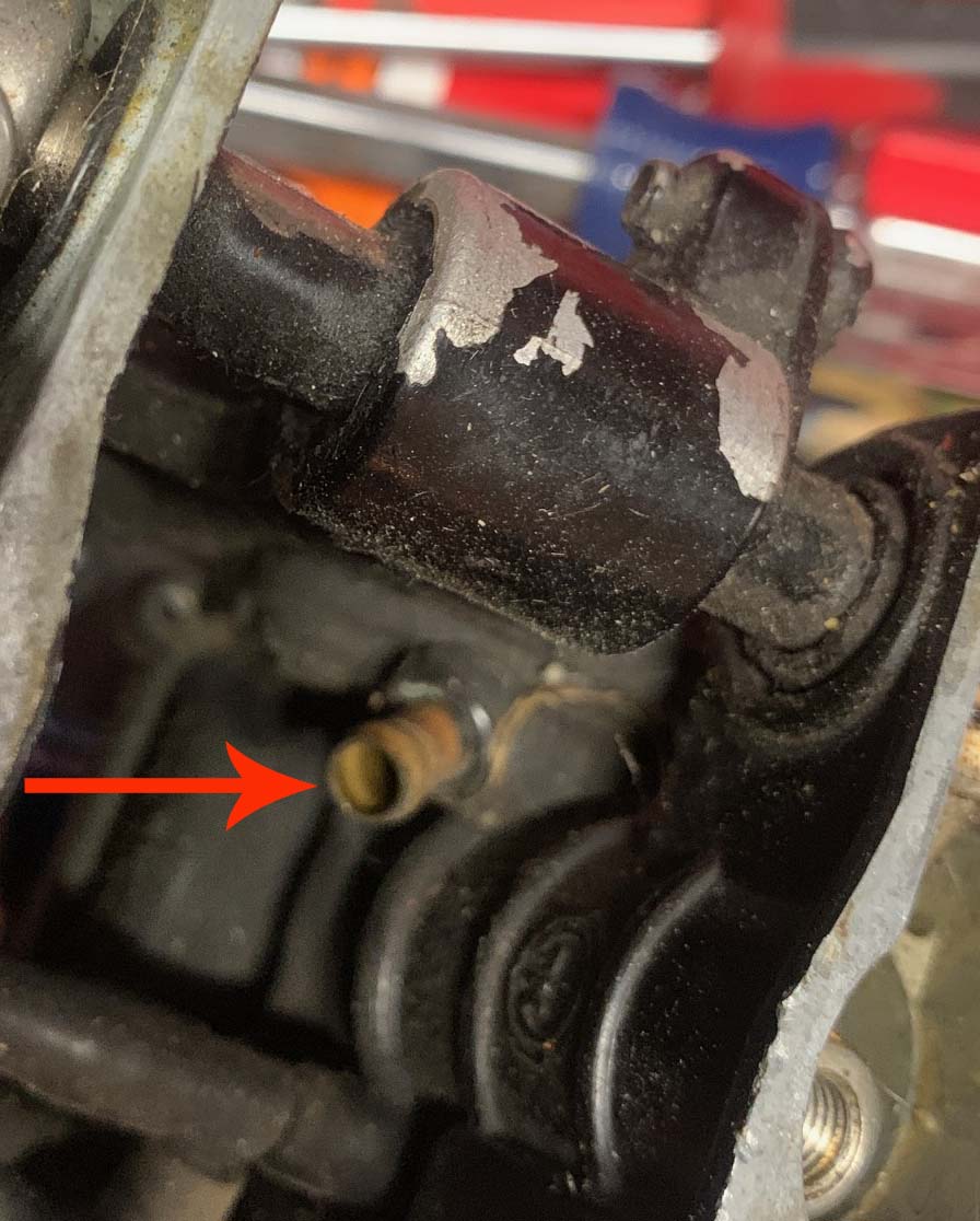

I block this off, correct?
- chopper1963
- Posts: 440
- Thanks: 94
19 Mar 2024 05:06
I'm abot to start my D1 project.
I use an aftermarket (MP) petcock without a vac portion.
So, on the carbs I would block this port off, correct?
TIA
TIA

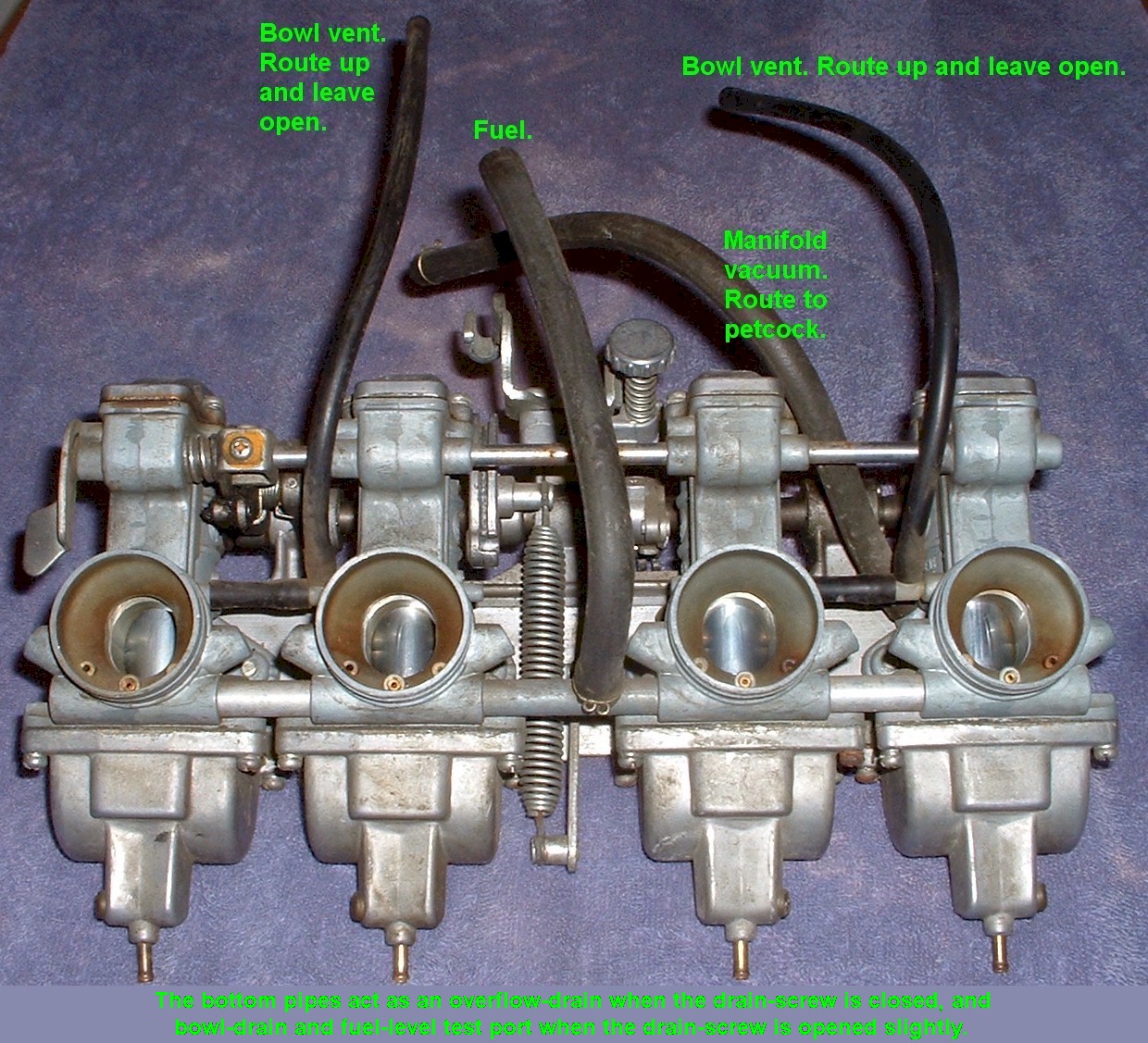

- Posts: 8232
- Thanks: 3613
Re: I block this off, correct?
19 Mar 2024 06:55 - 19 Mar 2024 06:56
Last edit: 19 Mar 2024 06:56 by Nessism.
The following user(s) said Thank You: Mcdroid, Street Fighter LTD, chopper1963, gordone, F64, howardhb

Someone should download that whole site in case it ever vanishes like the old GPz550 forum did.
