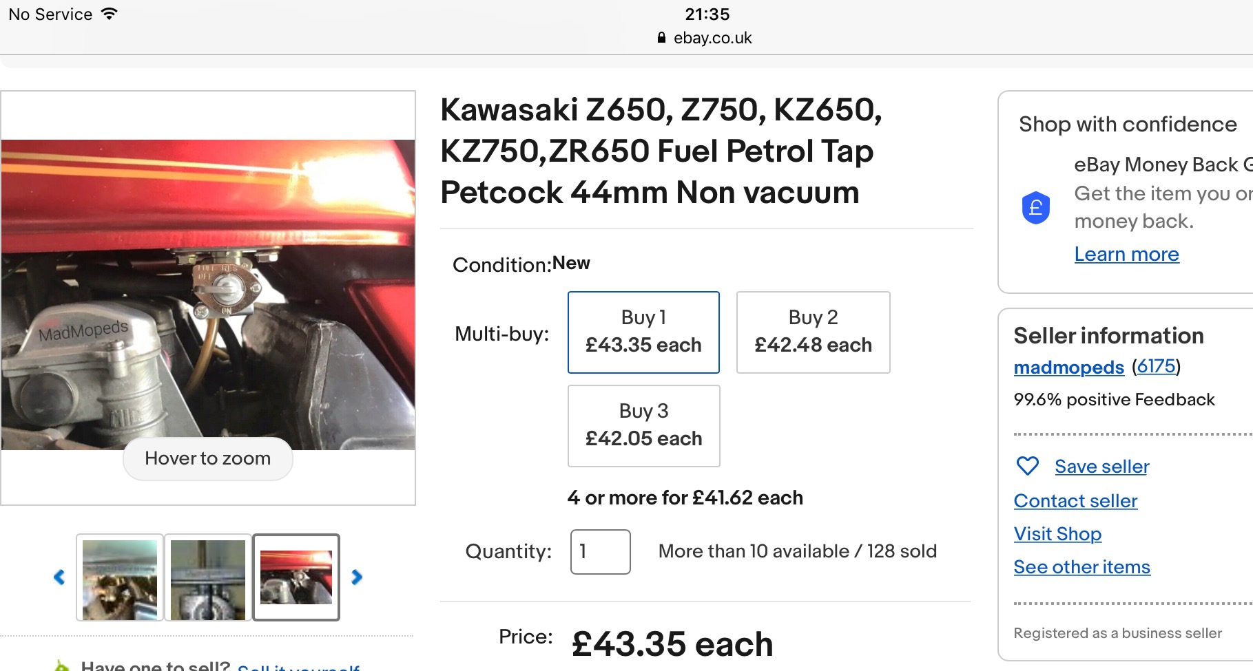

@Wookie58 that Mad Mopeds option looks like what I need. I'm just surprised it does not seem to be available from a US vendor.

Re: Fuel Petcock - Non-Vacuum Replacement?
06 Feb 2024 08:29
May be worth getting them to quote you for shipping
