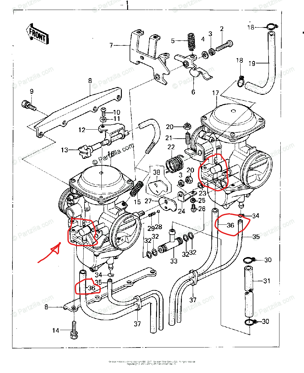

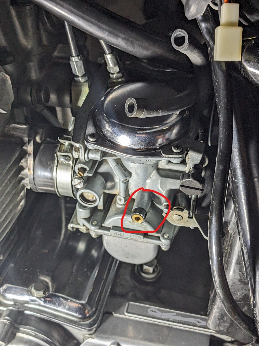

CAP NEEDLE
- danr123
- Posts: 29
- Posts: 23786
- Thanks: 3051
Re: CAP NEEDLE
28 Nov 2023 14:37
LOOKS LIKE A FLOAT BOWL VENT
- Posts: 8232
- Thanks: 3613
Re: CAP NEEDLE
28 Nov 2023 14:48
It's part of the carb body, and not sold separately. You should be able to cobble something together from items at the hardware store, though. As Steve mentioned, it's a vent line. Not a critical component. In fact, you could likely chip off the rest of the broken plastic elbow, and slip a rubber hose over the brass piece. Run the hose down to the ground, away from the rear tire. If you get a leak, you don't want gas dumping on the rear tire.
