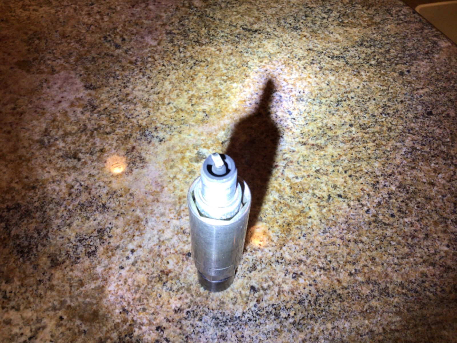

My #1 plug is still running black. Not as bad as before I synced and adjusted the carbs, but still black and sootier than I’m thinking it should be. Ignition? Choke plungers? I posted a pic of the #1 plunger earlier but I don’t have anything to compare it to. I may do the Dyna system this weekend and see how it runs.
