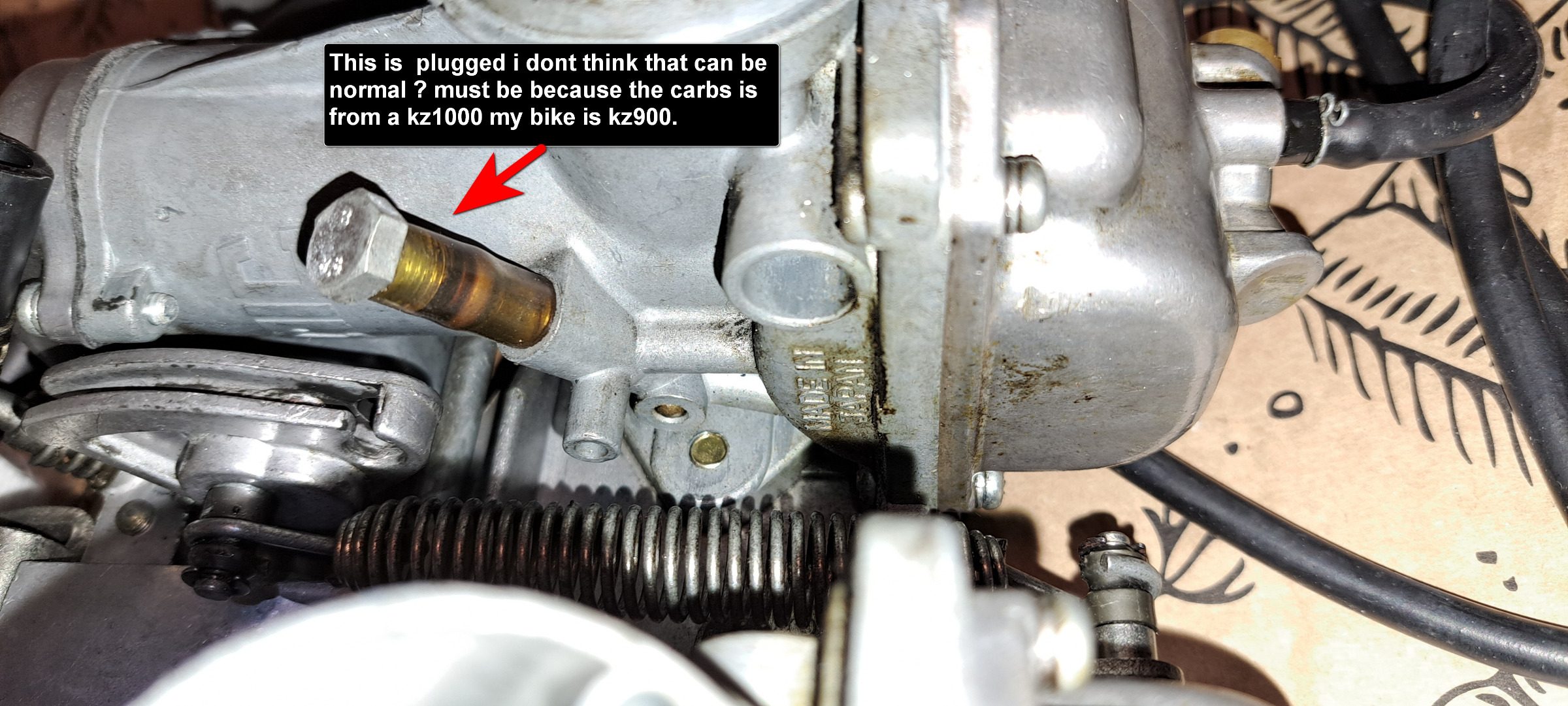

The plugged port on number 3 carb near the cable reel is a vacuum port for a vacuum operated fuel tap.
It must be capped as shown if not in use.
If left open it would cause that cylinder to run very lean.
The ones on carbs 2 and 4 are bowl vents and must be left open to atmosphere.

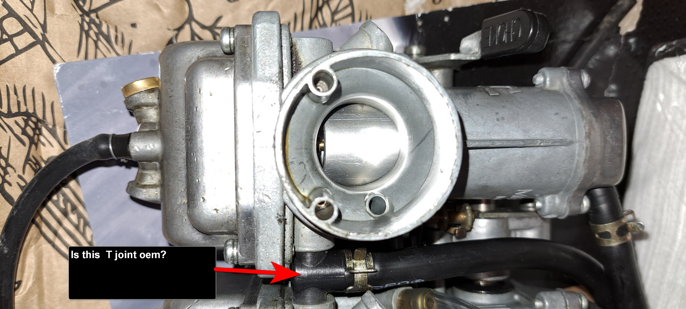

The fuel tee is OEM and depending on model some have a single fuel hose between carbs 2 and 3 and some have two between 1 + 2 and 3 + 4 as yours..

Those are Mikuni VM26's, as supplied on the 1977 & '78 1000A model. The rubber coated zinc fuel tee's, two of them, are the stock configuration. From the photo, I can't tell what carb port is sealed, but there are THREE nipples on those carbs; two are float bowl vents, joined with the adjacent carb, and the last is a vacuum port, on the #3 carb.

Thank you guys then im able to order some parts when rebuild them. They leak a little not sure where but it was gunky fuel at the bowls.They was rebuildt by a kawasaki dealer in 2019.
I suspect the fuel tees are leaking so will have to separate them and put in new orings

Those fuel tee's don't use O-rings. You can order after market Tee's that do, though. I prefer that type.
I have O-ring kits for those carbs, if you can't find a full set otherwise....

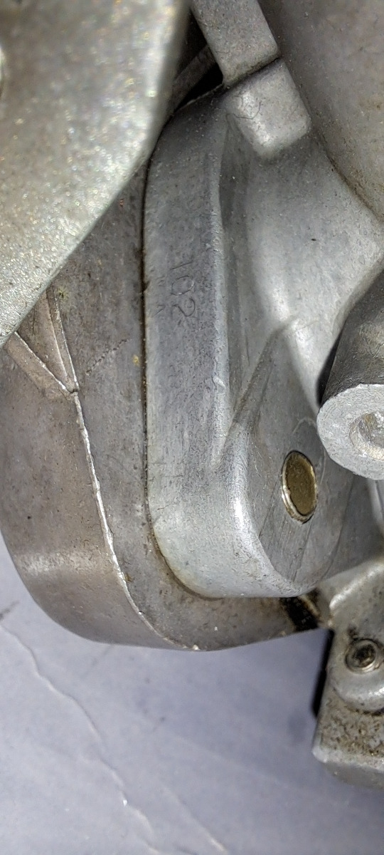

From the first pic you posted, I pulled it down to my laptop and enlarged it. I can see a partial ID stamped below the choke level. However it is not clear enough to read it. Things I will say about the carbs you have they do have 2 fuel inlets, a vacuum port on #3 which is plugged as Zed indicated and they do not appear to have an air screw.

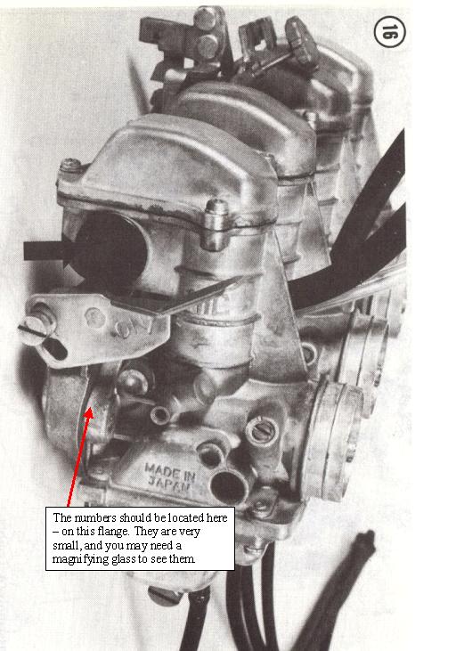

I have attached a pic of the location of ID stamps on the carbs. Note the pic I have attached is of a different set of carbs than yours but the location should be the same.

Thanks gd4now i zoomed in with my phone and found the marking. yes they dont have a air screw ,but they have the mixture fuel screw in front underside of bowls
