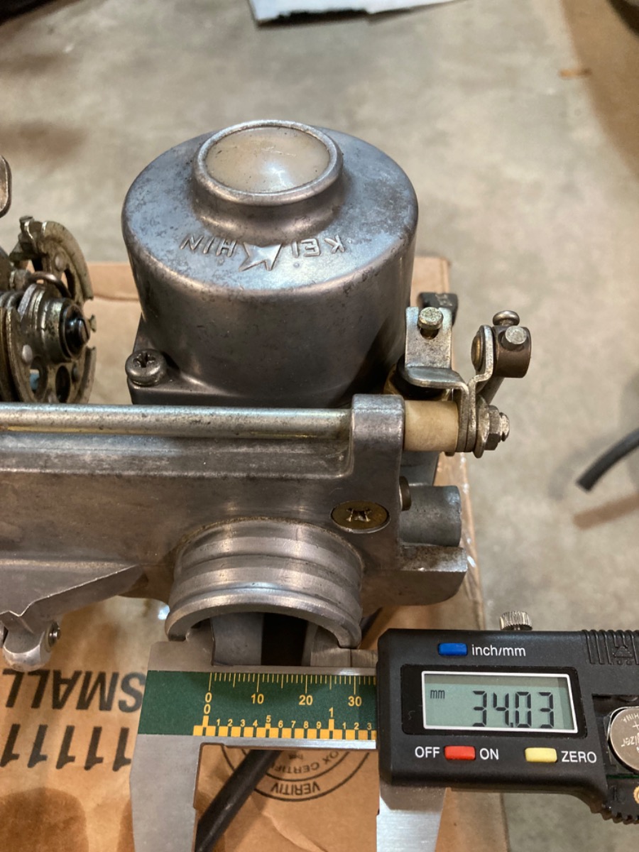

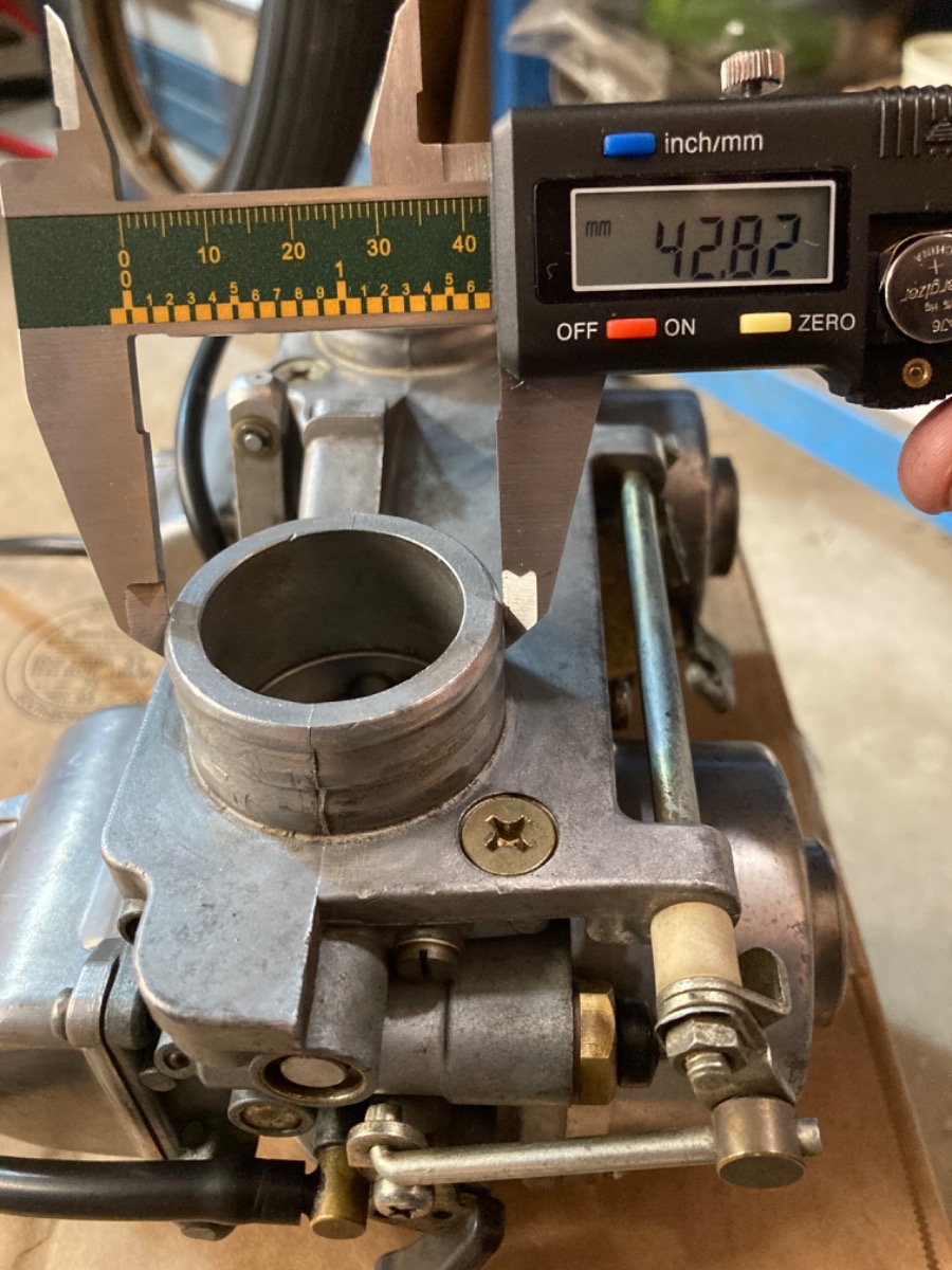

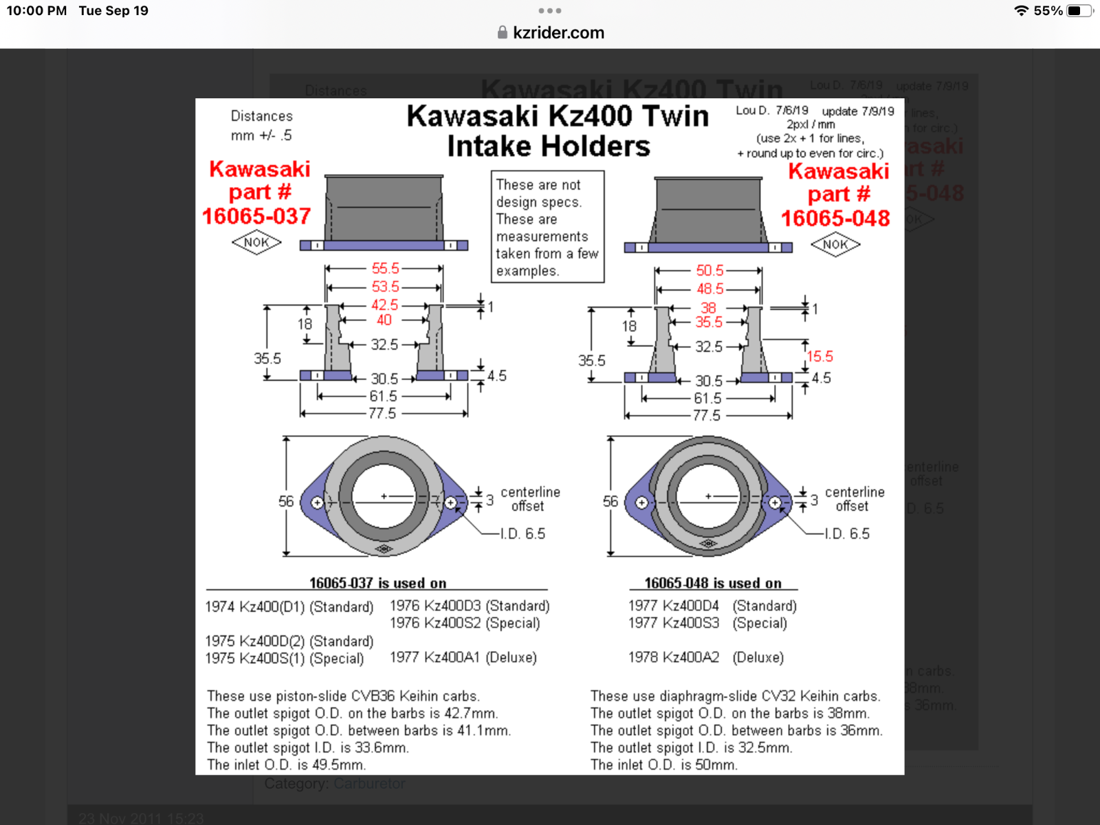

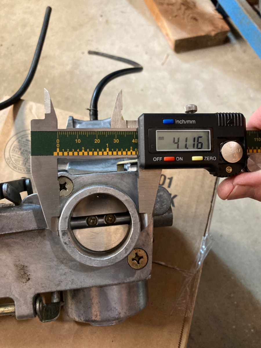

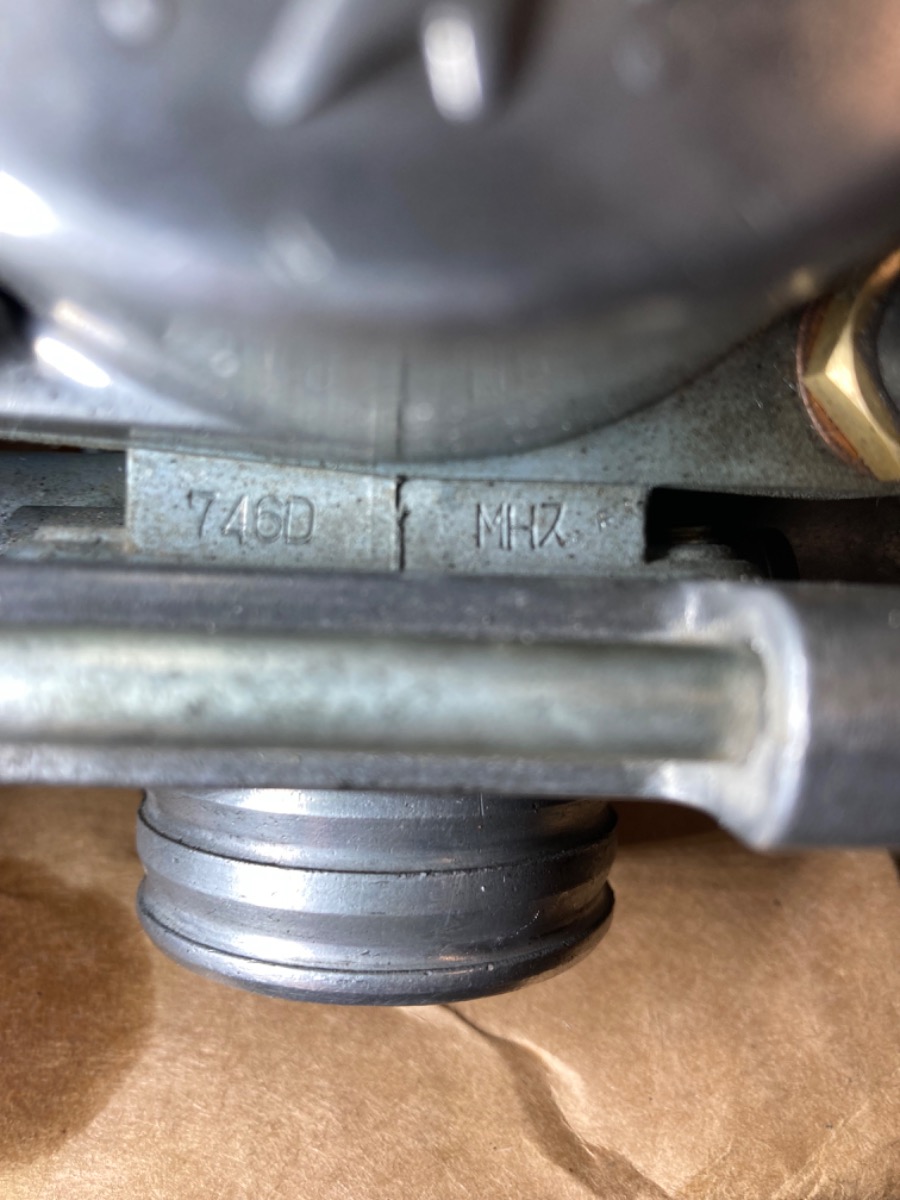

Yes I am questioning if the carbs were changed in the past. All images that I have seen of the Keihin CVB36 match the carbs that I have. My carbs are stamped with 746D. I have not cross referenced that to a carb model number yet. I attached a holder drawing found on a discussion from several years back. The dimensions listed for part # 16065-037 would fit the carburetors on my KZ. The caliper measurements in the attached photos closely match the drawing measurements of the…-037 holder. Stumped at this point.
