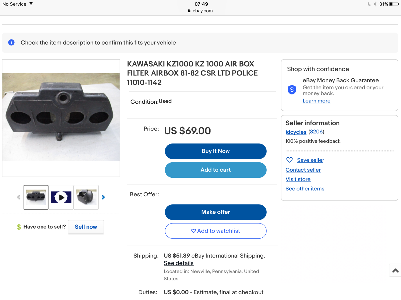

It appears to be the same as an 81-82 Ltd/CSR
PS: I would sort the carb leak before it bursts into flames

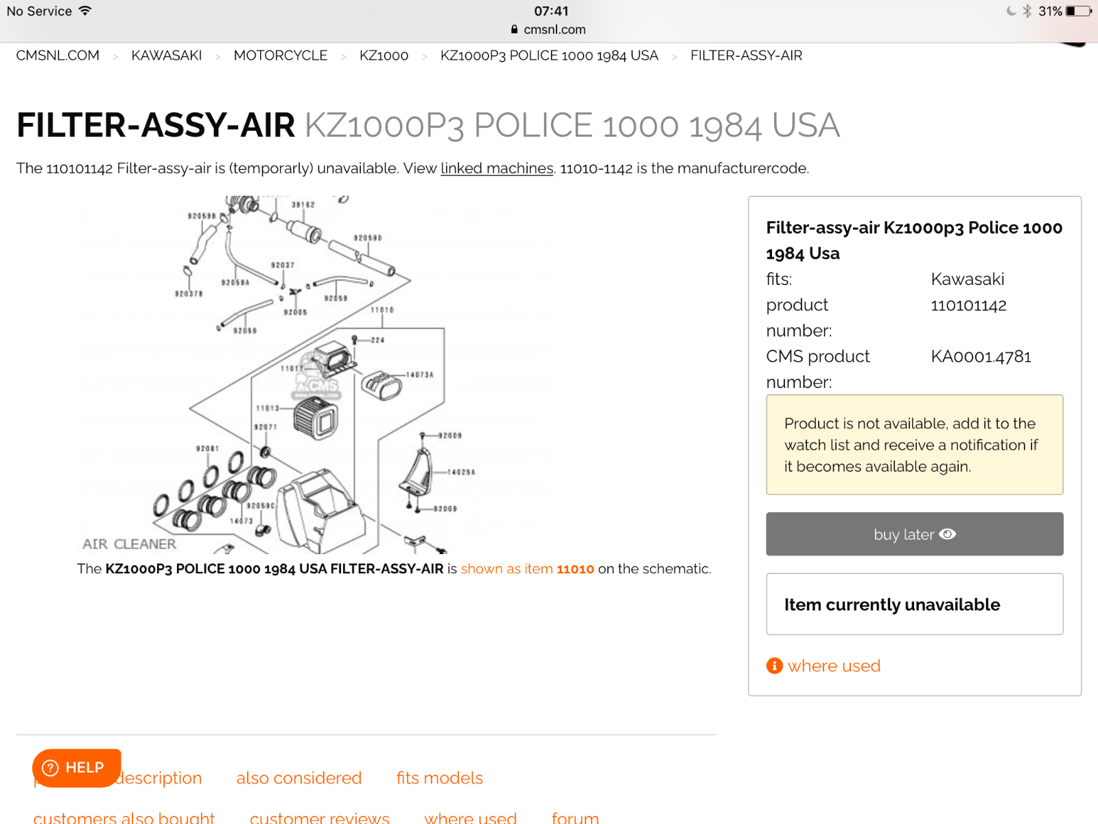

According to Partzilla, it was also used on the KZ1000J and the KZ1000R (ELR).
www.partzilla.com/product/kawasaki/11010...0a6ddaeb2189e318313a
+1 on fixing the carbs. Flames are bad.

You can probably use the airbox assy from any KZ1000P >> 1982 - 2005.
Here's the 1982 & 2005 diagrams which look the same, but you should compare stuff to make certain.
