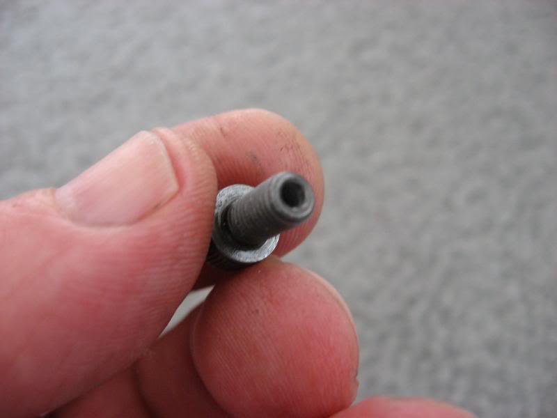

To make an adapter, find a bolt that threads tnto the hole. Cut the bolt so you have a piece that there a few threads on one end and .5" of smooth on the other. drill a small hole through it.

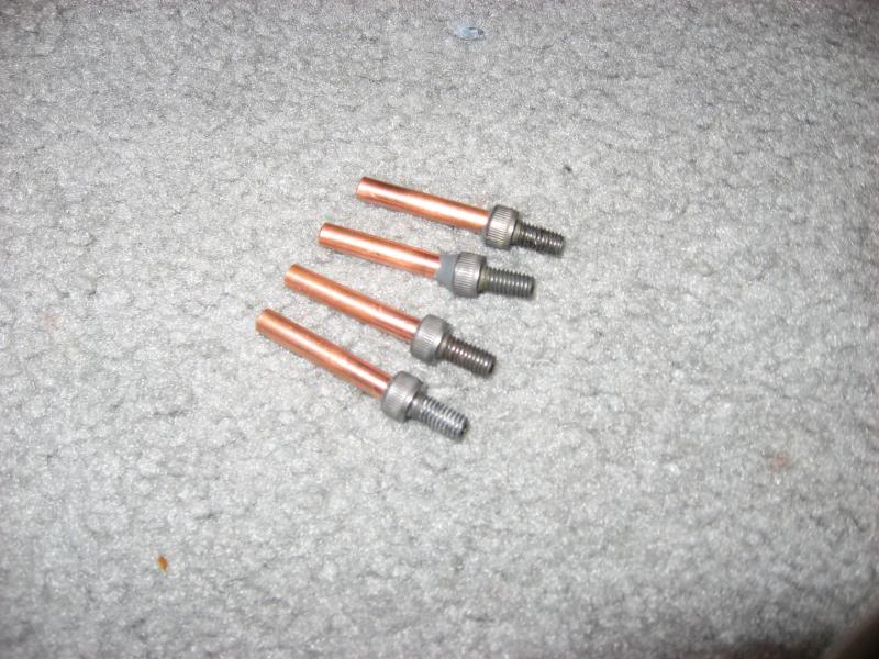

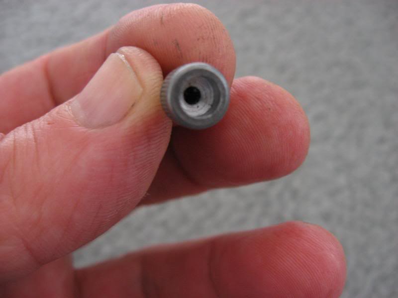

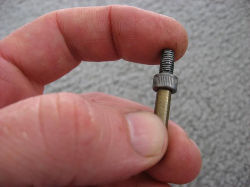

19 Aug 2023 13:14Looking at the homemade adaptors pics Nessism posted, It looks like the brass tubes are about the same diameter as the bolt.Are you thinking the hose is big enough to fit over the smooth end?

19 Aug 2023 14:12Are the tubes epoxied or cemented onto the bolts? Heading to the hardware store now...
