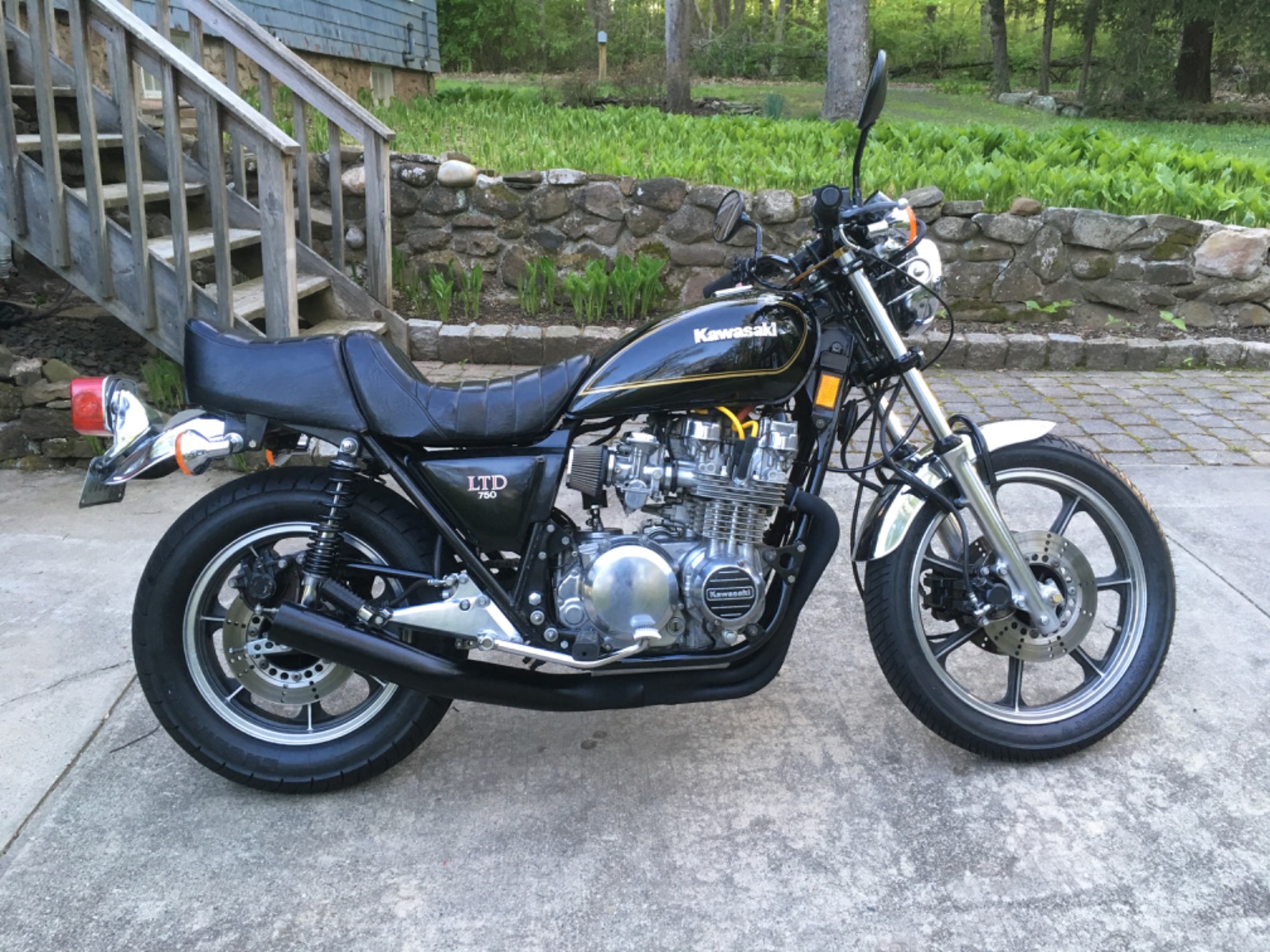

I have just rebuilt my kz750 with a wiseco piston kit bringing it to 810cc. The bike stock has a #125 secondary jet. Before the rebuild and with the 4 into 1 Yoshimura pipe I had boosted the jet to #130. With the larger pistons from the rebuild I went up again to #142.5. The bike seems to be starving for gas and the spark plugs are whiteish. How far up should I go with the jet size?

That bike sure looks nice! Love how tight the pipe tucks up tight to the sump.
