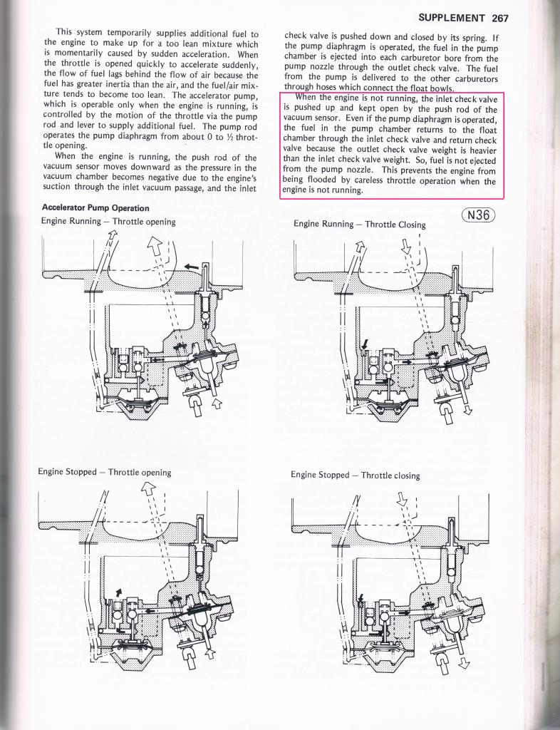

From the pic posted it appears that this set of carbs has both a pump and a sensor. As I understand it one of the things the sensor does is only allow fuel out of the pump if the engine is running (providing vacuum)
