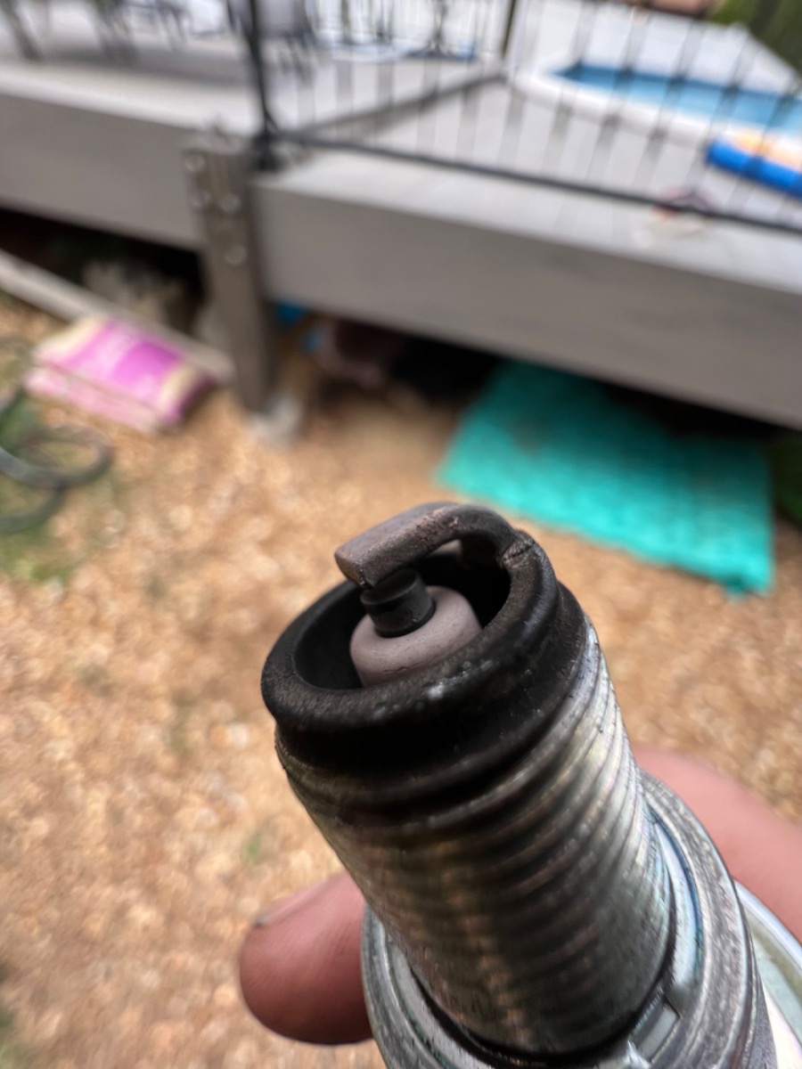

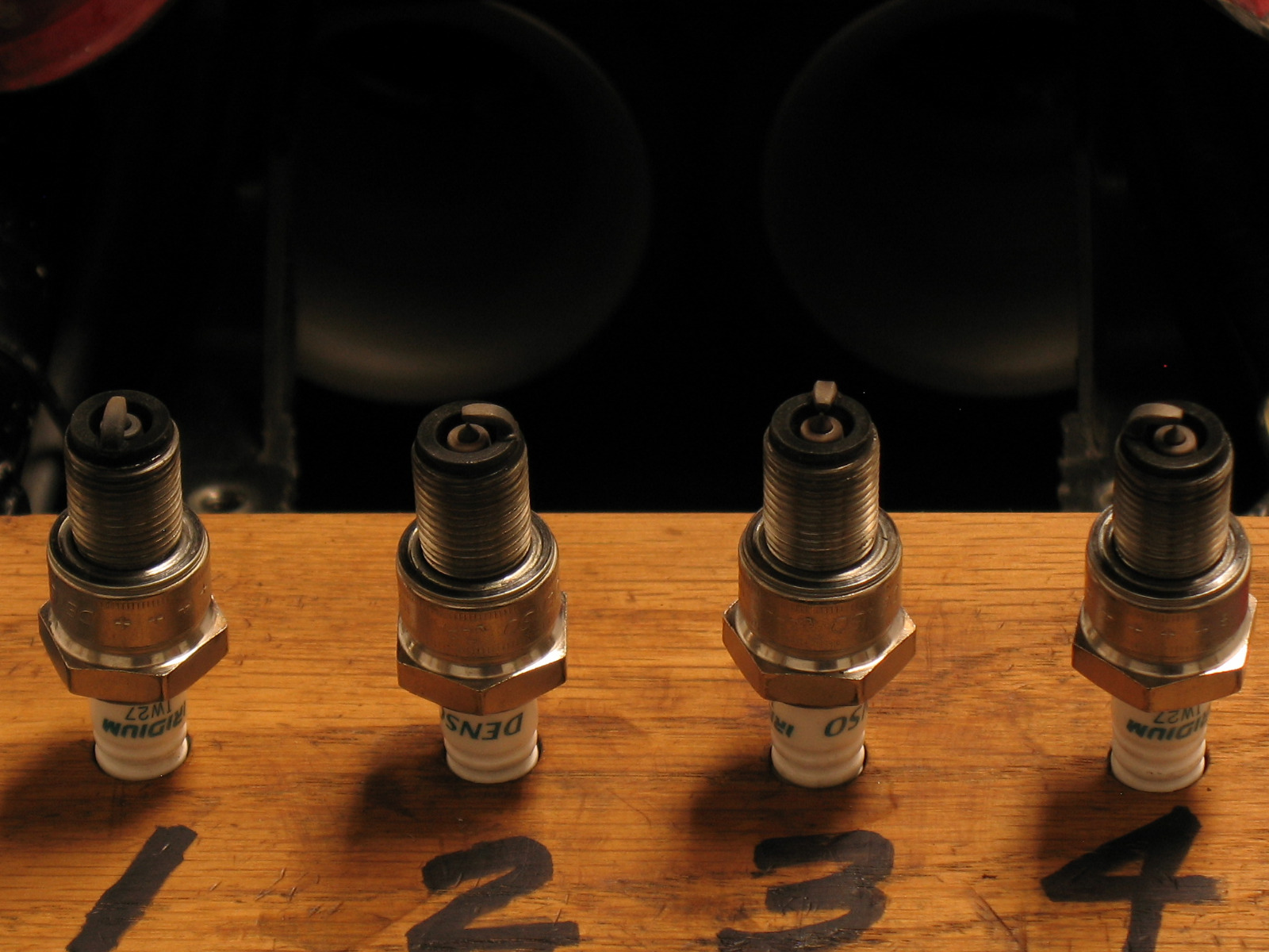

Show us a picture of the spark plugs please.
See example below:

Number 4 plug. All look almost the same
