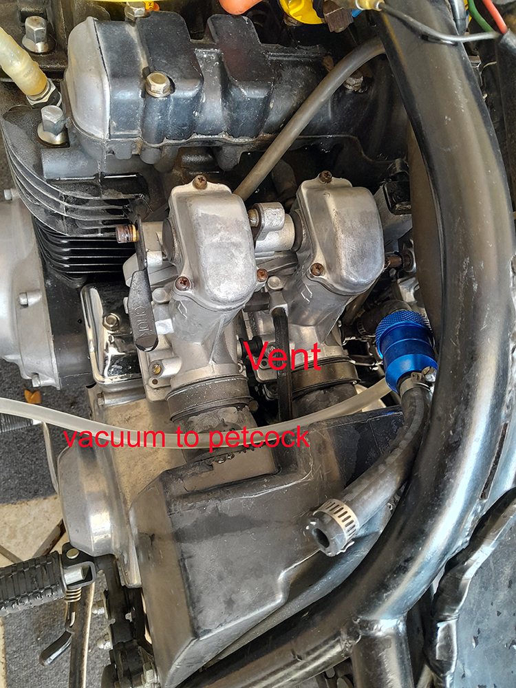

Two should go to the Clean Air valve assembly, one should go to the petcock, and one should be capped. It does not really matter which hose goes where, just make it easy on yourself.
If the Clean Air assembly is still in place, the diaphragm in the valve could be leaking, which will make for serous carb mixture wackiness on the two that are connected to the valve. If you suspect the valve diaphragm is bad, the easiest and surest solution is to remove the entire system, cap off the nipples on the reed cages, plug the hole in the air filter box and cap the vacuum ports on those two carbs.
Be sure to buy high quality vacuum caps designed for motorcycles. Many of the cheap caps at auto parts stores are not designed for the harsh conditions on a bike and will crack and leak forthwith.

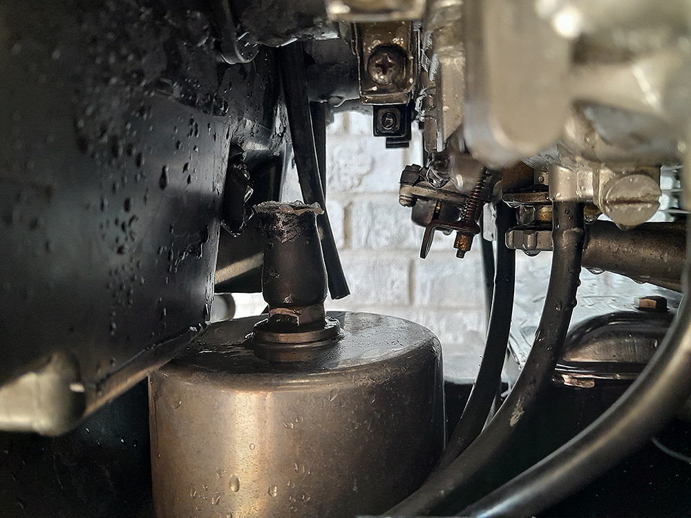

Not really sure where the Clean Air Assembly is. Is it the round device under the carbs? I think a hose routes that into the airbox. Currently, it's not connected. I figured since it's blowing air out and not sucking it in, it routes engine fumes back into the airbox to be reburned. Ill take pictures of the carbs when I get home.

No, that's the crankcase breather and yes it vents fumes back to the airbox.

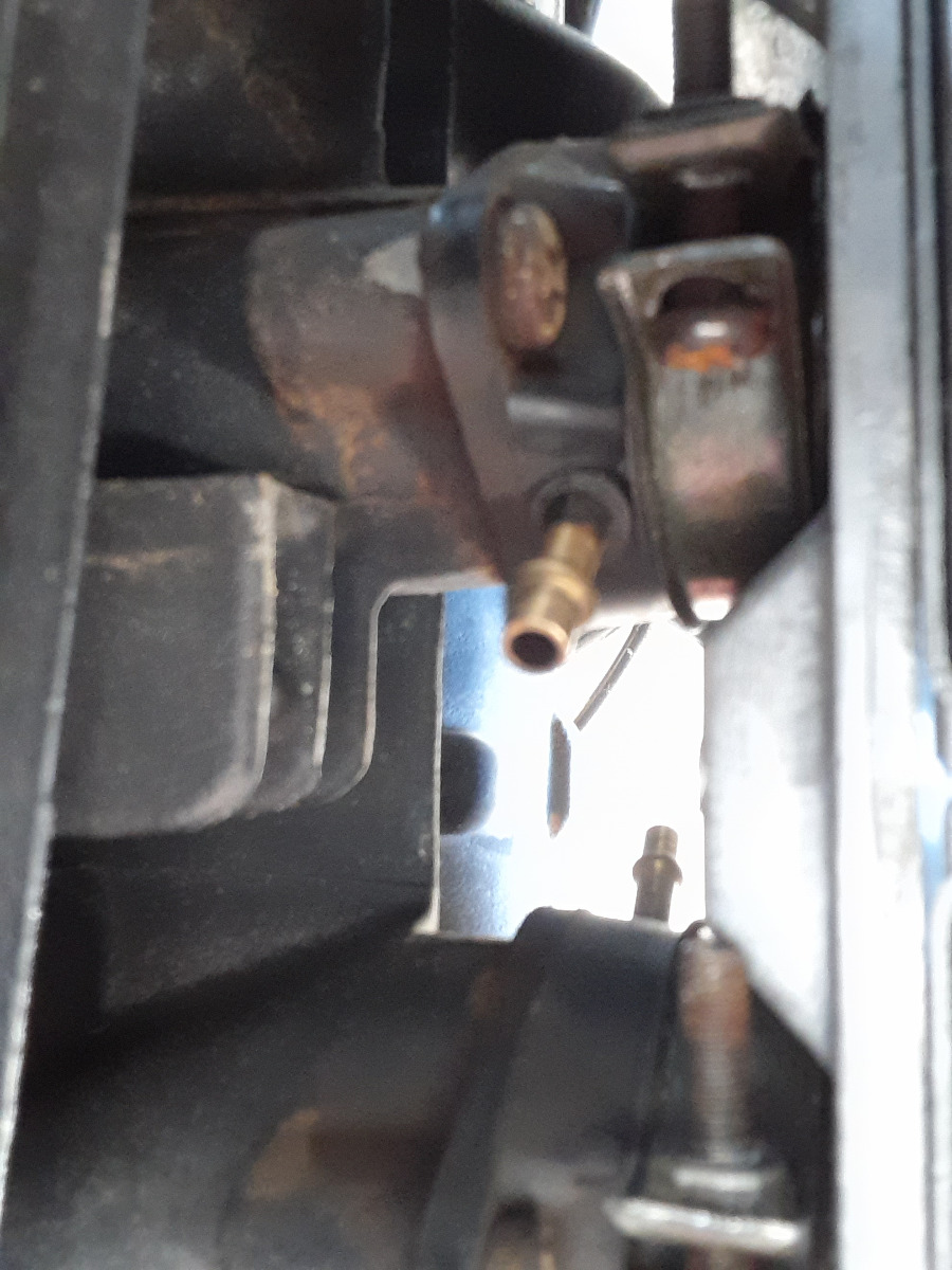

Okay, here are a few pics. I only see 3 nipples from the carbs. Two are vents, as noted, and the other is for the vacuum to the petcock. I will see if I can find an elbow to replace the one that's missing that routes are from the engine back into the airbox.

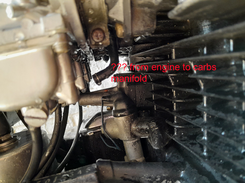

I have this 90 degree hose coming off the manifold between the engine and carbs, but I don't see where the other end connects, so I don't know if the guy that worked on the carbs just threw it on or it actually goes somewhere or should I just put a plug over the end?

In the first pic above, the hose on top of the crankcase vent is supposed to connect to the air filter box. See reference number 13 in this parts diagram.
www.partzilla.com/catalog/kawasaki/motor...z1000-e1/air-cleaner
In the second picture, what does the other end of that hose connect to?

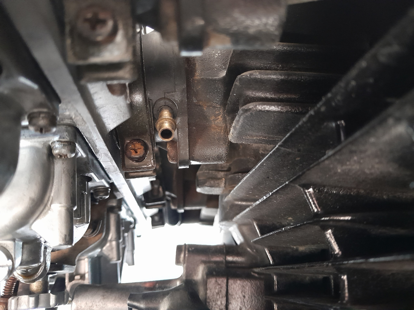

It connects to a nipple on the manifold between the carb and head. This is a pic looking up from below it.

Lord have mercy. If the hose hanging down between the carbs and engine is not plugged, there is no way that cylinder can be firing. The mixture would be so lean, a grenade could not ignite it. Can you get a pic of where it connects to the carb holder? I don’t remember seeing one like that before.

Is this what you wanted to see? I disconnected the top hose so I could get a picture from above as well.
