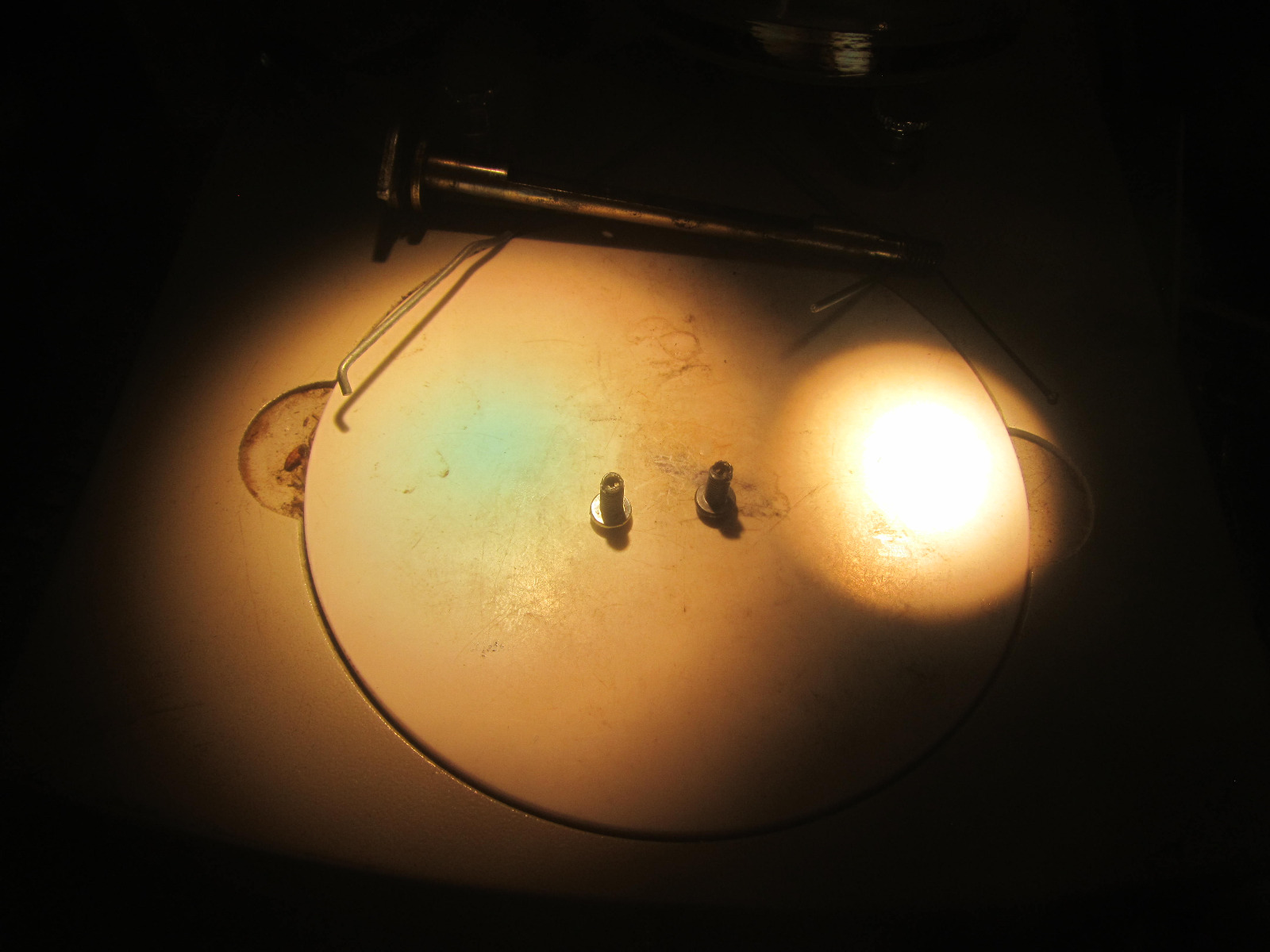

I figured I'd never find another spring with the same tension as the original unless I bought an entire carb. Since only one of the straight ends broke off, I straightened out a coil on that tiny and surprisingly strong spring (fun! not) and made a new end out of it. I finally discovered its a lot easier to work on it while it's on the pin. Seems like it may work although the resistance is slightly less. Maybe a tiny dab of jb weld to stake the pin in again

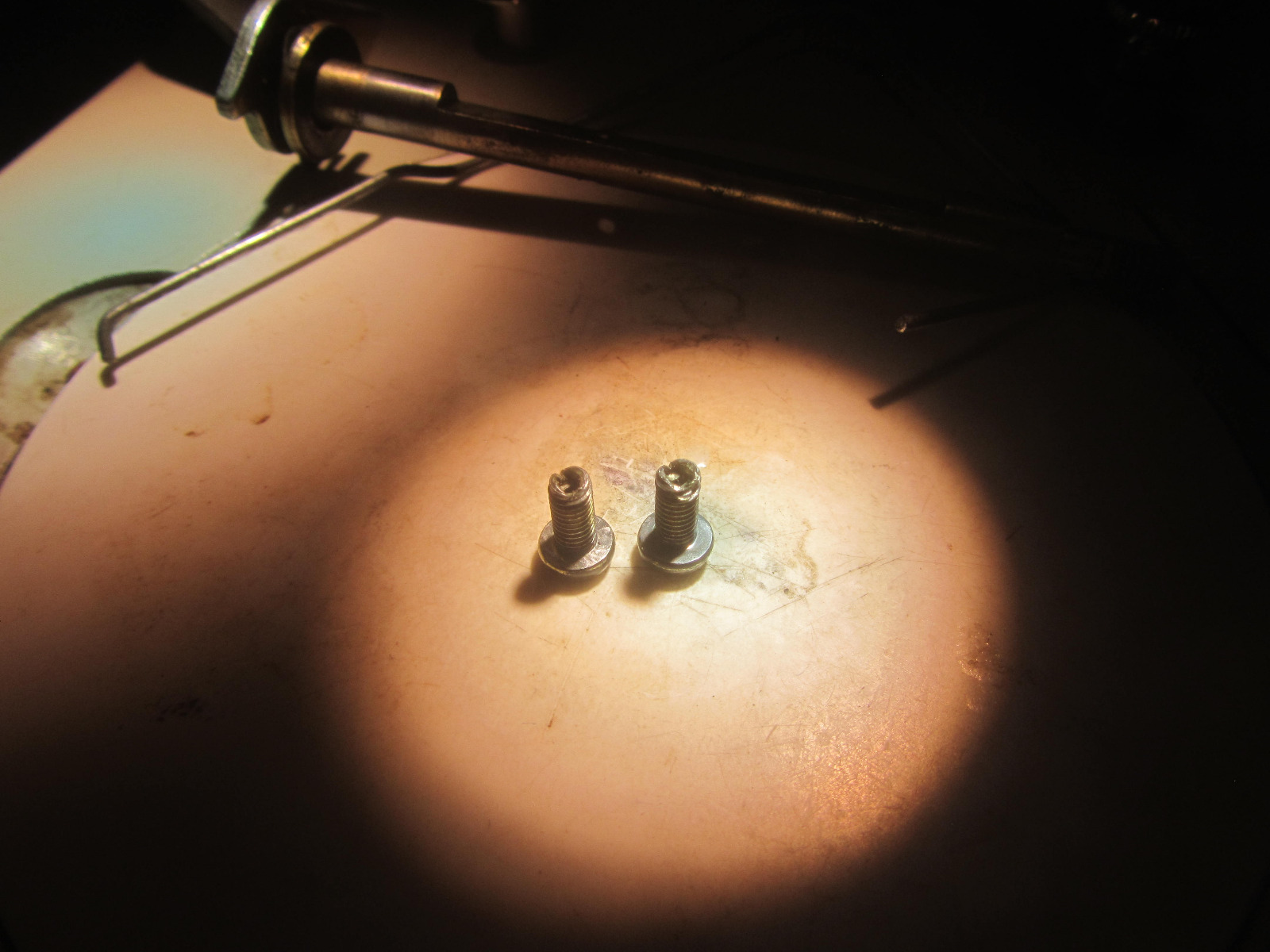

Well there had to be a catch. When I went to reattach the choke plate I find that the tiny machine screws self-destructed when I took them out. They seem to be a special screw with a spreader or something inside the hollow tips, designed to stay in the choke plate and out of engines. If you zoom in you should see what I mean
Any ideas from the experts, other than finding new screws with lock washers?? These won't even thread in anymore and I'm not much of a machinist. Its possible I could deburr them but new ones sounds like a better idea.

I was able to get the screws back in, but it took some effort as the ends were buggered up like yours. If they woun't go in, new screws with red Loc-Tite should work.

Thanks for the inspiration to give it another go. I had to file off a couple threads on one but got em both back in.. I think its still plenty long. Now where's my Loctite...
