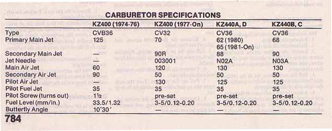

It sounds like you have found a good location for the screw setting. If you have access to a color tune or like tool you can check and see if your setting is correct.
Not sure this will of any help but I attached a table I pulled down from the kz400 site. You will not that the setting is noted as pre-set, meaning they did not want you to alter it
