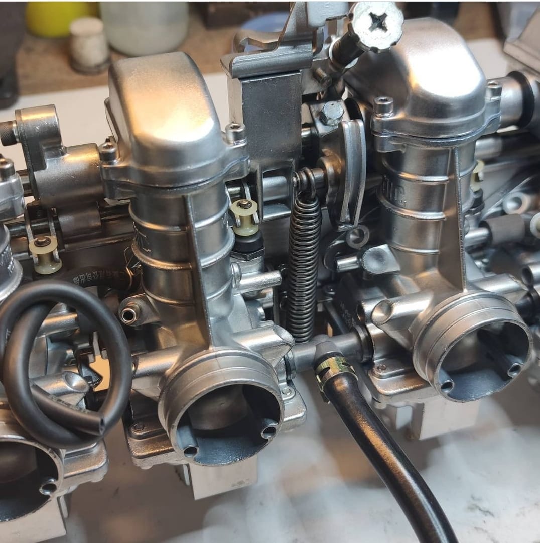

hello everyone, my bike fit vm24...i really dont know what part doesn't work properly cause i replaced almost everything .i took the bike to a mechanic but , he changed again some part , the last one were the pipe bleed (impossible to find,impossible to find but in the end i succeeded even if used).Anyway,the bike doesn't run properly.
For this reason i wanted changed for something easier to find .
i tried to find on ebay as you suggested me , but i don't find nothing.
My carbs are in attachments.thanks everyone...

My carbs are vm24ss, i tried to fix i replaced almost all part.The last part i replaced were the blide pipe (p/n 49122-1006 Impossible to find but in the end i found it, of course used).
I took the bike to a mechanic ,for the tuning of carbs but i told me the carbs got some little problem cause all the parts are not the original one and something else.At low rpm i got a loose of power , when the rpm increase looks better. Also when the engine it's cold turn on it's very difficult, need a lot of time and battery.He suggested me to find something new or different that can fit on kz650, also cause for the vm24 its difficult to find the spare parts..tried on ebay and all around the web,but i didn't find anything.I just found something for pitbike(vm24).
Anyway, here attacched a picture of m carbs.
thnk everybody
thnk everybody

Those carbs look beautiful. What sort of problems is the bike experiencing? Maybe the problems are not carb related? Have you checked the valve clearances, and is there good solid spark on each cylinder.
If you are in the USA, I'd say send the carbs to me, and I'll tell you what's going on with them. I suspect you are not stateside, though.

If you have replaced the internal brass with anything other than original Mikuni or Keyster parts you should remove it and re install the originals.
Unless physically damaged the original brass should be retained and the only parts these carbs usually need are 'o' rings, gaskets, choke plunger seals, float valves and sometimes the fuel mixture screws if the tips are broken.
I've rebuilt hundred of these carbs and have had no problem getting them all to function correctly once thoroughly cleaned out .
These VM carbs are some of the simplest and most reliable you can get and swapping them out for something else shouldn't be needed.
