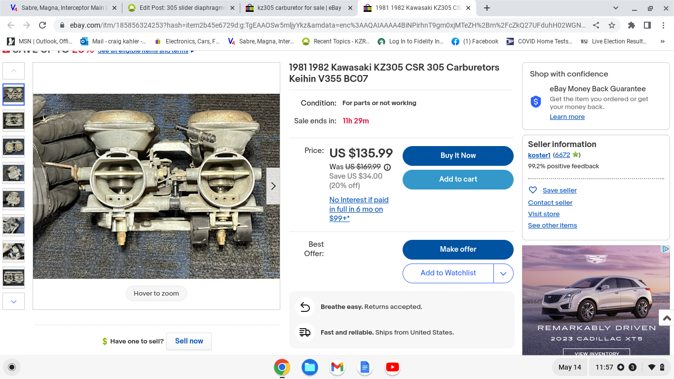

yeah used carbs or sliders are an option, just not a great one. I'd almost certainly still have to replace the rubber and then I'm back to where this all started. Then I'd have no choice but buy the other kind of replacement rubber that one seller said "it is not difficult but quite tricky so you should have some technical skills and experience with that type of repairements" ... which I do not have. I've watched their installation tutorial and feel confident I can ruin them, and they cost 50% moe than the kind I bought before.

My kz305 tops out at about 83 mph. If your only getting 45 mph that could indicate leaking diaphragms not lifting the slides, or not lifting them as far as they should.
Imagne if the carbs were cable operated and kinked cables were only allowing you to lift the slides 1/4 of the way up, A top speed of 45 mph would be reasonable.
Idling well, but lack of power as RPMs increase is a sympson of leaking diaphragms, but ignition timing not advancing would also cause that.
I don't know of a way to 100% verify CV slide operation on a running bike. Maybe removing the carb intake boot and using a bore scope to look into the carb, but lack of intake air resistance may affect slide movement.
