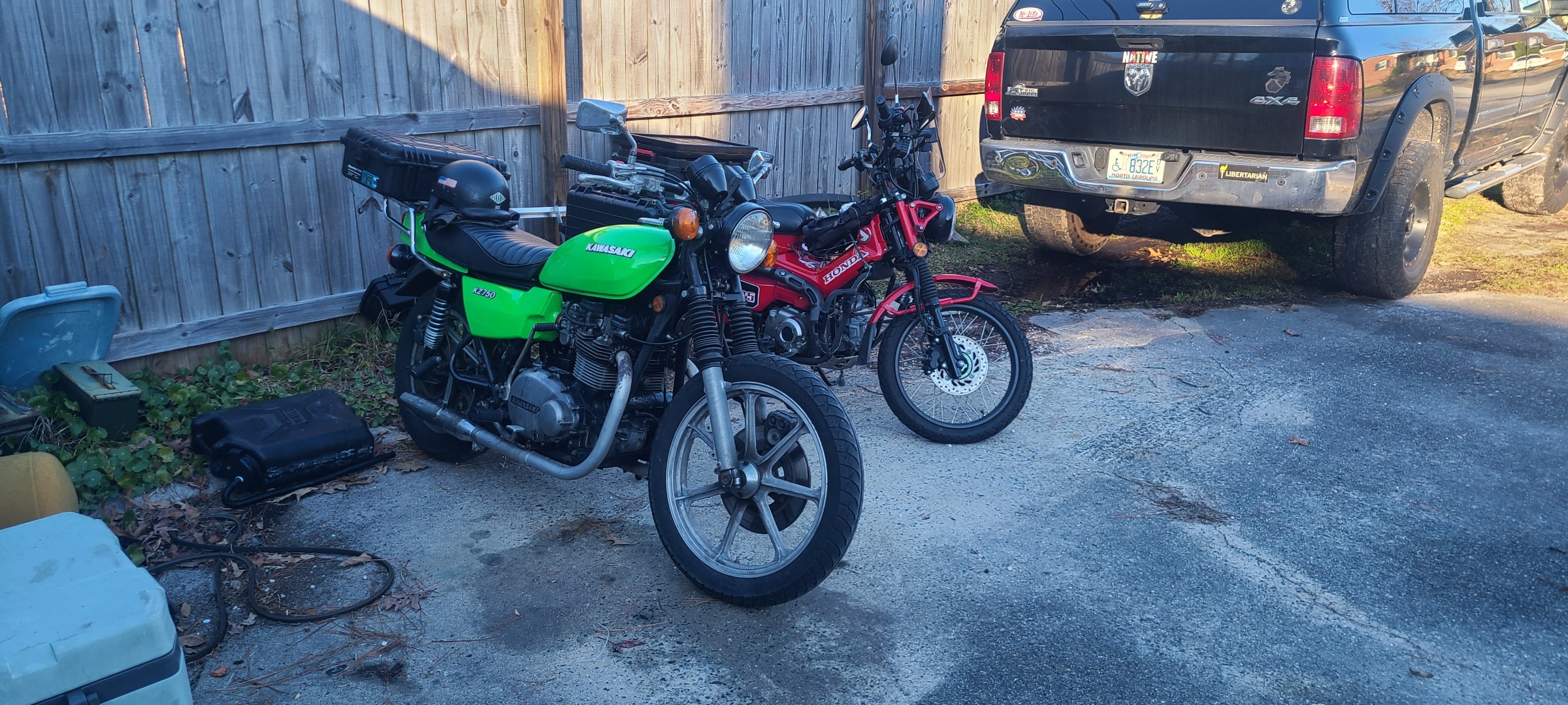

Holy cow the adventures of my seventy seven continue......
So this morning on my way to work. It was running like absolute garbage I assumed because it was rather damp out. I got to a light before. I turned to go to work and I go to take off. The bike spins out and I almost lose control. A unintentional burnout is not fun to me. I did not drop it. I did recover and I was happy but I smelled fuel. Do keep in mind that it was four thirty in the morning and it was still very dark. I broke out my flashlight. And I looked in horror as the cooperator was leaking fuel at an alarming rate. I nursed the machine back to the house where I grabbed my honda and then rode to work and got to work on time thankfully.
When I got home from work I turned to figuring out just exactly what this machine's major malfunction was. Ultimately I pulled the bowl. There was a little bit of Stuff inside but nothing to write home about. I I gave it an aggressive bath of high pressure carb cleaner. I then took the Floats out. Gave it a shake and could hear some liquid. I went inside and dunked it and held it and in my horror, Watched bubbles....
These were brand new remaining factured carbs.
So I had my old carbs and I sourced the floats from one of them, Gave it the bubble test and it passed. So I reassembled everything. And then rode it about thirty miles to the next town for a doctor's appointment.
It drove fine no problems no drama.
So now, since this thread is continuing. Does anybody have a line on plastic floats that I can put in this thing so that I don't have to fight these stupid little brass bastards anymore?
