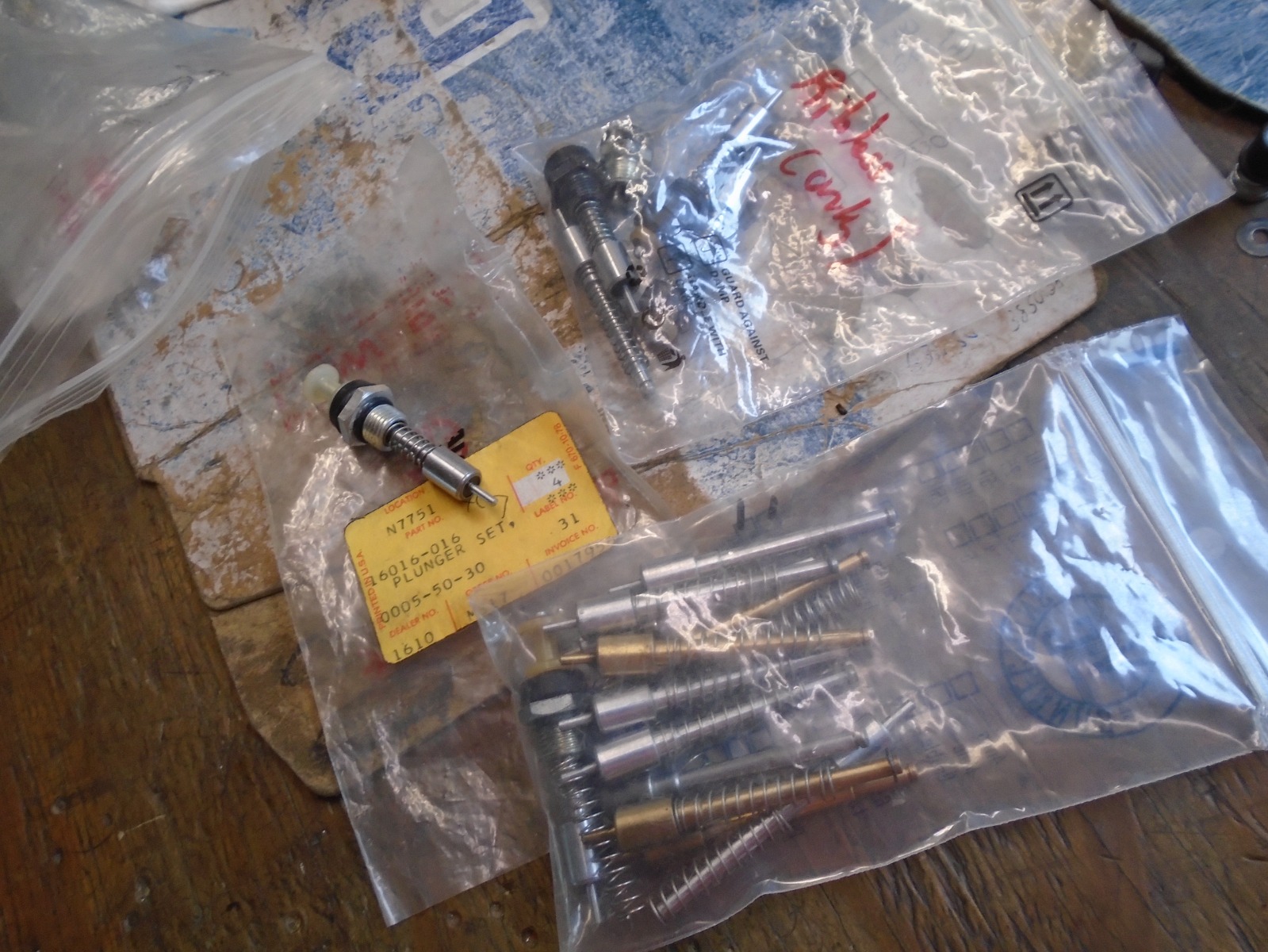

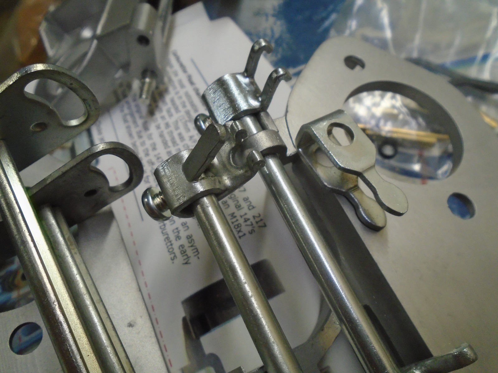

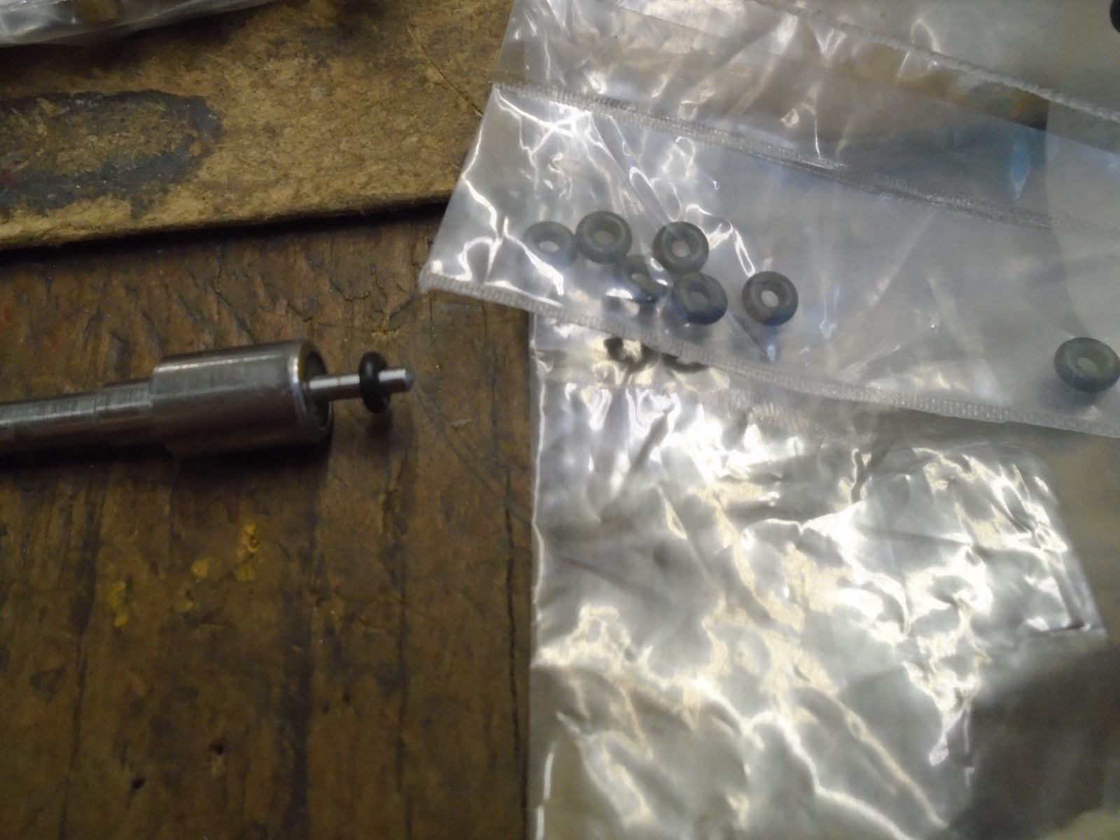

Actually..the choke plungers will interchange on the Z1B. The 1975 and late 1974 using the single wound return spring had the same dimensional type choke plunger except it was chrome plated. The 73 thru early 1974 were indeed different but you shouldn't have those. Note the first photo and different styles of lifters used thru the SC and SS VM series, organized early to late from left to right. Yours should be the one in the middle attached to rod. Next photo is original chrome plated NOS and correct for yours. Last is "probably" where you got that o-ring concept from and is what i included in some past threads i'd attended here. Have been doing this for years and it's just a cheap way to "renew" the choke plunger original plunger seat. It's just a 1.5CS X 1.5ID X 4.5OD O-Ring i superglue to the original pad after cleaning it up. Costs less then a stick of gum ha. Just want to seal off the choke petrol access when high vacuum is created at idle, this does it.
