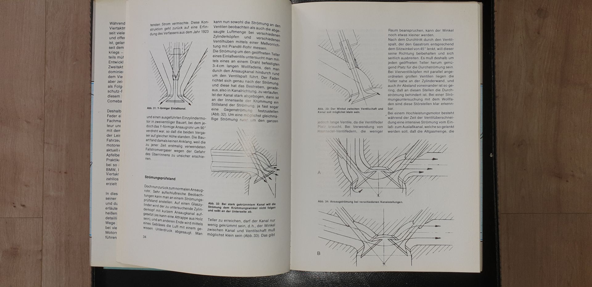

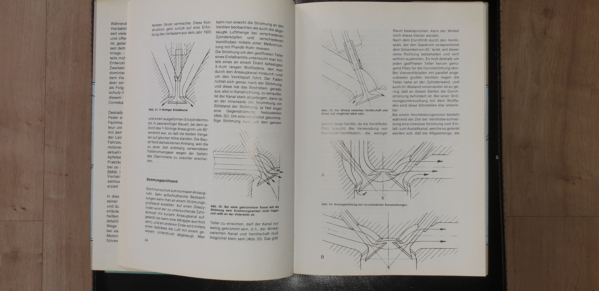

A miss firing/no igniting cyl. (too lean, less compressing) create a low vaccum reading.
A good ignited cyl. (expanding burnd gas) creates an extra vaccum flow in the EX/IN over lap stroke to suck more fresh air/fuel mix.
