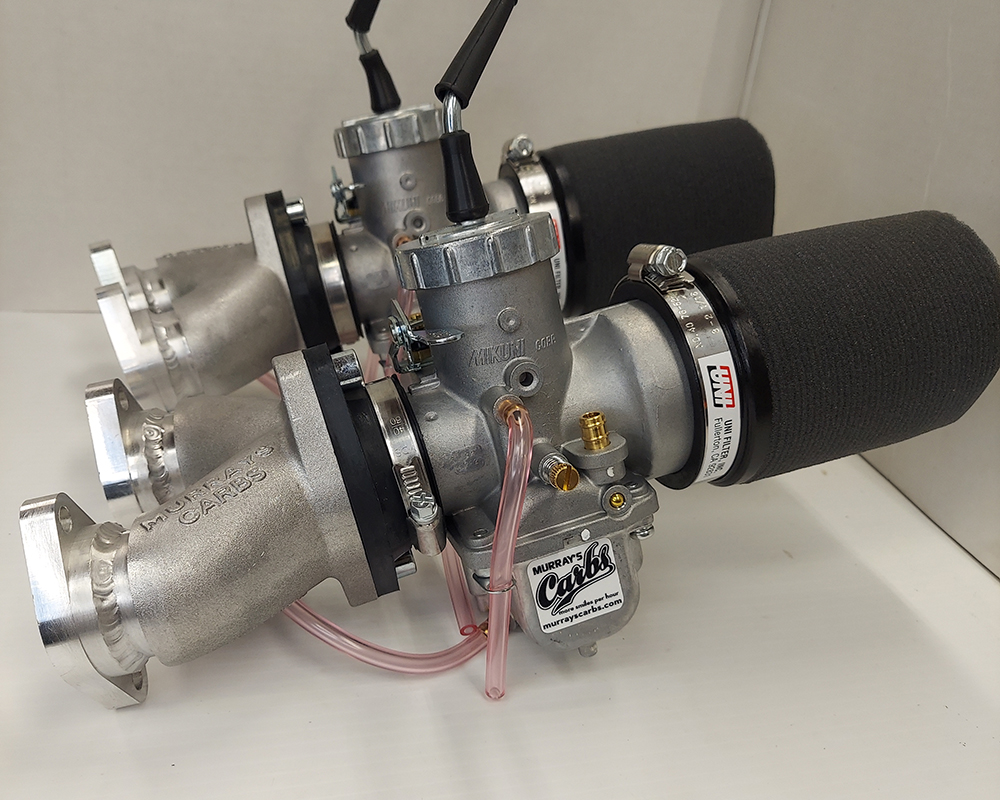

Good for bottom end and midrange but restrictive on top end.
If two carbs were sufficient for maximum performance Kawasaki would have saved a bunch fitting just two instead of the four that are stock.

There is a reason why every tuner since the 60's has been fitting one Venturi per cylinder with equal length intakes
