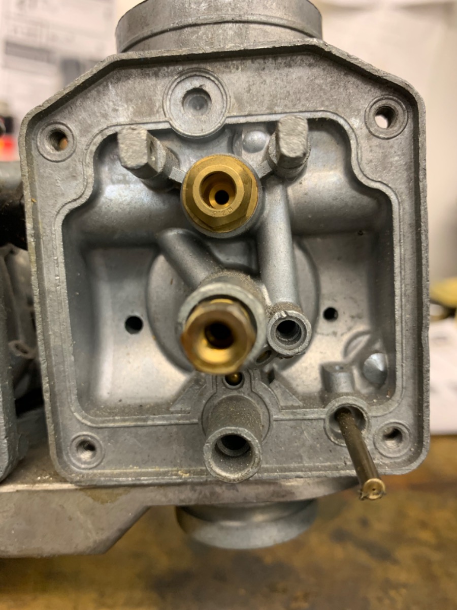

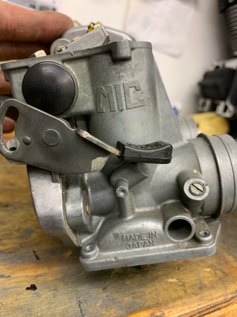

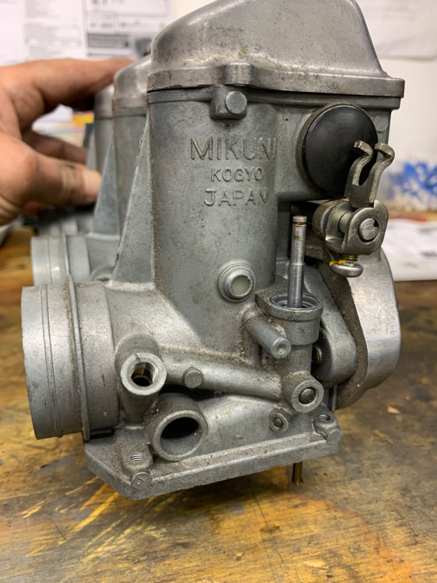

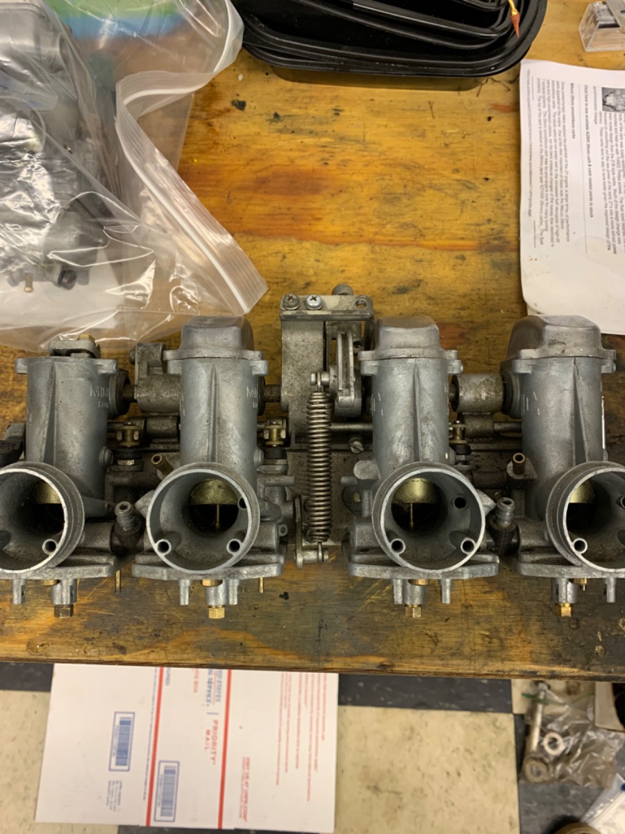

These carbs were extra set that came with bike purchase years ago, can someone identify what they are?

VM26SS.

VM26SS used on the 1976 Kz900 and LTD 900, 1977 Kz900 and I think the 1977 kz1000?

Currently have Z1B carbs on KZ900 which carb is preferred? Going to run pods and Denco 4-1.

#883246
