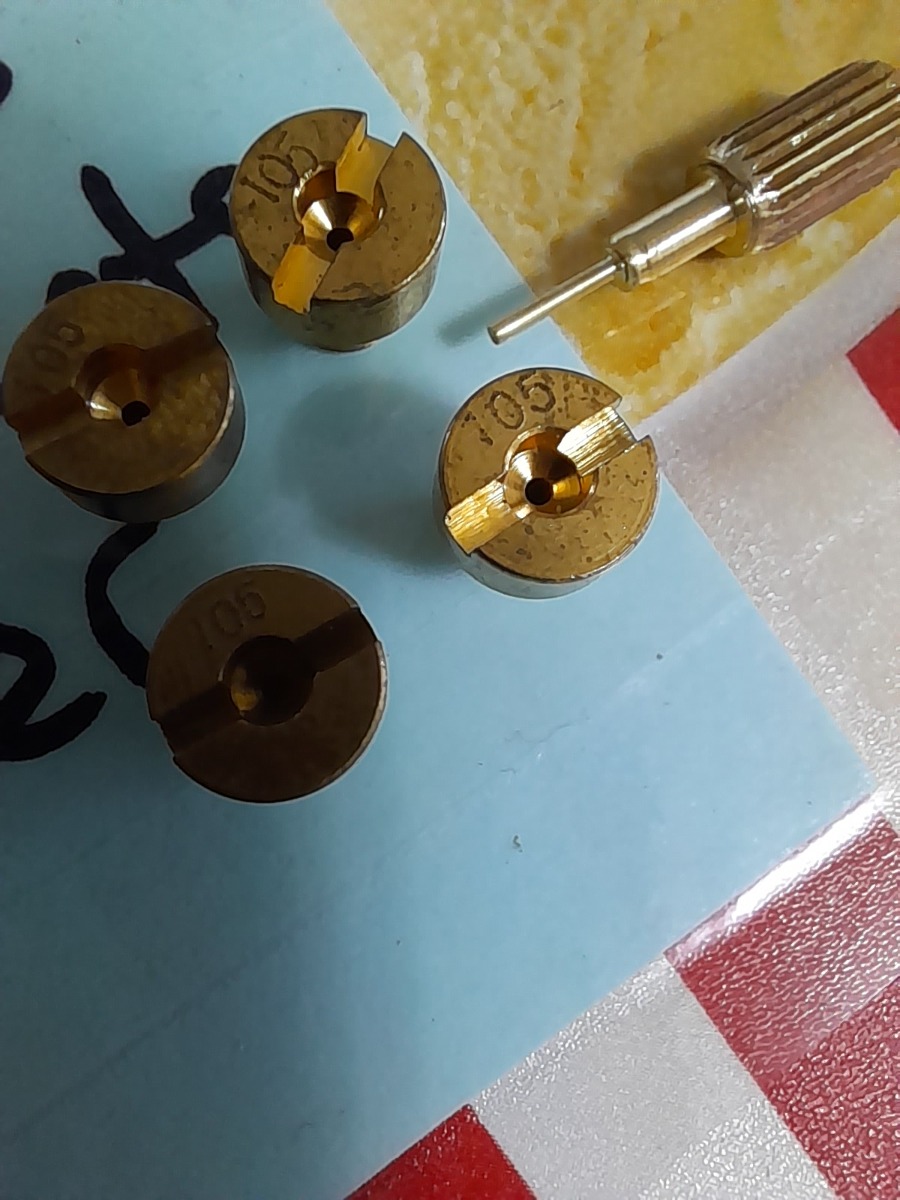

Can't measure flow rate, I have a set of 105's of dubious origin and needed to know the bore size of the real jets, probably end up buying from Allen's.

Mikuni jets are sized in milimeters and fractions of.
So a 105 is 1 .05mm etc .

Seems the jets of dubious origin are spot 105's,  I made a measuring tool, only  another 4 different sizes to make now.
