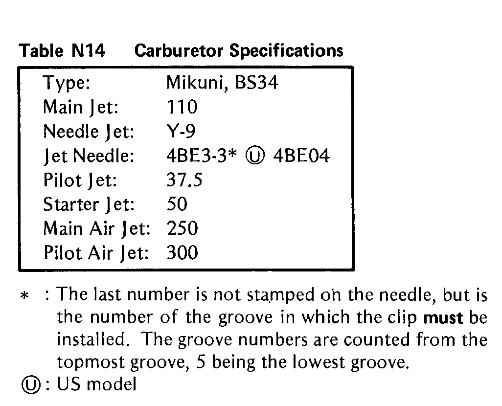

Not sure if this will be of help or not, but here is a table from an FSM for 82 GPz 750 that shows internals for the carb.
the Y9 needle jet would, as I understand it, have and inside diam of 3.145 mm
