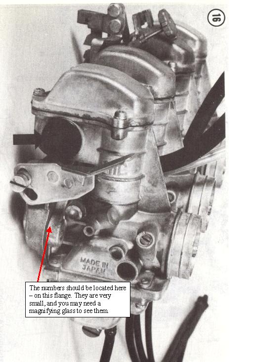

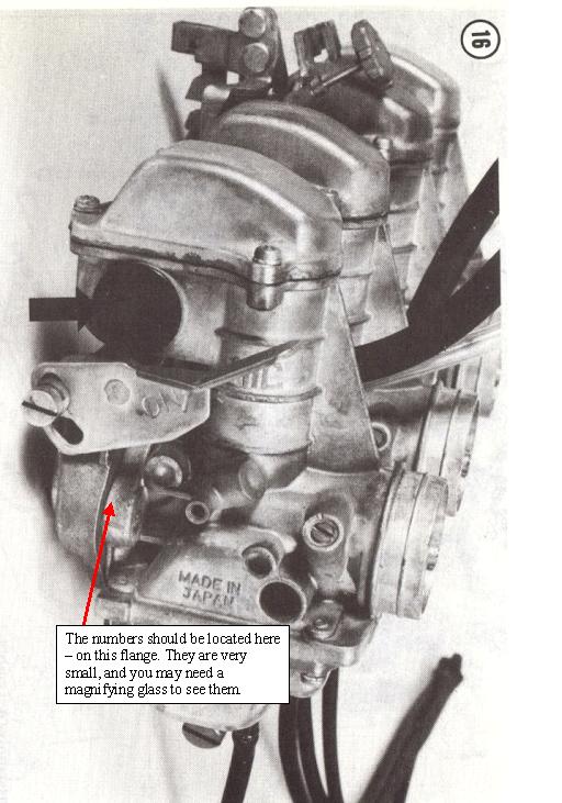

There should be an ID stamped on the carb set. It is most often on the flange below the choke lever, though may be on the same flange on the outside of carb #4. (carbs are as you sit on the bike from left to right 1,2,3,4) I have attached a pic, a set of vm24ss carbs that show this location,
With this ID we may be able to tell you more about what model they came stock on and what internals they had.
