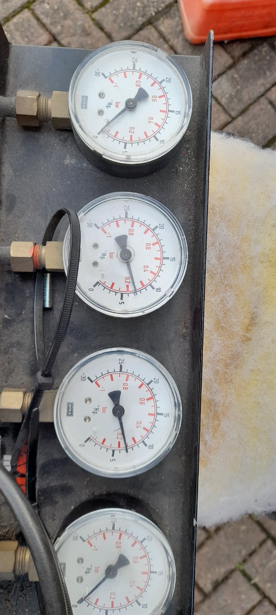

Hi guys, I know this subject has been discussed a good few times, my newly rebuilt engine will not idle correctly, the revs will not drop below 1800 - 2000 rpm, unless I screw the throtlle down hard. I have put the vacuum gauges on and the left is drawing alot more than the right cylinder, carbs have been rebuilt, all old jets cleaned and reused, I have even swapped over the diaphrams just to see, all the same, had the genuine new boots off and sealed on, its sounds like drawing air, but cant find where from, any ideas.

The vacum is highest against a closed throttle so the side with the lower readings is where your problem lies (air leak/carb issue) have you checked valve clearances and compression (vacum is created my the mechanical " suck" from the piston down stroke)

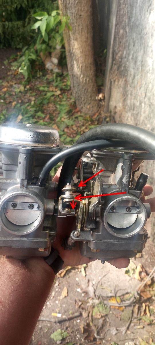

Never ever seen a bend flaps/butterflys on carbs. Are you sure your carb sync adjuster screw or unit is installed correctly.
Some pics of the carbs/sync adjuster would help. Have seen a lot of mis-installed sync adjuster after a re-build.

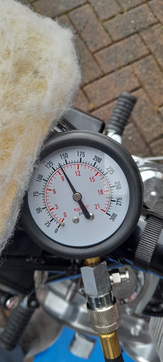

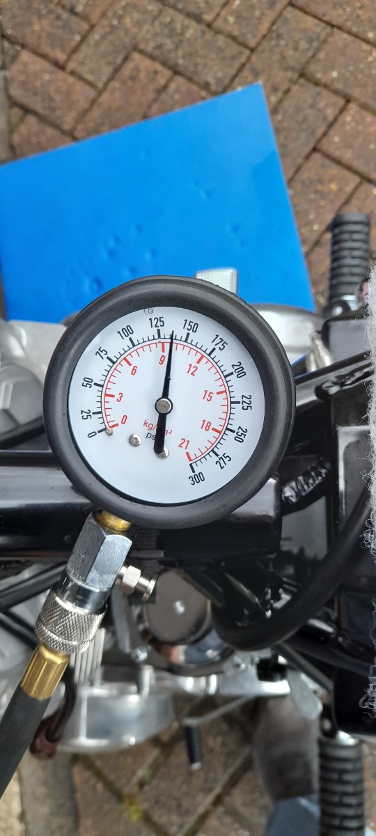

18 Mar 2023 03:27The vacum is highest against a closed throttle so the side with the lower readings is where your problem lies (air leak/carb issue) have you checked valve clearances and compression (vacum is created my the mechanical " suck" from the piston down stroke)
Yes compression great on both sides, I agree issue is with right hand carb. Will double check valves before I remove the carbs.

Right guys, checked out compressions again, all good, checked valves all good.

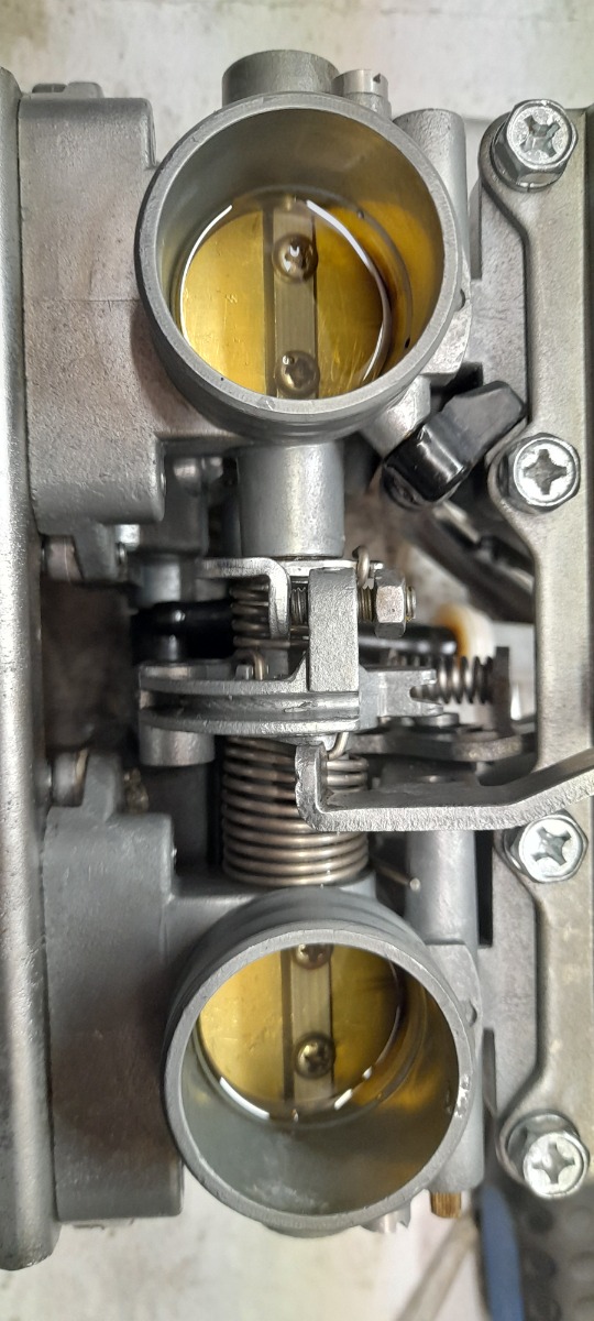

Removed carbs again..... Removed choke discs, emery around edges, lightly, refit screwed lightly, open and closed couple times to centre up, lock tight and screwed up tight, filled with oil to check tightness
Refit carbs, checked cables. Started up and tweaked the balance
success
success

Compression and vaccum sync values are perfect, don´t forget to tight and secure the sync adjuster screw and nut with a drop of screw locking paint.
