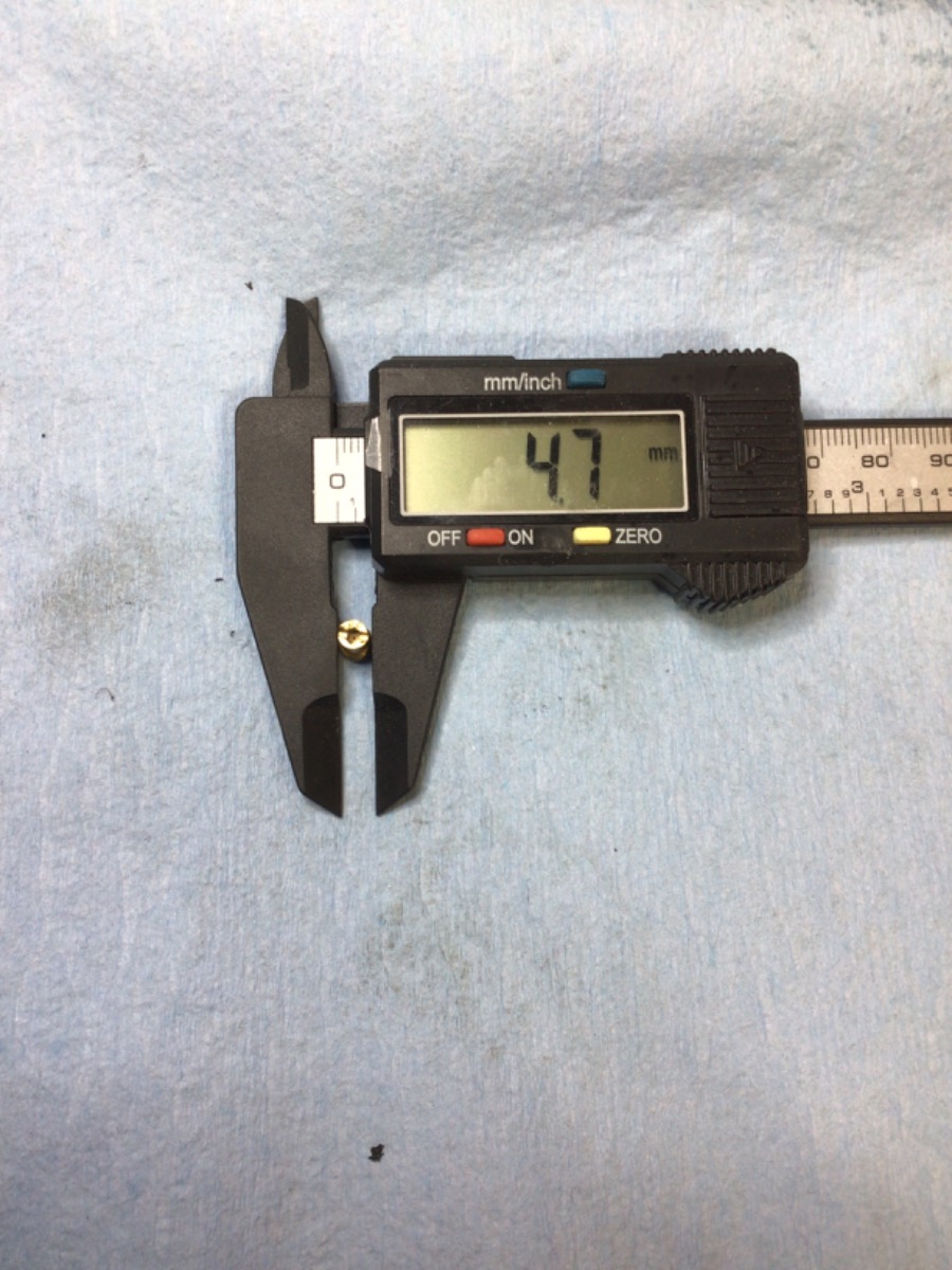

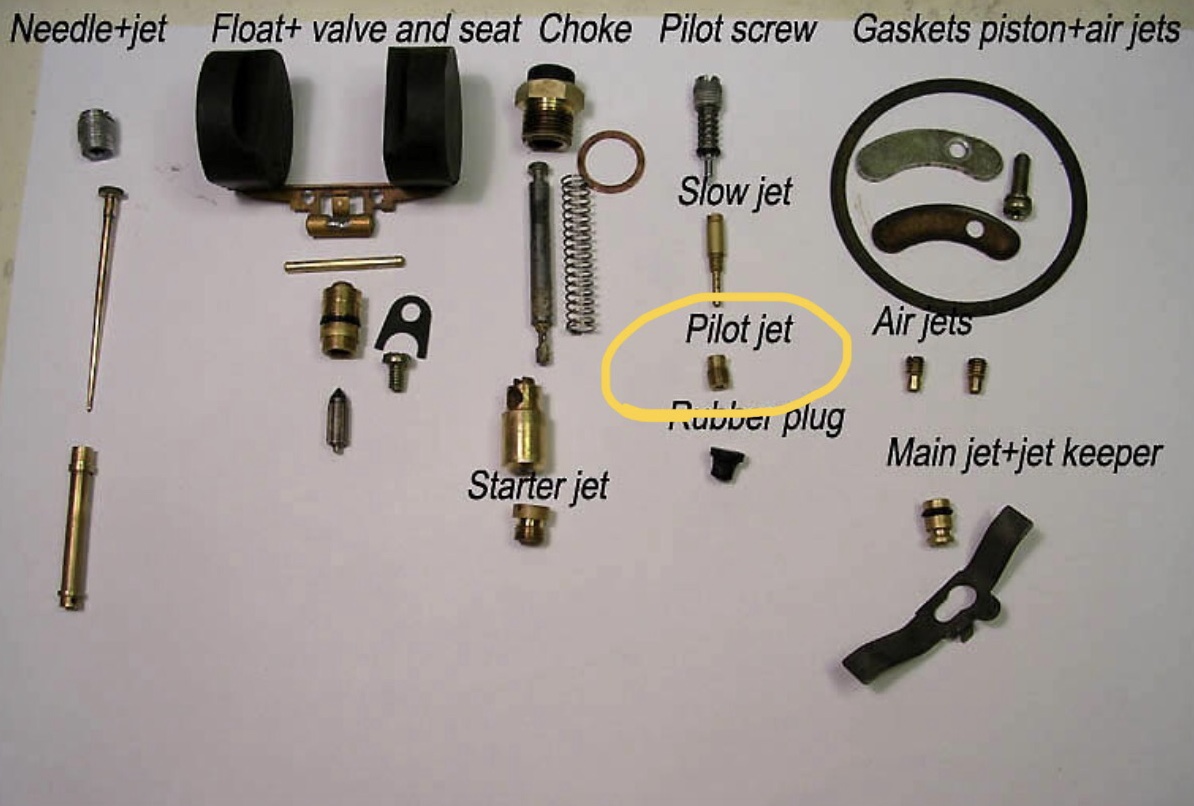

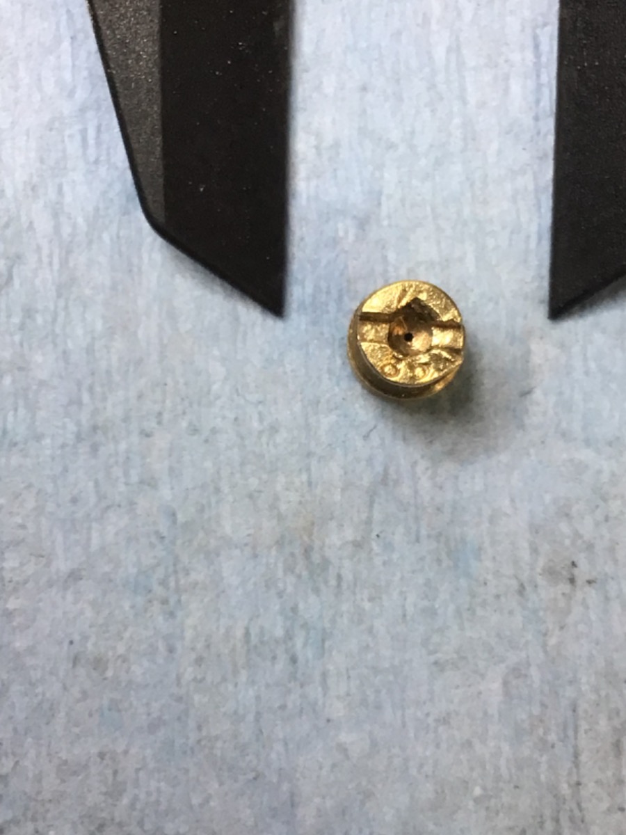

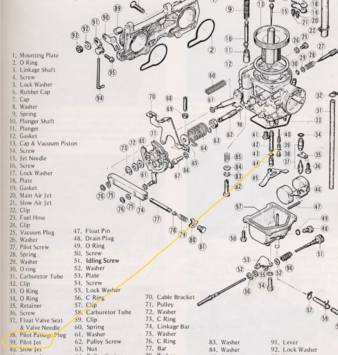

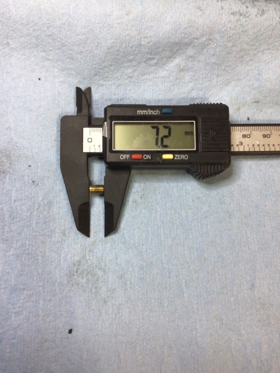

Hello everyone. I am on the hunt for 1 of these size 35 pilot jets-see pics below. Wondering if anyone has one kicking around? I had to drill it out to get to the slow jet in order to clean it out…ugh…

Ok thanks, I have searched Jetsrus before but I will email them to ask. I emailed the place overseas as well. Neither company lists that size but you never know unless you ask. I would hate to have to by another carb just to get a single jet.

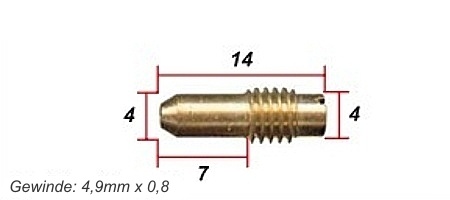

Keyster pilot jet part# KYS-15A035, looks similar to the size and dimension you need.
You only have to shorten the shaft. Buy 3 jets = 10,50 € if something went wrong
www.motorradbay.de/en/35/p-5347.html

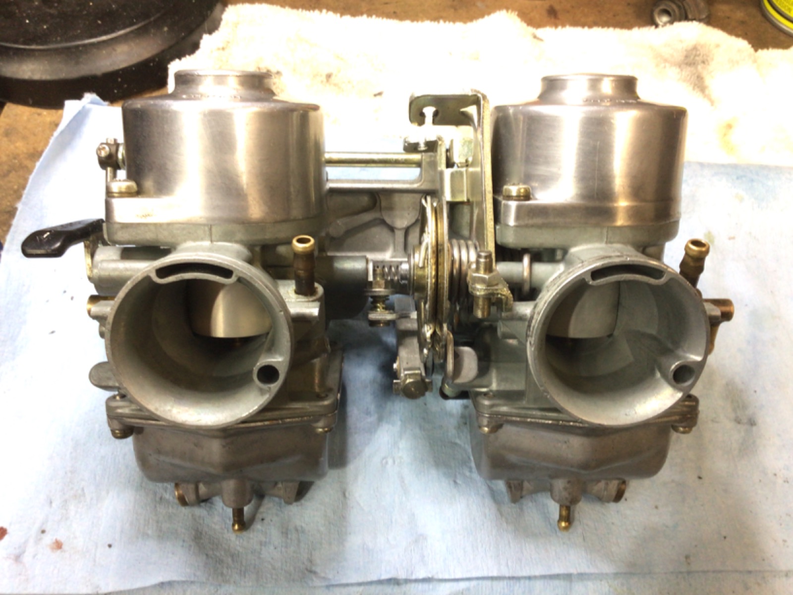

thanks again for finding this item on eBay, the jets were new and the carbs are working better. Still not at 100% yet, but better. Sync‘d them and it sounds pretty good. A little cold to be doing a test run this morning, but will see how warm it gets later today. if I unplug the rh spark plug wire the bike will still limp on the lh cylinder, but if I unplug the lh plug wire the bike dies immediately. It’s like the rh cylinder is not producing power at idle, but the bike sounds like both are running, timing light shows they both are getting spark. Compression is slightly lower in that side, valve adjustments are good. throttle response seems good, no stutter at a quick turn either. If I do rev it up to 5k or more I am seeing black smoke out of the exhaust. I have a 2 into 1 exhaust on this bike. Jetting on the carbs are all stock values, I may need to reduce the secondary main which is at 125 or increase the main air jet size, currently at 90. Will first read the plugs out once I can ride it and get a good test in.

My son took it out today, every time he got on the throttle it blew black smoke out of the pipe. Then it would bog down once it hit 7000 rpm with more black smoke. Seems like too much fuel all around. Next step was to remove the stock filter and left the air box door off. There was definitely less black smoke but it still bogged down over 7k. Everything is stock except for the 2 into 1 exhaust pipe. The compression is good in both cylinders. He noticed the idle kept changing at each stop, some too low and it would stall then too high after he turned it up a very small amount.
