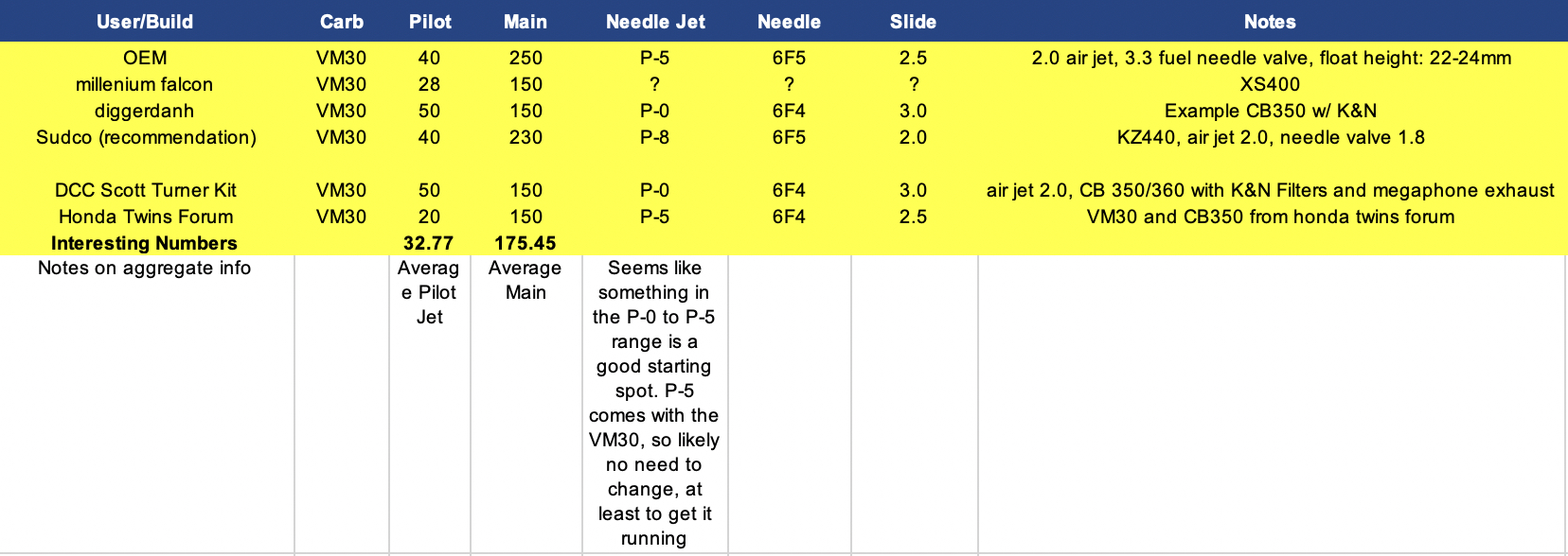

28s would probably give you the best mileage but I haven't looked at prices or availability or anything.
30s would be the easiest conversion, as you've seen.
32s are too big for a stock KZ440. From what I've read, you would need a cam and head work for 32s to make sense on a 440 (and possibly not even then).
I'm going with velocity stacks (with light filtration) and short gearing and expect to be winding it up most of the time, so I went a little richer on the mains.
Here is a screenshot of a spreadsheet I did 6 years or so ago:
