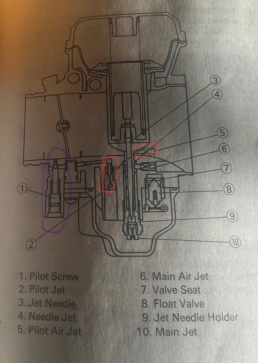

On the diagram below, I made sure the pilot jets (#2) were clear, and when I squirted carb cleaner in the orifices it came out of the pilot air jets (#5). Does the pilot screw (#1) affect anything other than idle? That's the one part of the carbs I didn't touch.

The pilot circuit should have been cleaned. If they are blocked, the engine can be made to idle ok by raising the slides a tiny bit with the idle adjustment screw. However, when the throttle is opened farther, the mixture will go very lean because main circuit is set up on the assumption that fuel is coming through the pilot jet. The pilot jet never stops flowing fuel, but it becomes less influential because it provides an ever smaller percentage of the fuel as more flows through the main.
With all of that, I am not sure clogged pilots by themselves would cause the engine to die, but in combination with another problem might do so.
