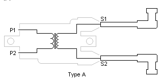

20 Jan 2023 16:52 - 20 Jan 2023 17:21Seriously? Don't the coils need to be grounded via their mounting posts?...FYI there is no electrical connection between the coil and the bracket or the frame ( only "heat transfer")

20 Jan 2023 17:43Thinking at Nessism comment, I told myself "why not invert the coils's wires. Naah, it won't work as the right colors are on the right coils". Having nothing to loose, I did so. And the engine started RIGHT AWAY!! What a relief. I don't know why I had to invert the wires but I'm so glad that I don't really care by now.
Once again, thanks a lot for every comment!! I really appreciate!
If the coil wire colors are correct, that means the rotor is on 180 degrees off. It's easy to do.

21 Jan 2023 00:43 - 21 Jan 2023 00:51No, the primary winding grounds through the points/igniter module (switching the ground is what makes the spark) the secondary winding grounds through the spark plugs to the engine on a dual output coil or shares the ground via the points/igniter on a single out coil. The mounting tower simply dissipates the heat generated to stop the coil burning outSeriously? Don't the coils need to be grounded via their mounting posts?...FYI there is no electrical connection between the coil and the bracket or the frame ( only "heat transfer")

He said his green wire is on 1/4
My 82 1100 shows black to 1/4 and green to 2/3
Unsure if they differ on yours
