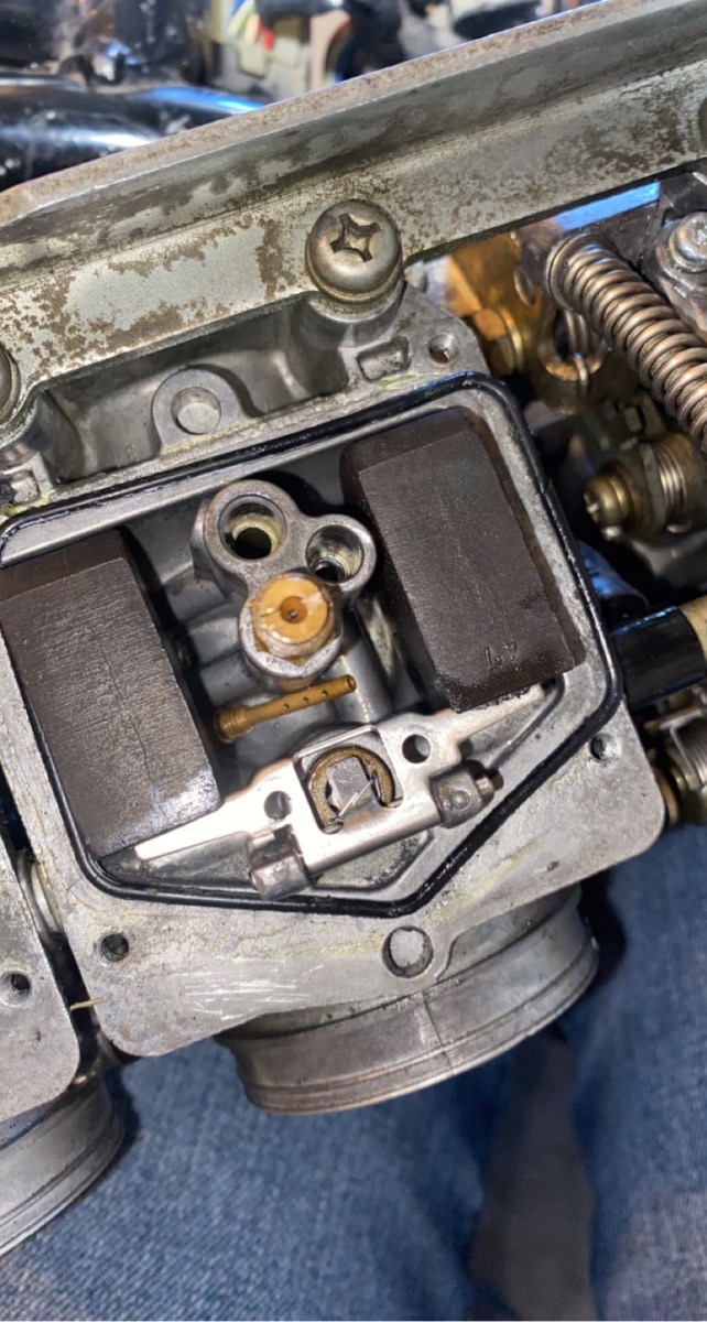

I’m entirely new to motorcycles and carburetors. I bought an 83 KZ750 spectre and have had plans on restoring it. When I opened the float bowls I noticed that the primary jet and pilot plug are missing.
Is it just the primary jet missing or am I also missing the main nozzle?
What are DIY or other replacements for the missing plugs?

It looks like both the main jet and Nozzle are missing. The Nozzle for your bike is a different PN compared to the Nozzle for the E and early H bikes, and either way, they are not easy to find sometimes (look on eBay.)

The 1983 KZ750F carbs are simplified compared to other CV34's. They don't use the nozzles, a primary main jet, or pilot plug. I wonder if you have a set of those? Are the nozzle passages drilled all the way though to the throat of the carb? Also, Spectre carbs are painted black, and these appear to be unpainted. You quite likely have KZ750F carbs.

Any markings on the outside of the carbs to indicate just what they are? Not sure but think some 750 4s, not twins, came with Mkuni and some Keihin carbs, I was not aware of the set of carbs pointed out by Nessism that appear to be more like the Mikuni BS carbs (single main jet, pilot or slow jet) than the main and secondary main used in most Keihin carbs.
Another question, in the first pic you posted there is a brass fitting in the bottom of the carb what is it, a pilot jet?

The carbs are Keihins, there are markings on them saying so. I think I may have just misidentified the bike I bought. The listing had it labeled as an '82 KZ750 LTD, but when I saw it was shaft driven I thought it was a spectre because that was the only example of a shaft driven KZ750 I could find online at the time. The number on the motor starts in KZ750NE, which I think I saw somewhere else as an identification of a Spectre. The bike did turn out to be an '83, which didn't help my suspicions. It probably is an '83 KZ750F LTD.
The jet in the first picture is the pilot jet. When I opened up the float bowls for the first time the pilot jets were just lying in the bowls like that. Oddly enough I had the bike running on three cylinders (badly) with three pilot jets loose in their respective bowls. I think the massive holes were able to let enough gas into the throat to balance out the cold dense air in Minnesota right now. With the pilot jets in, the bike can't currently start.
