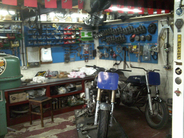

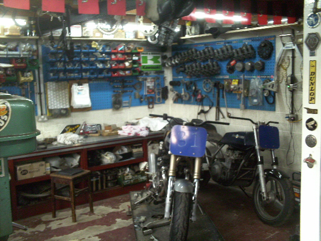

Up until about 15 -20 years ago we'd barely even seen a set of vm pumpers until the resurgence in popularity of these bikes boosted the US to UK import market to cater for the spares demand.
I've quite a few sets of both Kawa and Suzuki VM's waiting for attention when i get the time .
Some of which can be seen lurking on the wall in the background of this recent pic.
I favore the vm26 bodies for when i'm boring them out to 30mm ( they have a fractionally thicker casting on the boot side stub compared to 28's ) and the horrid 26mm pumpers can be made to work well once you disable the sensor diaphragm and plug the drilling.
