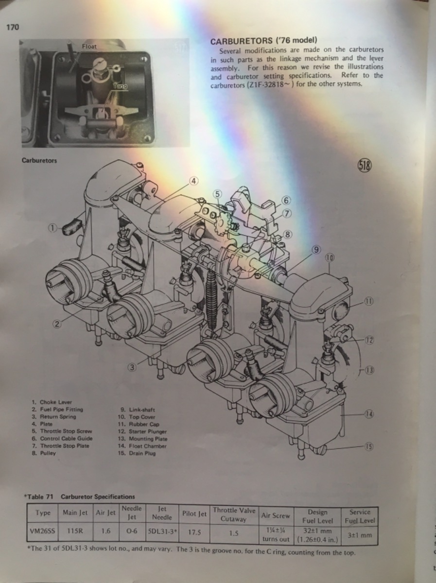

18 Nov 2022 21:11Apologies on the bad info on the pilots. You are correct. Stock was 17.5.Float height was set with clear tube method .Bike is still 900cc . No air correcttion jets . Needles do show a slight bit of wear.
My clymer manual (I know not always the best source) shows Main jet should be 115, and pilot 17.5 . I'm at 115 and 15.
As far as guides and seals , there is no oil residue at all on the plugs just dry black soot.
If the needles show signs of wear then the needle jets will be worn also. They should be O-6.

You said the Design fuel level was 22mm, but the clear tube test is good. I’m hoping the 22mm was misspoken and the clear tube test true. The two can’t exist. Have you checked battery voltage or coil resistance at the point of plug foul? You say it happens after a 40 minute ride. Coils could be heating up ad failing, or your charging system isn’t working.

Yes,
my manual says 22mm float height so thats what I set them at before putting the bowls back on to perform the clear tube method and made corrections from there.

Yes, float height is 22 mm.
