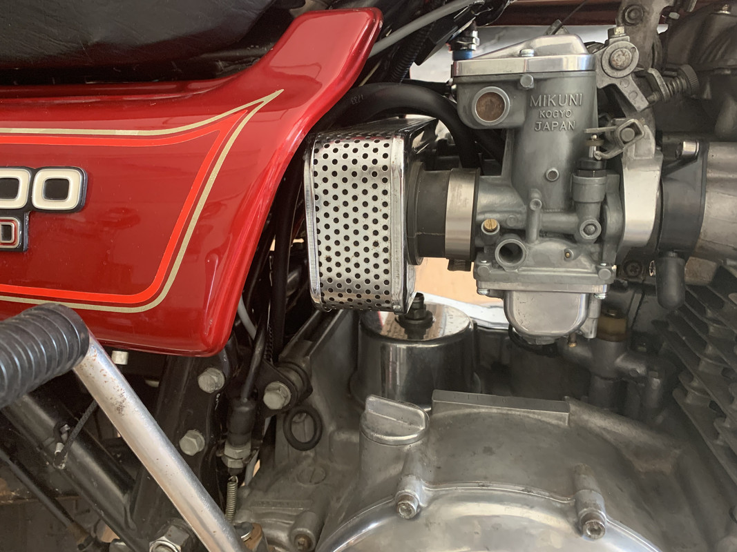

Those are VM26 carbs off a 900/1000, that box will fit these carbs only, not the stock VM24 on KZ650.
I just stumbled across that NOS air box in a bin of parts I bought at a swap meet. I just replaced the disintegrated filter foam with UNI green foam I bought from my local dealer. The rubber on the spigots was perfect and the chrome good, probably mid 1970's vintage, not sure what they go for now.

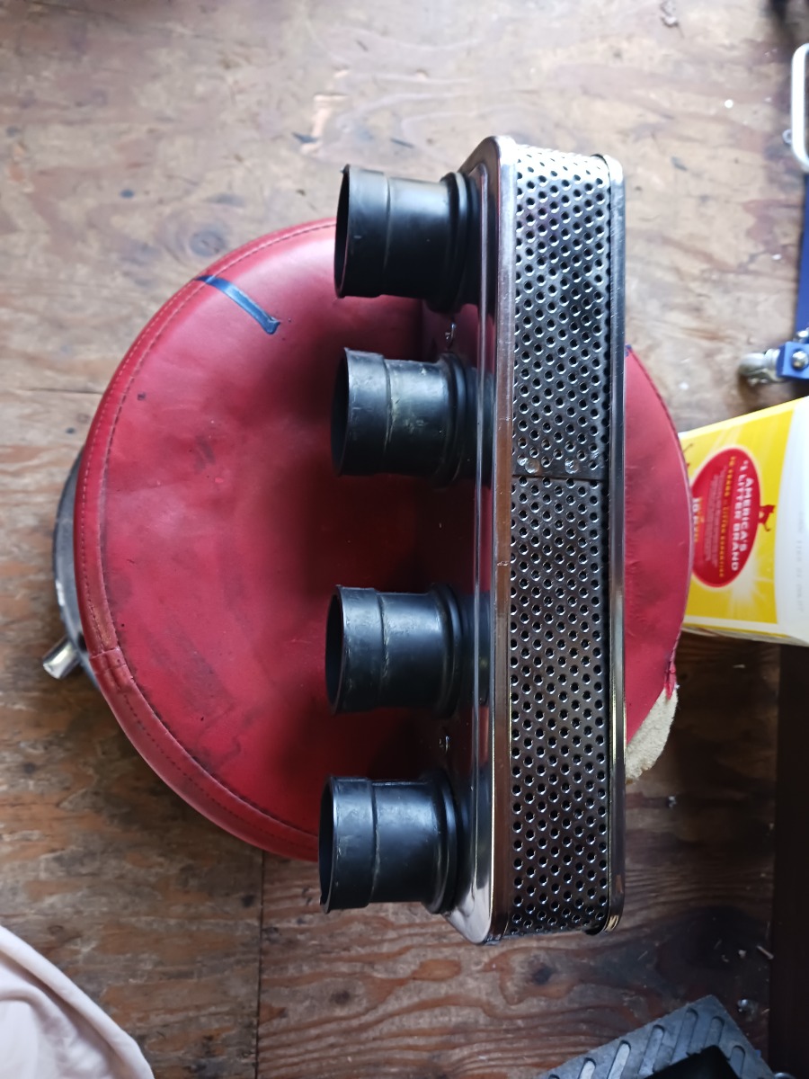

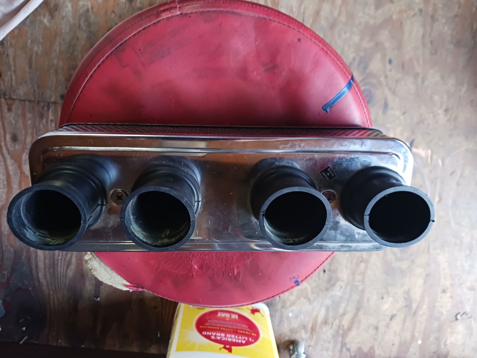

The rubber manifolds on mine are very short compared to the other example pictures posted.
