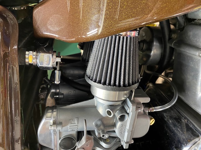

Here is a pic of a single feed Pingel petcock just installed on my 1976 KZ900. A lot of riders and restorers of these classic bikes are recommending using a high quality petcock (like a Pingel)
to replace an OE type such as yours.
