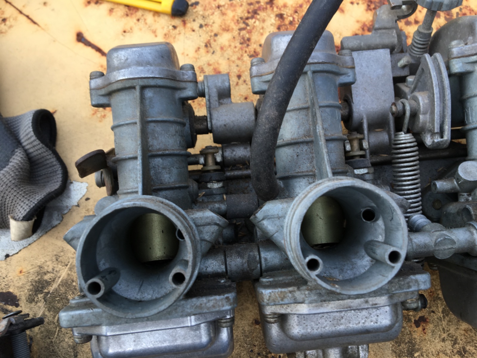

05 Oct 2022 14:44These are your carbs and the ports that you don’t want to block. I’d be tempted to back the pods off an 1/8” just as an experiment while you wait for new better pods. Then you’ll know if the pods you have are too restrictive or covering the ports or both. If it’s just the port holes maybe take an exacto and cut that part out. Then just watch that the filter material doesn’t disintegrate on you and into the engine. Which all pods will likely at some point do.
