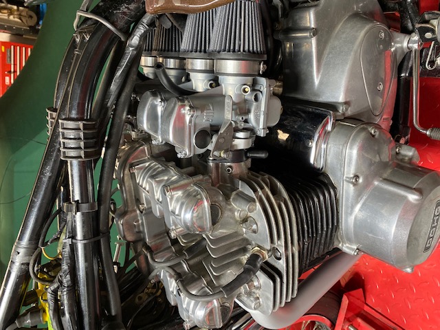

Well I got a delivery this afternoon and got them on the bike already.
thanks for the help guys, I like the quality of these so far!

Re: Air pod recommendations
06 Oct 2022 06:35
Looks good
The following user(s) said Thank You: Wheelhop
- Posts: 6961
- Thanks: 4377
06 Oct 2022 06:52
Look good, are you using any sort of support bracket to stop the "gang" bouncing on the intake rubbers ?
- Wheelhop
- Posts: 527
- Thanks: 318
06 Oct 2022 08:18I thought about making a couple support brackets out of aluminum strips I have lying around but want to get the bike fired up first (hasn't run in 30 years!) before I do much else to it.Look good, are you using any sort of support bracket to stop the "gang" bouncing on the intake rubbers ?
06 Oct 2022 10:12
If I remember correctly Daveo had a simple but effective bracket. It is on one of the inside cam cover bolts that aligns with the inner front screw of carb top chamber bolt on carb number 2.
